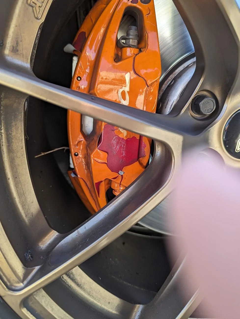

I'm looking to get my brake calipers powder coated. They are currently painted but it's not holding up to hotter track days.
I reached out to my local shop who's willing to help me disassemble/reassemble the calipers, but they need me to bring the parts. Does anyone have a complete list of parts for this? All calipers, front and rear.
