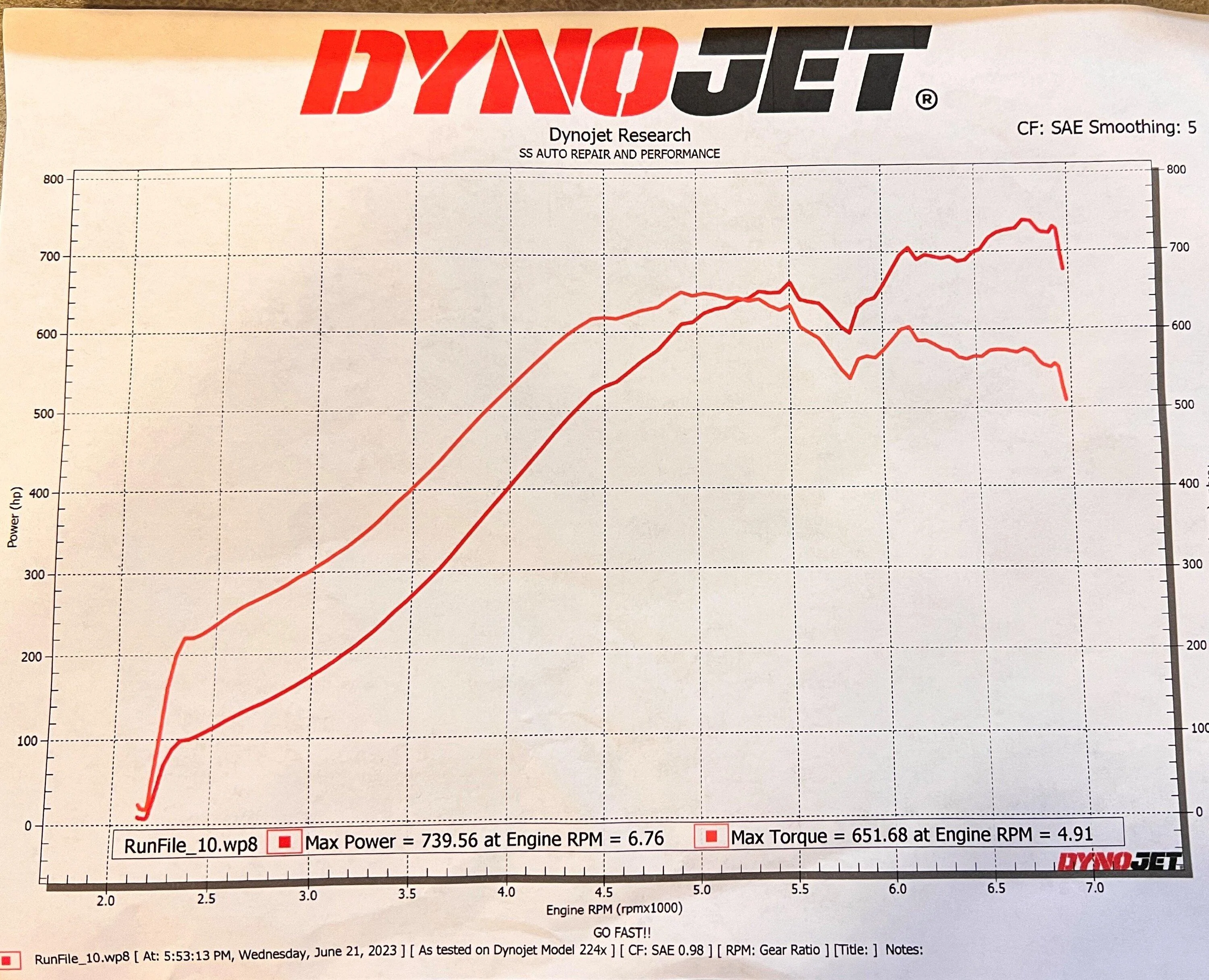

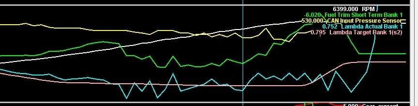

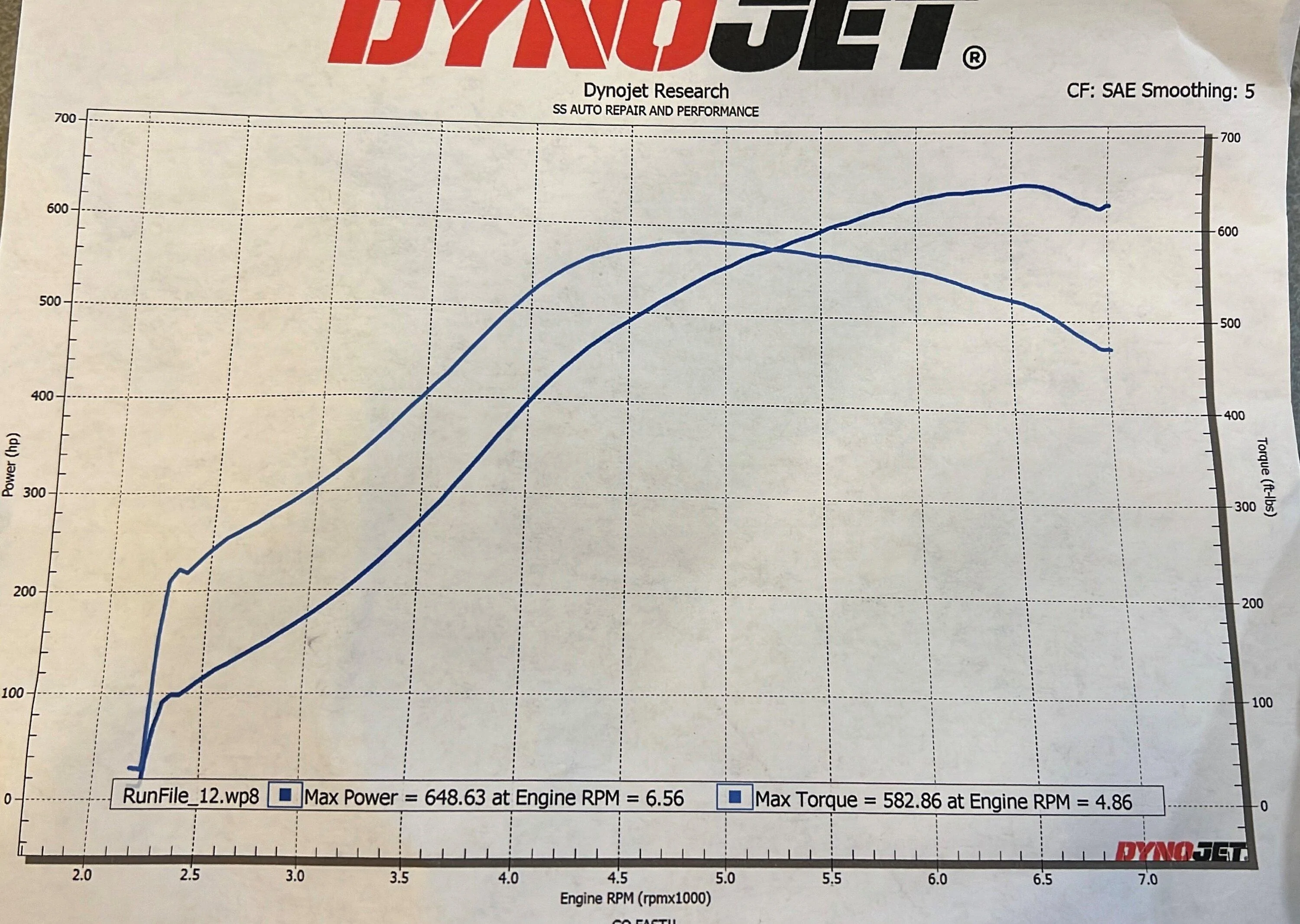

Uncertain if this PFS pump is root cause at this point, but seems like PFS pump may either be maxed out or not operating to its advertised numbers.
Did logging on the dyno last night and were getting erratic fuel pressure and oscillation with fuel trim at the top end.
My theory is possible a grounding issue since the pressure remains very constant before it suddenly drops off. Seemed anything above E60 and getting into the higher 600's low 700WHP range is where I see the issue.
Notice the erratic pattern around 5-6k RPM on the 740hp graph
Smooth and stable on lower boost/timing map when power is in 600's
