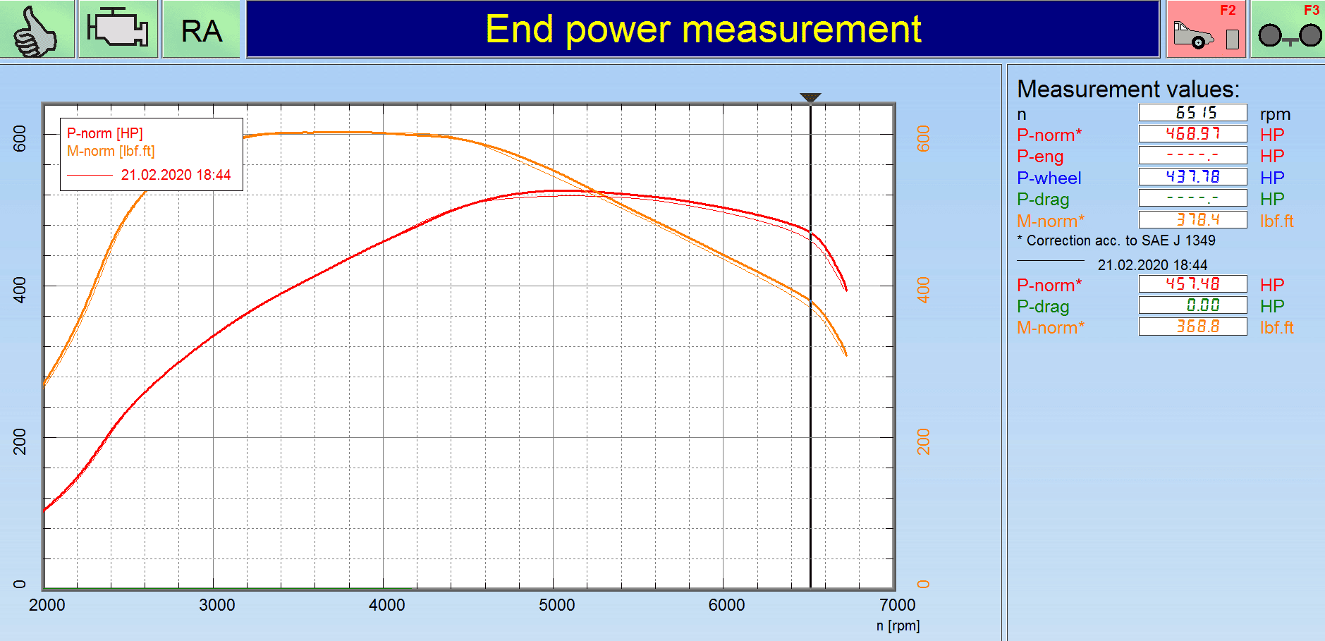

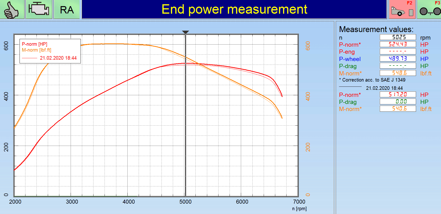

During this test at our peak power level we saw an gain of 7.23WHP and 8.0WTQ at peak power (5,000RPM). and 11.49WHP and 9.6WTQ at the end of the point. Check out the plots below!
Peak Power
Redline Power
