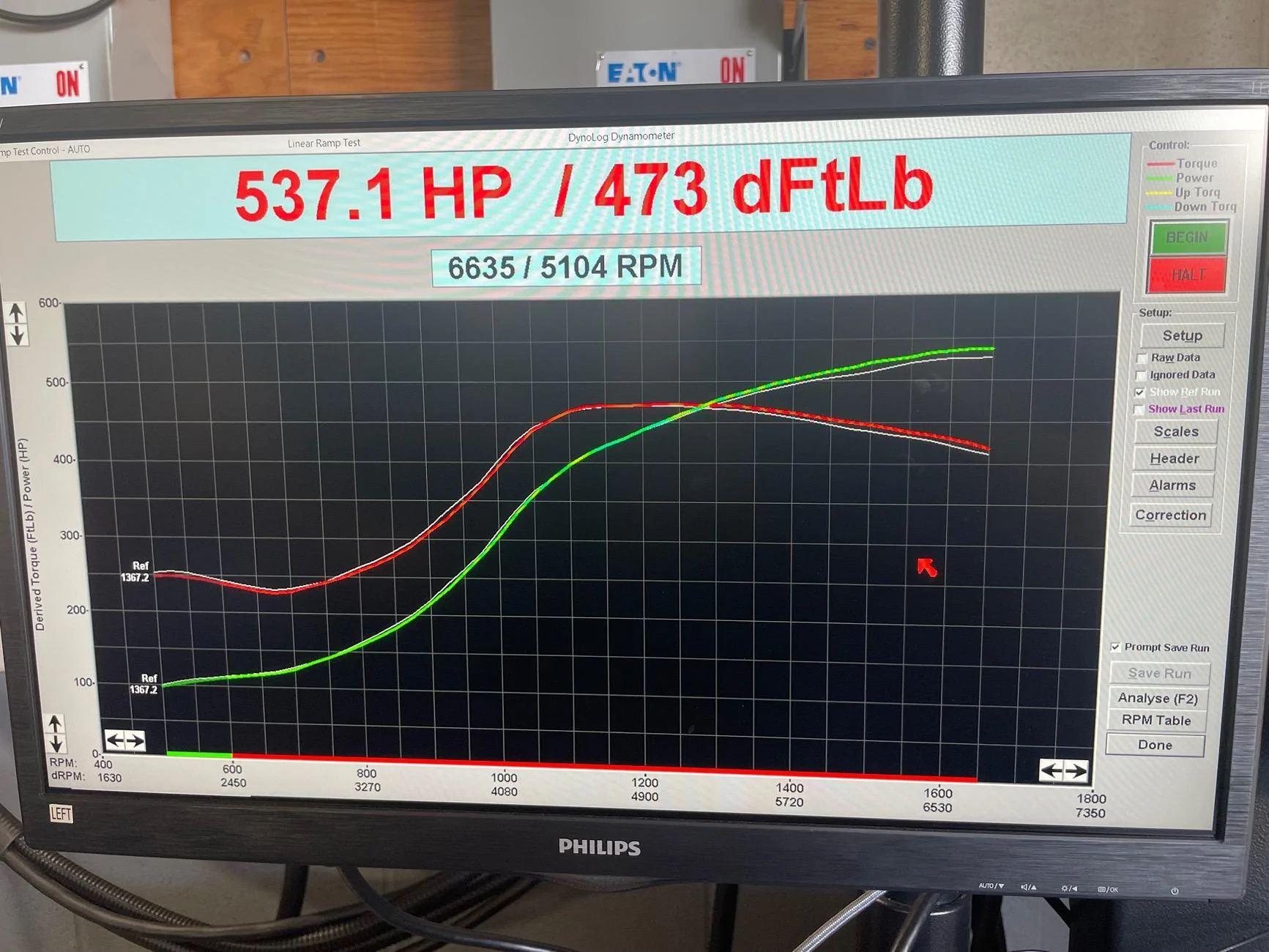

Here’s my A90
Femto unlock with MHD+
Remnant Omega 65 turbo kit
MAD catless 5” downpipe
MBRP catback
Spool FX400X HPFP
S58 injectors
MHD flex fuel kit
Clutchmasters 1000 series twin disc
Some other stuff..
Tuner: David Shoup
This hub dyno reads 7% lower than their dynojet.
94 octane - 537whp Mainline hub dyno ~ 577whp dynojet

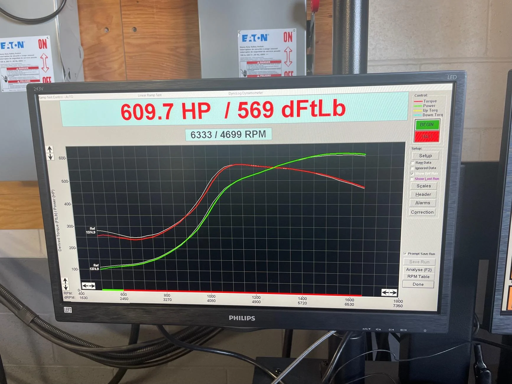

this next one is on E40 at 28 psi. Map is conservative. Ambient is 95. Starting IAT 104, finish IAT 126
609whp mainline hub dyno ~ 655whp dynojet

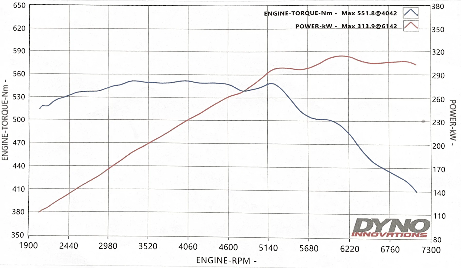

2023 MT with a JB+ and an AWE Touring (non resonated) exhaust running 98RON (ULP93).
That's around 420hp and 405ft-lb for the US folk.
