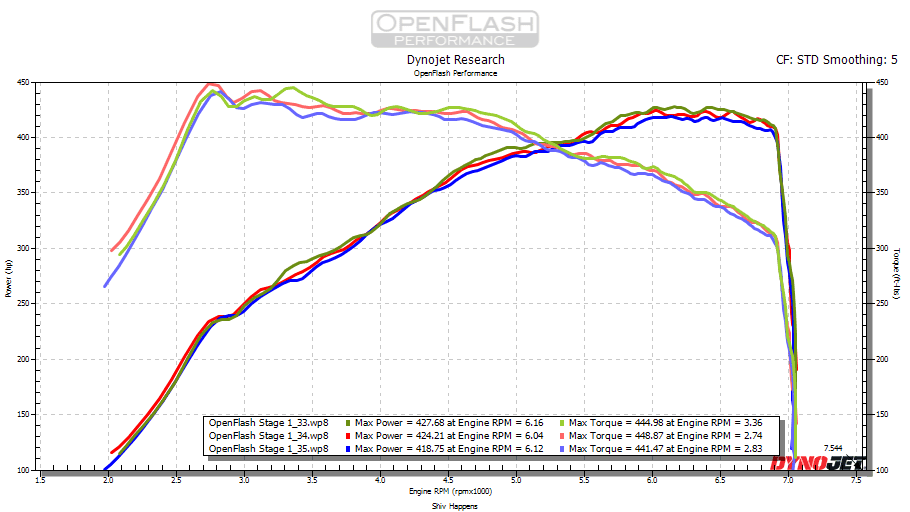

Wait..... 424 wheel horsepower with just a tune?? Jesus. :confused1:
Yep.. We actually had some higher powered runs but I wasn't happy with the slgiht torque dip at 5500rpm. So I sacrificed a little power up top for a nice solid gain at 5500rpm.

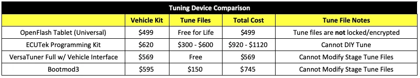

Whats the difference between OFT and EcuTek?
Sorry for the ignorance here never had a FT86.
From their website
METAL
K2
May 26, 2020
664
385
Peoria, AZ
www.instagram.com
I read through the website. I am more concerned on the tune itself, is it different? Is this also a tool to have other tuners custom tune for us? Does OFT offer more tuning parameters for a more custom tune?
Just speaking on the tuner....I have worked with him on a few platforms starting back in 2003 on high hp turbo cars
He's probably better then most or all of the guys on here tuning for pro teams in sports car racing for over a decade etc etc
I think the base tunes will be second to none...
Unlike ecutek though you will be able to fine tune and modify the tune yourself a DIY setup...think high end Mega Squirt setup
I don't know how his business model or customer service setup is?...But I can attest to his tuning skills and hardware knowledge

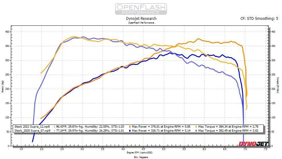

Here is a graph comparing a 2020 Supra to our 1 day old 2021 Supra. Both 100% stock. Both on the same dyno running California 91oct premium fuel. the difference in power output above 5000rpm is profound where the 2021 car enjoys a 40-50 wheel HP advantage. Full disclosure: This is the only 2021 we have run on our dyno. So I don't like to make assumptions based upon a sample pool of one. It's more than likely that it is representative of all other 2021 cars but until I get more samples, I can only assume this. The 2020 car is in line with the other 2020 cars we have tested on this same dyno. That said, Toyota's hp increase claims of 47hp between the 2020 and 2021 seems right on the money. Although the power rating for both the 2020 and 2021 seem to be conservative (ie, car makes power power than claimed). It's really impressive that they decided to make such a big power bump after the first production year.
