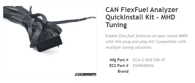

When you order the kit from any vendor you'll notice in the manufacturer part number an "AT"

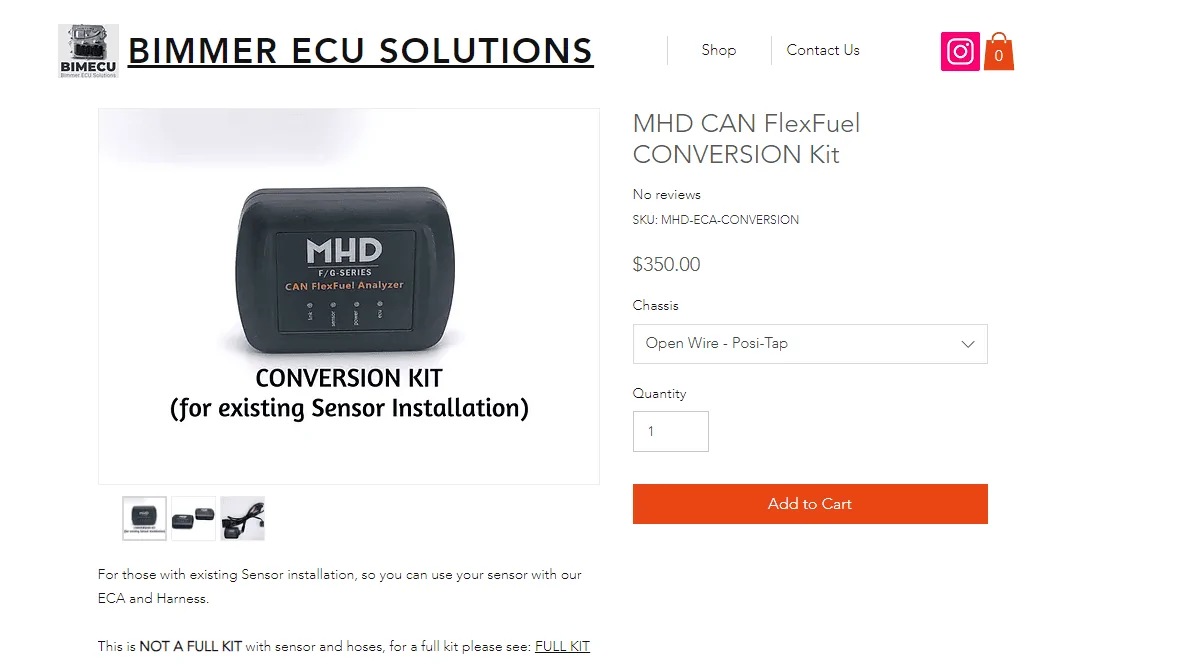

You have to specify with your order that it's for a manual supra. Better to talk to someone. Or else BimECU can send you their posi-tap kit. Which they did free of charge for me since they manufacture both products
Yikes, I never would have realized, thanks. I hope it’s still fully plug and play, or you’re saying it requires a tap because at this time all of the kits are AT specific?
I was dead set on not spicing into anything at all on this car lol, any time there’s an electrical gremlin on previous cars I’d always have to go back through anything that got added in.

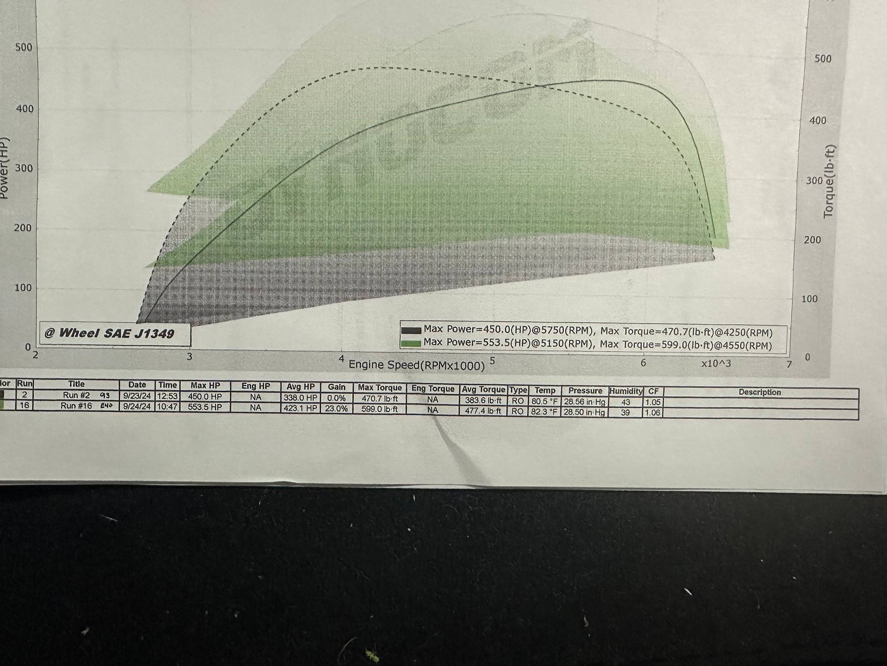

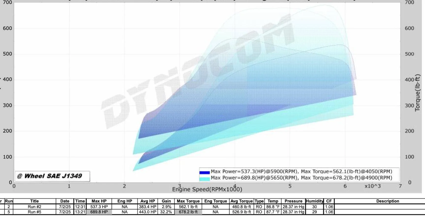

Does it really tap out at 6k rpm with a pure800? Figured it be able to pull closer to redline unlike the stock turbo.
Operating probably let off. Dynocom is also a hub dyno which really decels hard when ending the run.
800 has no problem pulling out through the top, even at high altitude:
