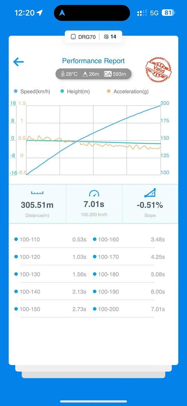

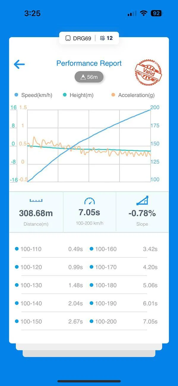

Also, did some 100-200 draggy runs, here’s the best one. These are my first ever draggy runs, but I was told at my power level I should be able to get 6.8s 100-200. I will do some more runs soon with cooler weather at night.
thats on the stronger map?
GW_Rowan
Rowan
Oct 24, 2024
Yes that’s on the 550hp map.
keep in mind some limitations:
  • I’m pump gas only. 98RON mixed with 1/4th tank 96RON from a lower quality pump
  • I’m on PS4S 305/30/19 rears
  • Was done in sport mode but using auto shifts. Might be able to get faster time with manual shifting
thats a great time for the weather you have there
Thanks! Glad! Numbers mean nothing unless you compare, I couldn’t find data on any setups similar to mine on the same turbo so glad to know this time is not shit
run was done at 28C in the afternoon. Will do more at around 18-20C at night soon
