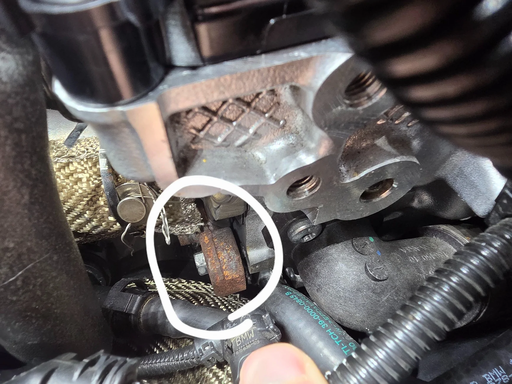

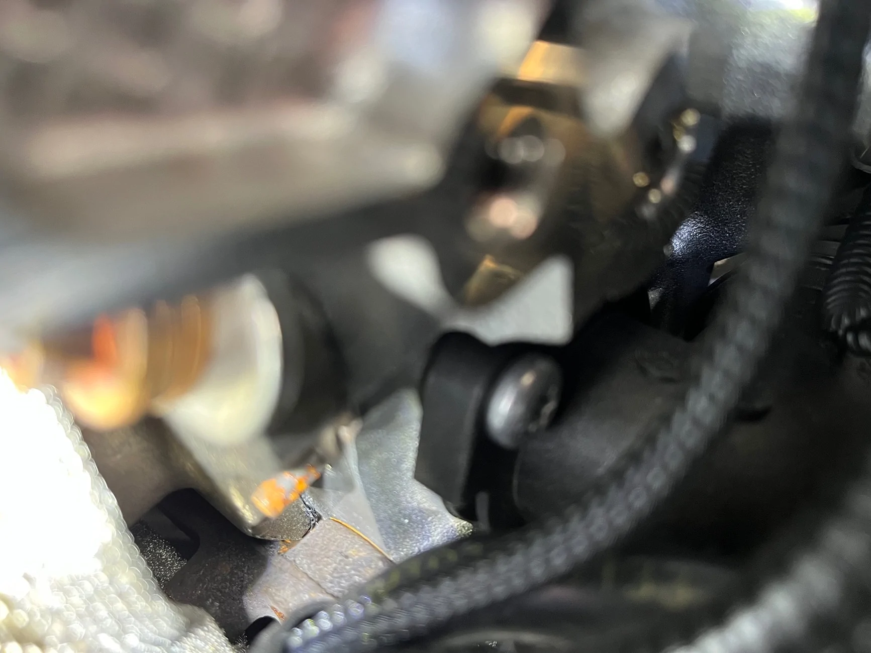

Is this gap normal. I didn't pay attention when removing the turbo, but just noticed this. It's the right side of the bottom bracket that holds the turbo

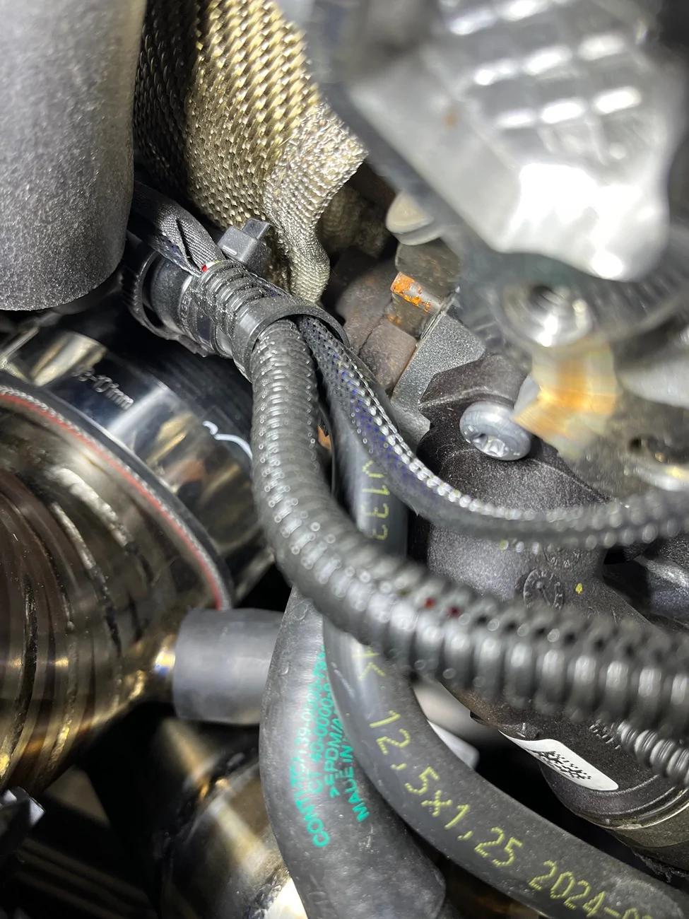

Here’s mine for comparison,. Looks to be a little carbon in your picture if it wipes off most likely not seated correctly. My current tune sees 20-23psi at 4k with MHD backend for comparison

Thanks for the photos. I think all I need to do is loosen the bolts and nuts and lift the turbo up. I'm seeing 24 PSI at around 3700, so I think the manifold is sealed just not aligned correctly.

Did you by chance not reinstall that lower v-shaped bracket that goes right above the engine mount? I’ve heard stories of the turbo slowly pulling the studs out of the head if it’s not installed.

I’ve actually loosened the top manifold nuts after installed just to see if downpipe would support it and it didn’t move. Only reason I left it off was at the time I misplaced the bracket but have since found it. I will however be installing it next time cars on the lift. I also barely drive it so not really fair to compare it to someone who daily drives or races.

What I realized is that V bracket at the bottom was pulling the turbo down to low and not allowing it to properly seat.

That should not be the case at all. What turbo are you running?

Daw 6769. But that bracket didn't fit right with the OEM turbo either.

OEM fits like… OEM. I think maybe you were doing something incorrect when installing. Did you keep the bracket loose on the turbo hot side when putting the turbo back on the head, or did you tighten it down before bolting in the two bolts from the bracket to the block?

I'm pretty sure I did it in the wrong order. I tightened the v bracket then went on the the turbo manifold. I had to remove the v bracket in order the get the turbo mounted correct, but now the holes for the v bracket to line up.
