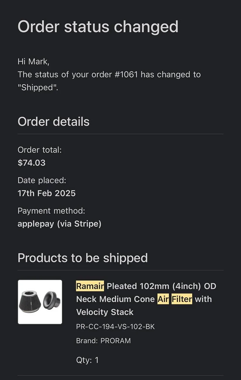

I wouldn’t worry about any lagginess. You will be impressed. Not sure what you’re upgrading from, but the turbo is very responsive. The RamAir filter, per Shawn, is the way to go, to allow the best possibly air flow for this turbo.
I would still try to make what you currently have work and send back the other one, if it does work and fits properly.
If you decide to order the RA filter there are several to choose from. Make sure you get the 102mm that is around 7.5” in length. The others will be somewhat larger and not allow the lid or brace to fit.
Thanks for the info. The CTS intake also has a velocity stack. I asked DAW about the Armastpeed intake and he said it should be good since it's 5 inch filter. Im also curious about a heat shield.
I currently have the verus heart shield does anyone know if that will fit with the 6769?
