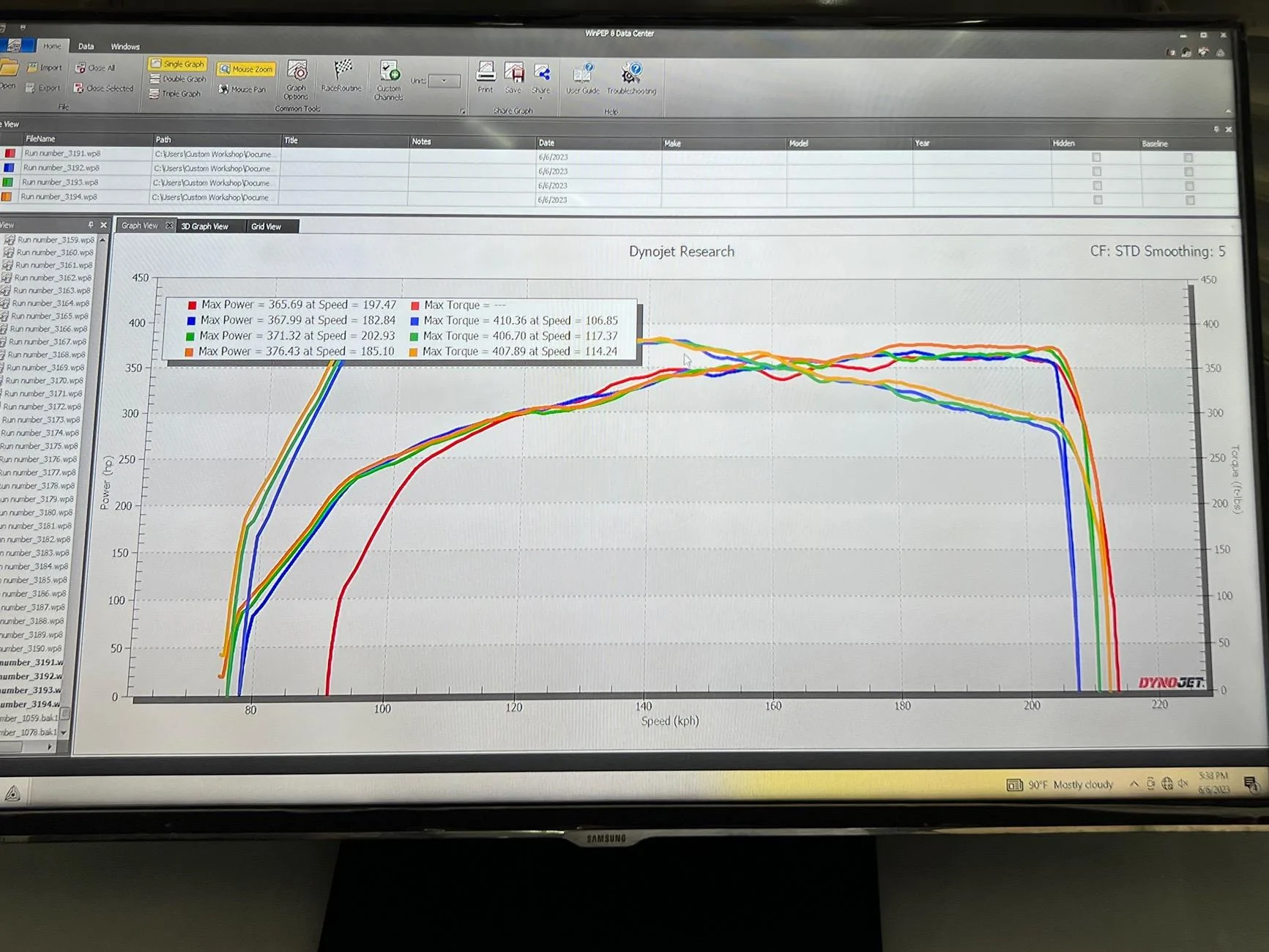

Finally got to my scheduled dyno session. These numbers seem to make a lot more sense to me.
I know I said I wanted to do things before/after modding but I kind of cheated here. All dyno runs are after an HKS intake and JB4 but I believe the gains to be negligible for intakes. Blue run is base (map 0), green and red are JB4 maps 2 and 3 respectively.
8,805
17,280
Man, the car really doesn't like that JB4. Holy wet noodle dyno plots. Stock looks nice and smooth though.

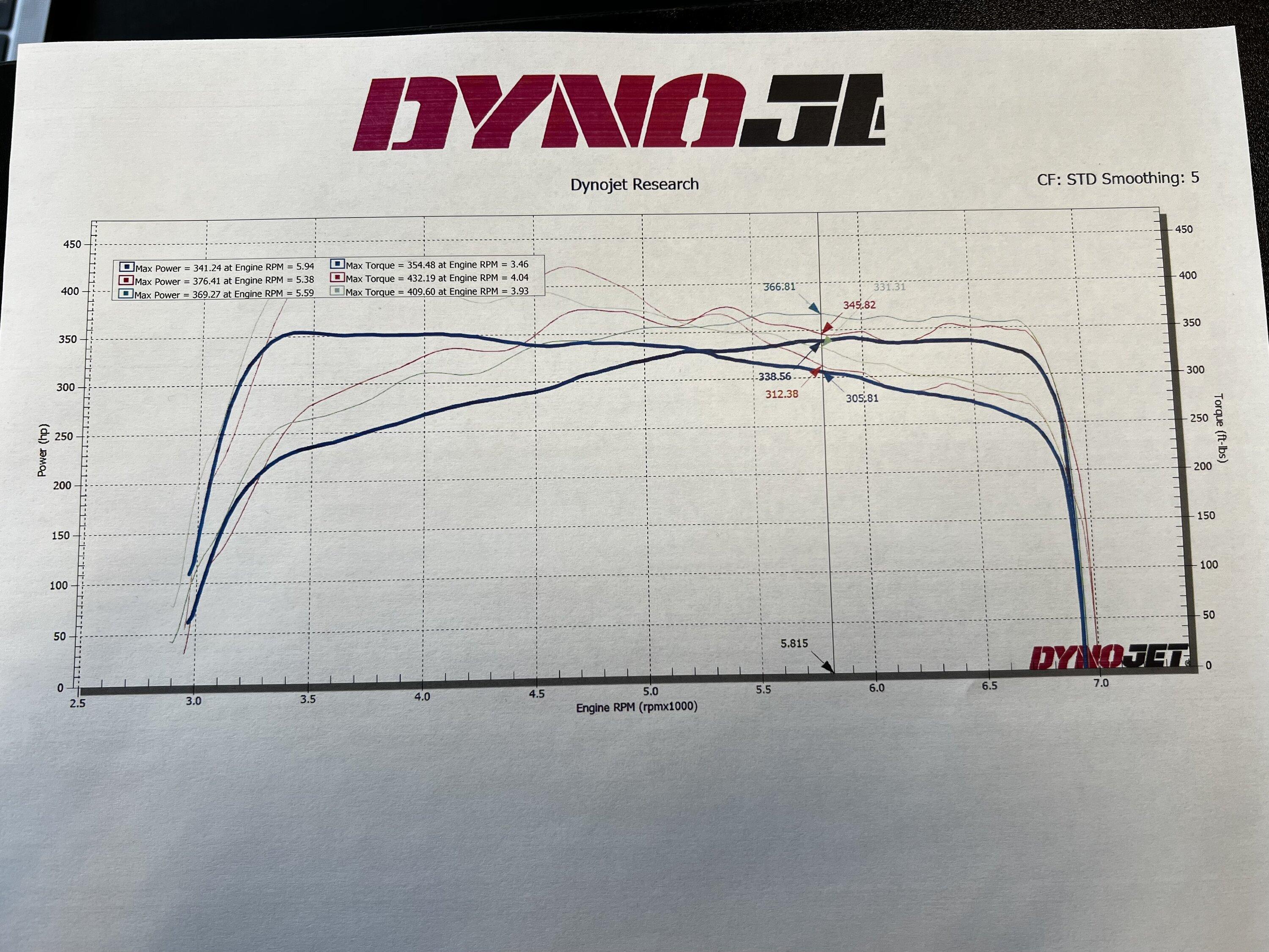

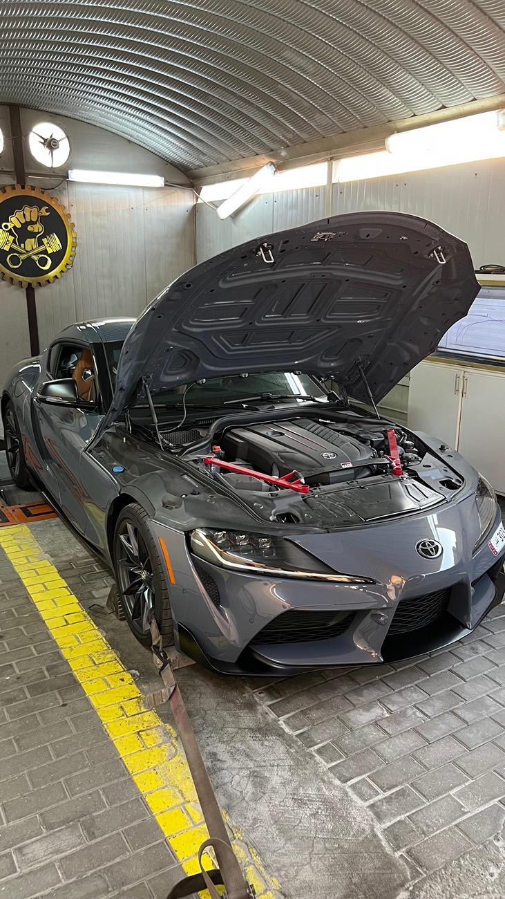

sharing my dyno results on my a91-mt. this was a year ago.
dynojet results:
completely stock no tuning no nothing.
91 octane (95 RON).
I barley remember which gear it was pulling 4th or 5th, can’t remember.
next saturday I have scheduled a dyno session with a new mods on the car, I will share it once I finish.

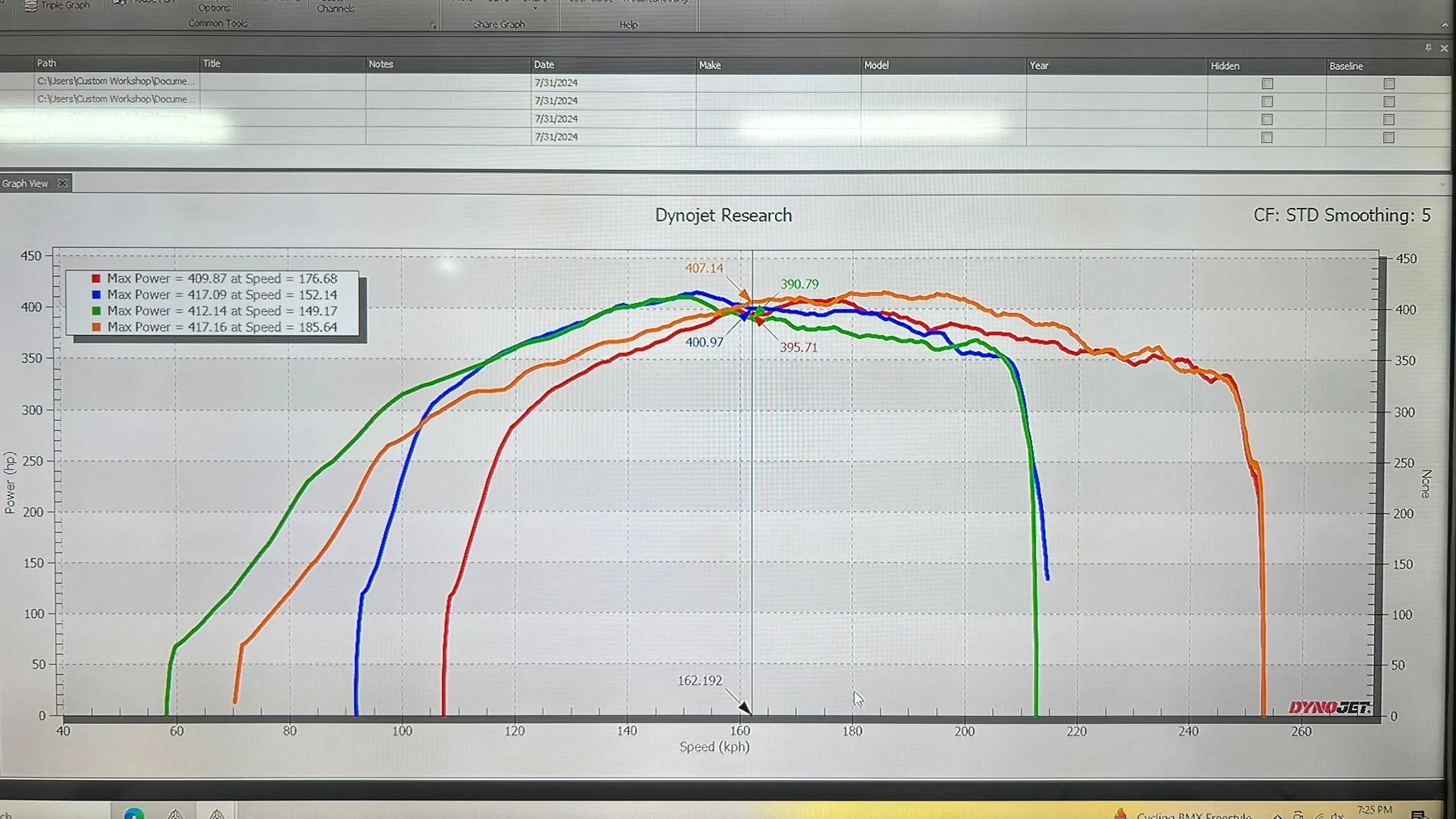

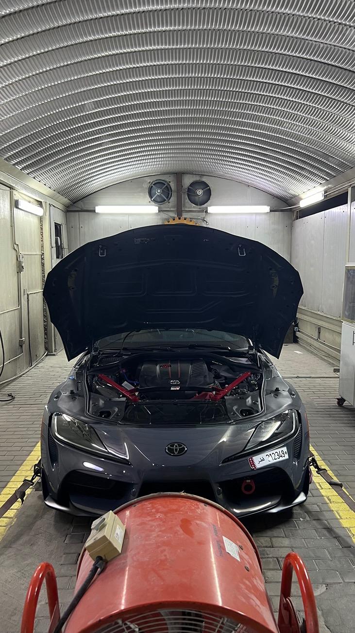

here are my dyno results from yesterday on my A91-MT.
mods:
Catless downpipe ( FI exhausts )
Full exhaust ( MADE Motorsports )
Cold Air Intake ( HKS )
Charge pipe ( Moshimoto)
Stage 2 91 Octane (95 RON)
Bootmod3
All of the runs were done in 5th gear except the green graph which was done in 4th gear.
As you can see there is a huge drop at the end of each run, the turbo is blowing hot air. As I know, the OEM turbo blowing hot air on maximum boost psi (23.2 psi) which it’s a default setting when you flash an OTS map. Also, the weather now in Qatar is very hot and humid, yesterday humidity was 84% :)

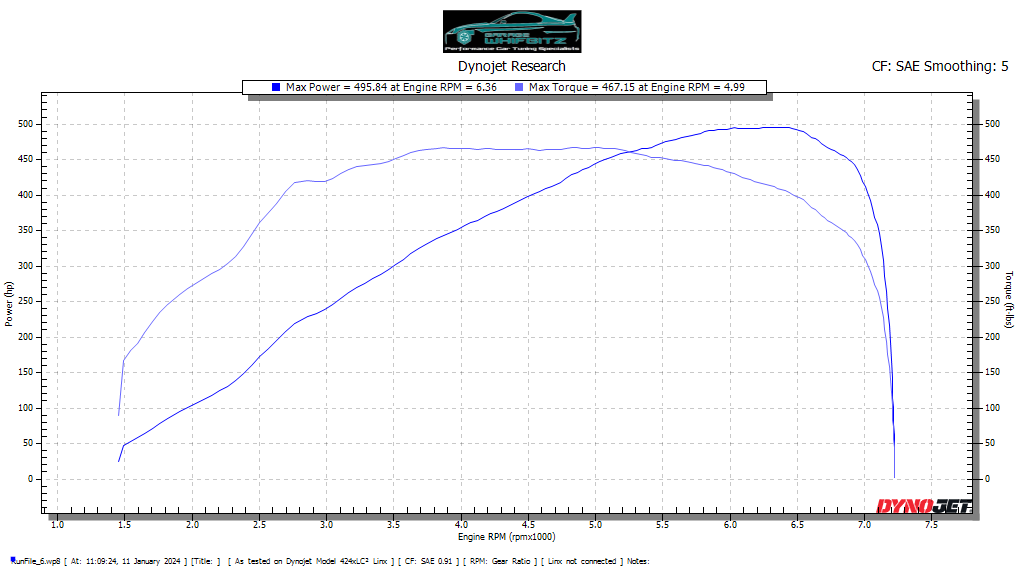

Here's my shitty A90 UK spec 2 port chart! :nixon:
At this time mods were:
Whifbitz downpipe
Akrapovic link pipes
Akrapovic titanium silencer (at the time of the mapping this was on the stock silencer as the Akra was off for repair)
MST intake
Forge hard pipes
Wagner charge cooler
Whifbitz hybrid turbo
Femto unlock
BM3 stage 3 custom map
