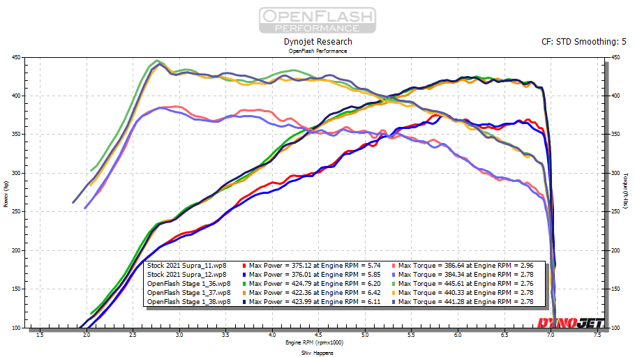

Another quick update:
Just finished mapping our 2021 Supra. Now with 700 miles on the odometer. Took time to find all the various torque limits in the ECU code. But it was worth it! No mods other than an ECU remap. Stock vs Tuned below. 93oct. 91oct made just 7hp less since it runs 1 deg less ignition advance at max load above 5500rpm.
Picked up 65whp at 6400rpm which really makes it pull to red line nicely vs the stock tune which flattens out above 5900rpm. For reference, the stock 2020 Supra makes around 330whp with even more top end roll off.
Got partial throttle boost targets and load settings to the point where power is pretty linear which makes the car pretty easy to drive hard. Most tunes for these cars turn in the throttle into an on/off switch. Making them pretty leery to actually drive in anything other than a straight line. This one is a driver, that's for sure.
