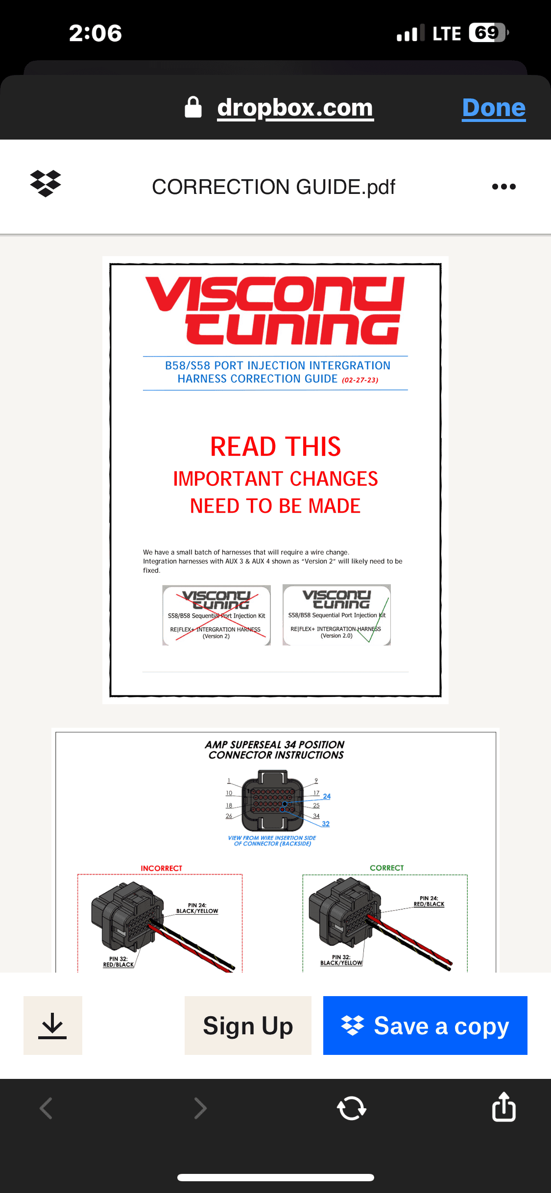

After help from Motiv he was able to get me an answer from Visconti. Some harnesses have 2 wires/pins crossed in the main plug that connects to the reflex. Pin 32 and 24 need to be switched and that fixed my issue after reaching out to everyone for months. I guess visconti knows the issue is out there but doesnt want to make the fix public.

Now it's made public... :rolleyes:

So I was finally able to fix mine, was a wire pinned into the wrong aux on the reflex box, But now when I'm at WOT, fuel pressure cuts to 0 goes to limp mode and then just goes away. Anyone else having similar issues? I have visconti pump, and 1050 pi injectors with EOS port plate, and full visconti harness and flex fuel.
