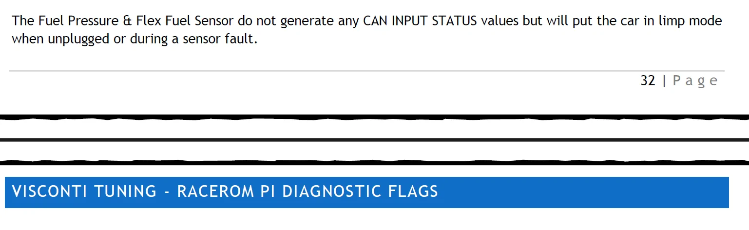

I didn't install PI but I was reading the manual of VISCONTI TUNING PI installation and I found this statement

Yeah, when my car has FP sensor turned on it goes in limp mode under boost. so right now my tune has it turned off. Does your relfex box has 2 ports or 4? Mine has 4
