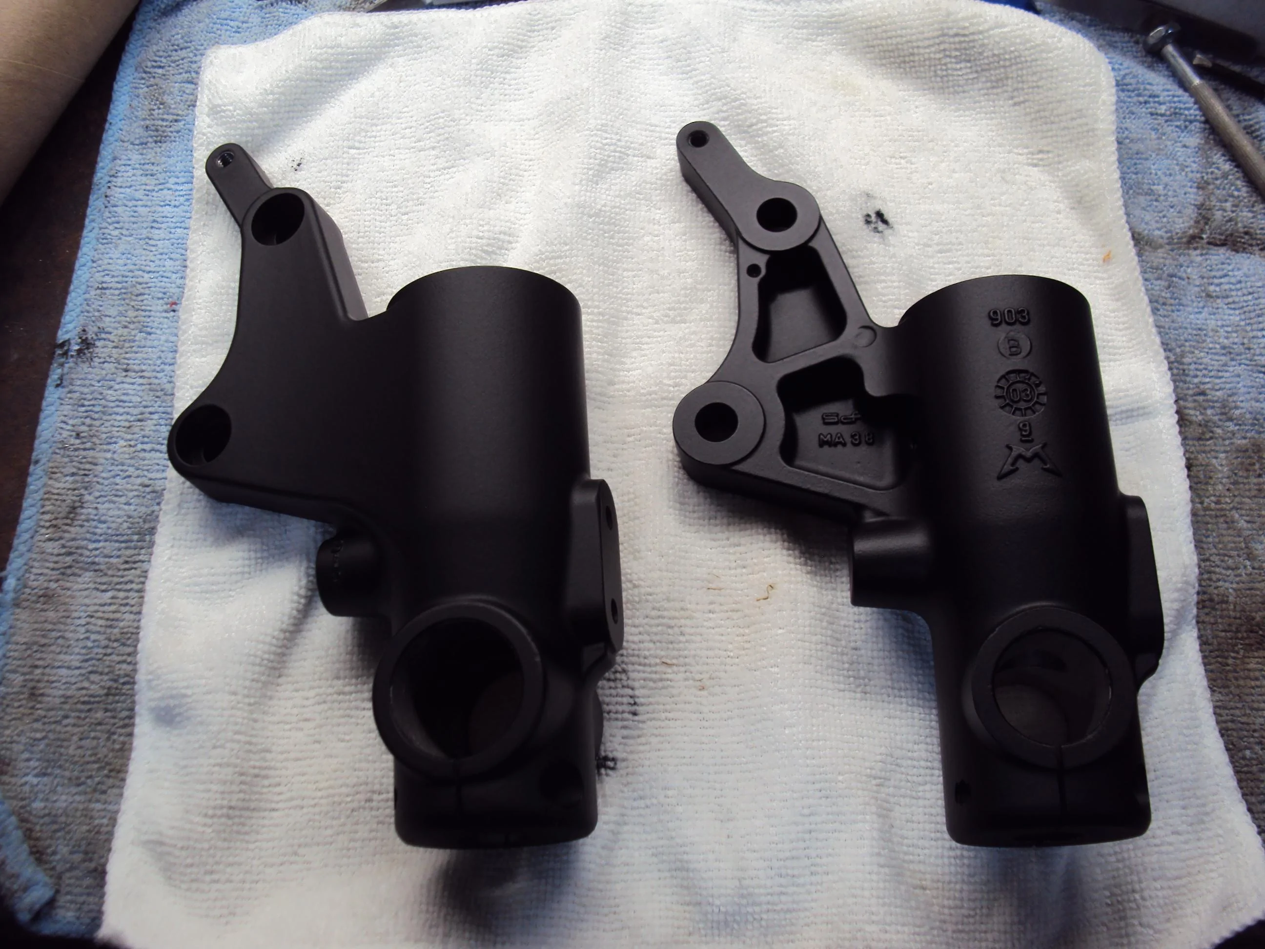

This is very interesting. Do you have a link on where to buy this “2 pack”?If the TB isn't able to be powder coated and you are desperate to colour match it with other engine components you could always have it sprayed in 2 pack. 2 pack is fuel and plenty enough heat resistant for a throttle body and has excellent adhesion to metal parts without primer. The prep and masking would be a bit fiddly but definitely very doable and workable. I've painted engine components in 2 pack many times that have far more onerous conditions to deal with than engine bay heat. You can order it in small quantities and spray it at home if you have a gun and compressor. A breathing mask is highly desirable but for small parts it's quite doable. You can even buy 2 pack in a spray bomb style can where you activate the in can catalyst and have a period of time to spray the component. Ideal for small jobs like a TB.
