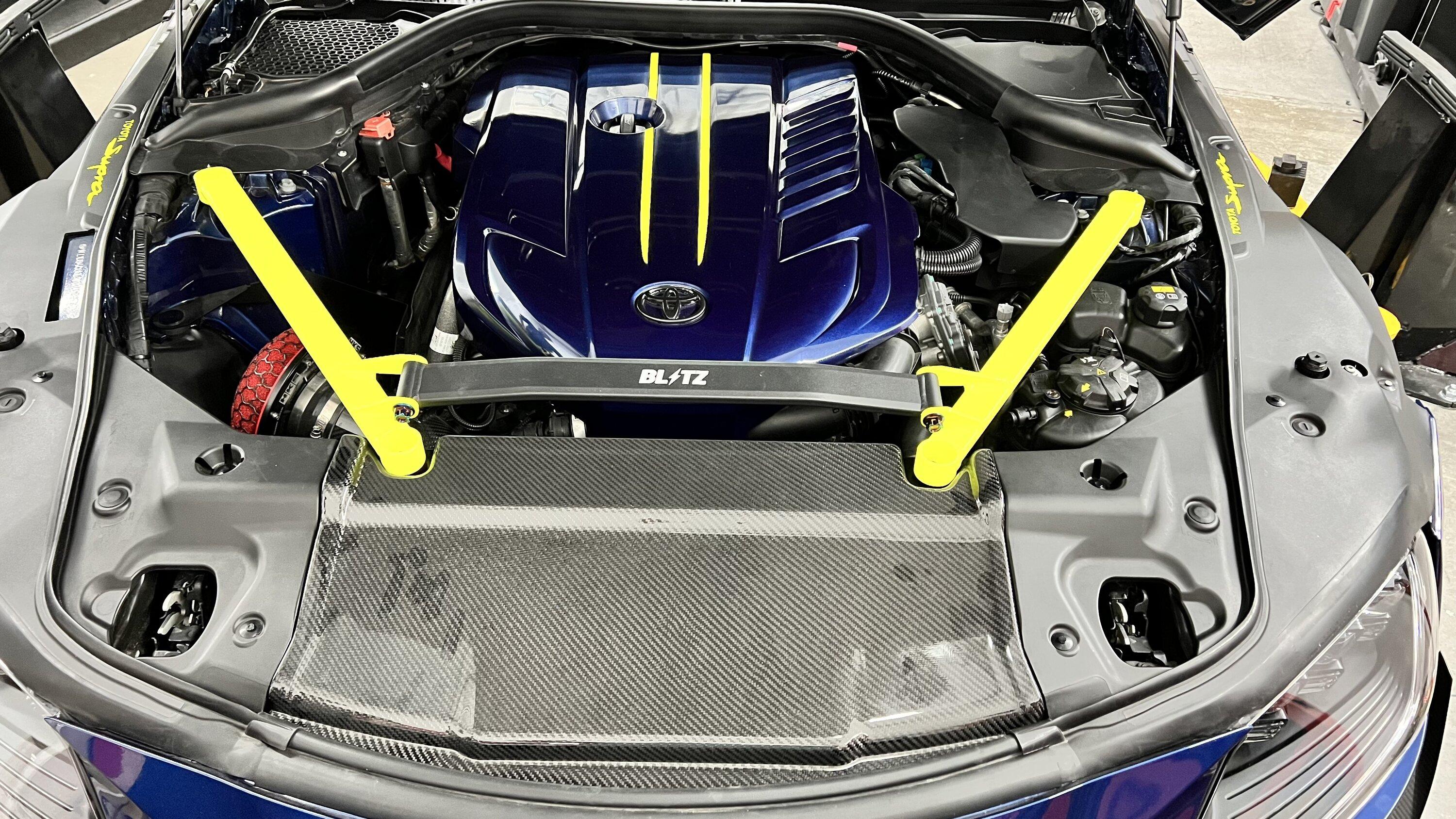

I just painted mine myself, got the paint from automotivetouchup.com wasn’t very much and 2k clear. Less than 100$ total.
If I was to do it again, I wouldn’t spend the hours sanding it. I’d just hit it with a good filler primer instead.
looks great!
Clean!!
that looks nice!
