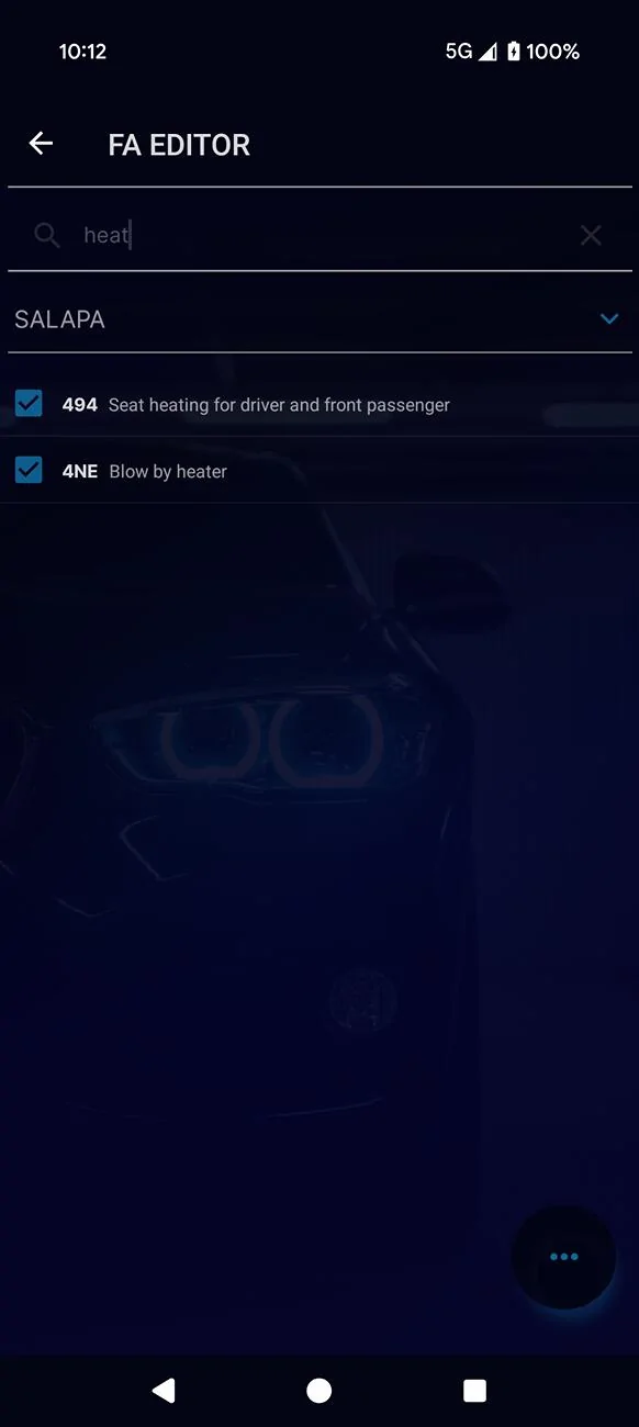

You'll need a better tool than Bimmercode, as you'll need to edit the vehicle order to include the heated seats option.
It basically tells the car "hey dude, you have heated seats. You can start acting like it."
This can be done with esys, protool, bimmertool, etc.
Some additional coding may need to he done afterwards, which can be done using bimmercode.
