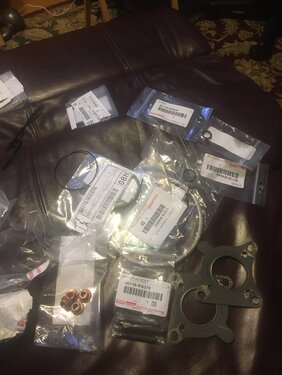

Hi guys just wondering if I’m missing something here. I just received my pure 800. But it seems like I didn’t receive my install kit. I have no idea what it consists of. Does anyone know what exactly it is and what is should look like or consists of?

Other than the turbo itself, the only thing you need to install it is the plastic compressor inlet pipe since the stock one does not fit after Pure machines it out... Not sure what an install kit is comprised of but thats the only thing you need... Maybe some coolant too

The install kit comes with all the gaskets and o-rings Toyota calls for replacing on the turbo from the handbook . You’ll only use a couple things though depending on how install goes . I personally changed the manifold gaskets , copper nuts , and the turbo studs that come out of the engine block. I’ll take some pictures what came in my kit later today.

the install kit includes bolts and gaskets, i recommend sending a picture of what you received to Pure or your vendor

Thank you. So technically speaking I don’t really need the kit ? I would like the kit since I already paid for it

If you have a install kit on the way I would wait. Good piece of mind tool just in case you want to switch gaskets or copper nuts .

Did you manage to take the pictures?

Can you get better pics of the part numbers?
