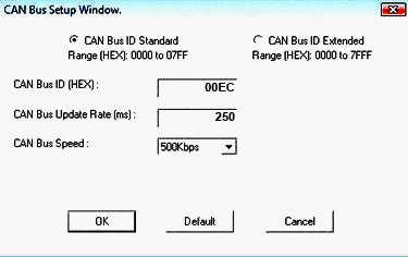

A sensor is a sensor. The tuner can confirm if the tune is reading the sensor content over CAN bus. If the answer is no, then it's installed incorrectly and/or the tune is not configured correctly to read the CAN signals the Zeitronix box is sending about the eth%.
These are compatible devices.

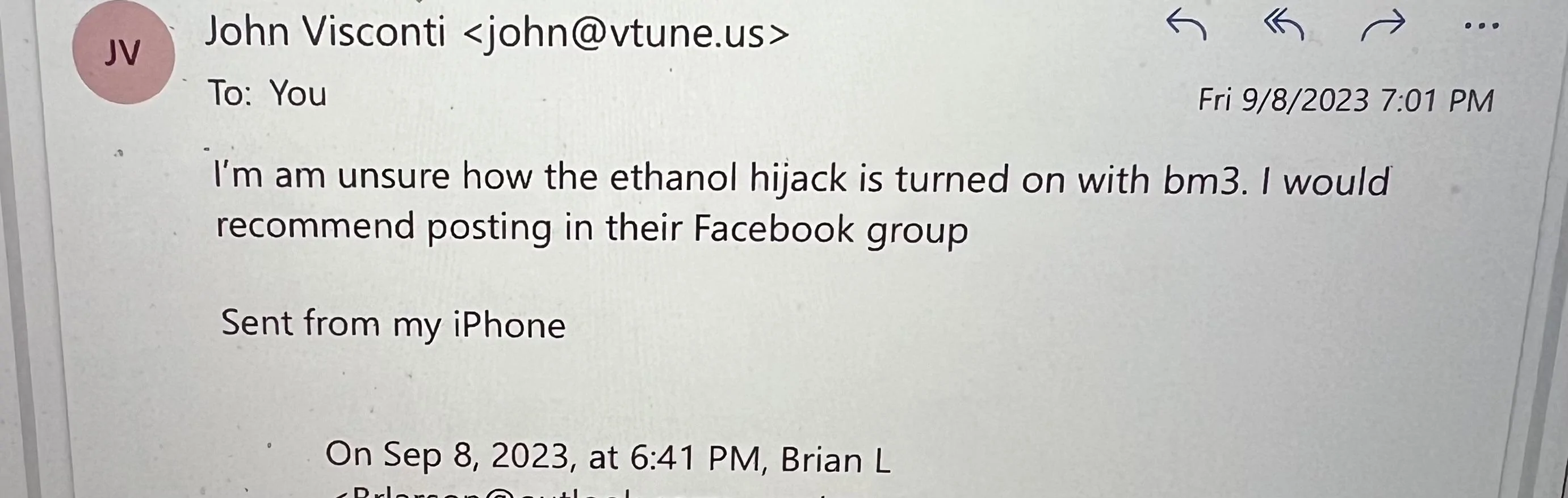

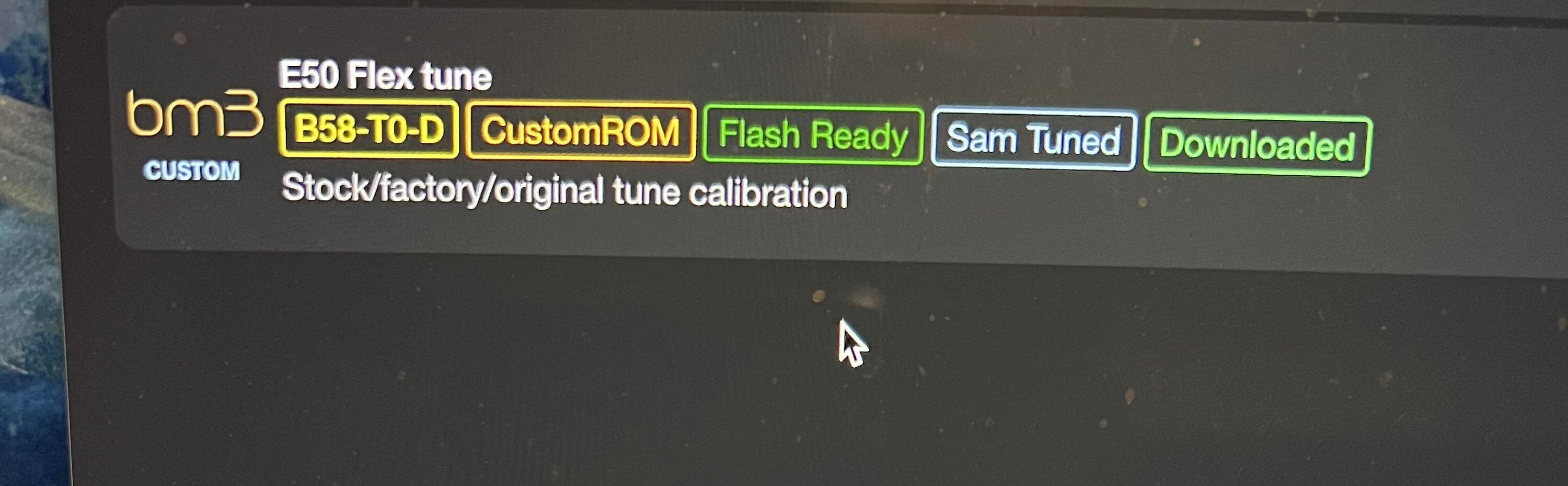

Long story short the Visconti kit was junk at least for BM3 it is, never got the kit to work even with professional help. Went BM3 kit installed myself and worked instantly.
