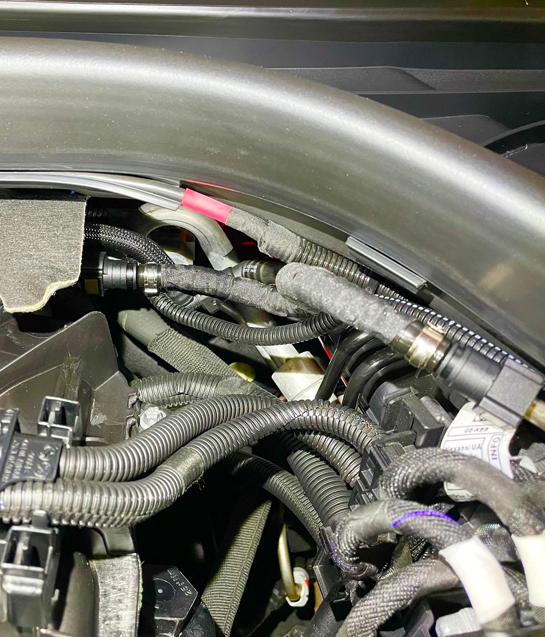

Yes if the fuel line is left touching anything in the engine bay. The vibration wears right through it and Kaboom.
I wrapped mine with high temp harness tape and its shows no wear after 3.5 years. I check it every oil change to be safe.
