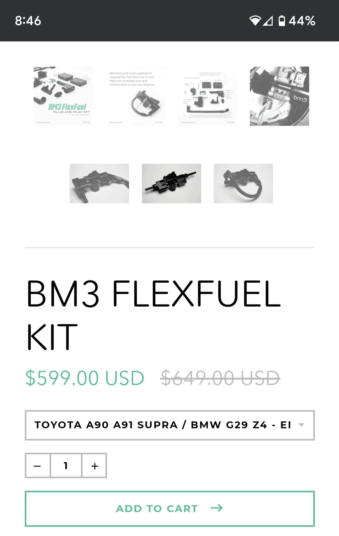

So I have a 2021 3.0 and I’m wanting to do the bm3 flex fuel kit. I had my dme femto unlocked and am running BM3 software for the tune. Do I need to buy their Supra engine bay location or their bmw gen 2 engine bay location kit? Their Supra option isn’t specific on gen 1 or 2 b58. Just want to make sure I’m ordering the right one.

All supras are gen 2.

Well I feel stupid. I guess I was thinking if there was a difference for flex fuel kits between 2 port and 6 port.

What confused me the most is I got an email from protuning freaks saying to choose the gen2 option… and there isn’t one.

It is the engine bay location kit, last one on the pull down menu. Order the same one that jRun posted.

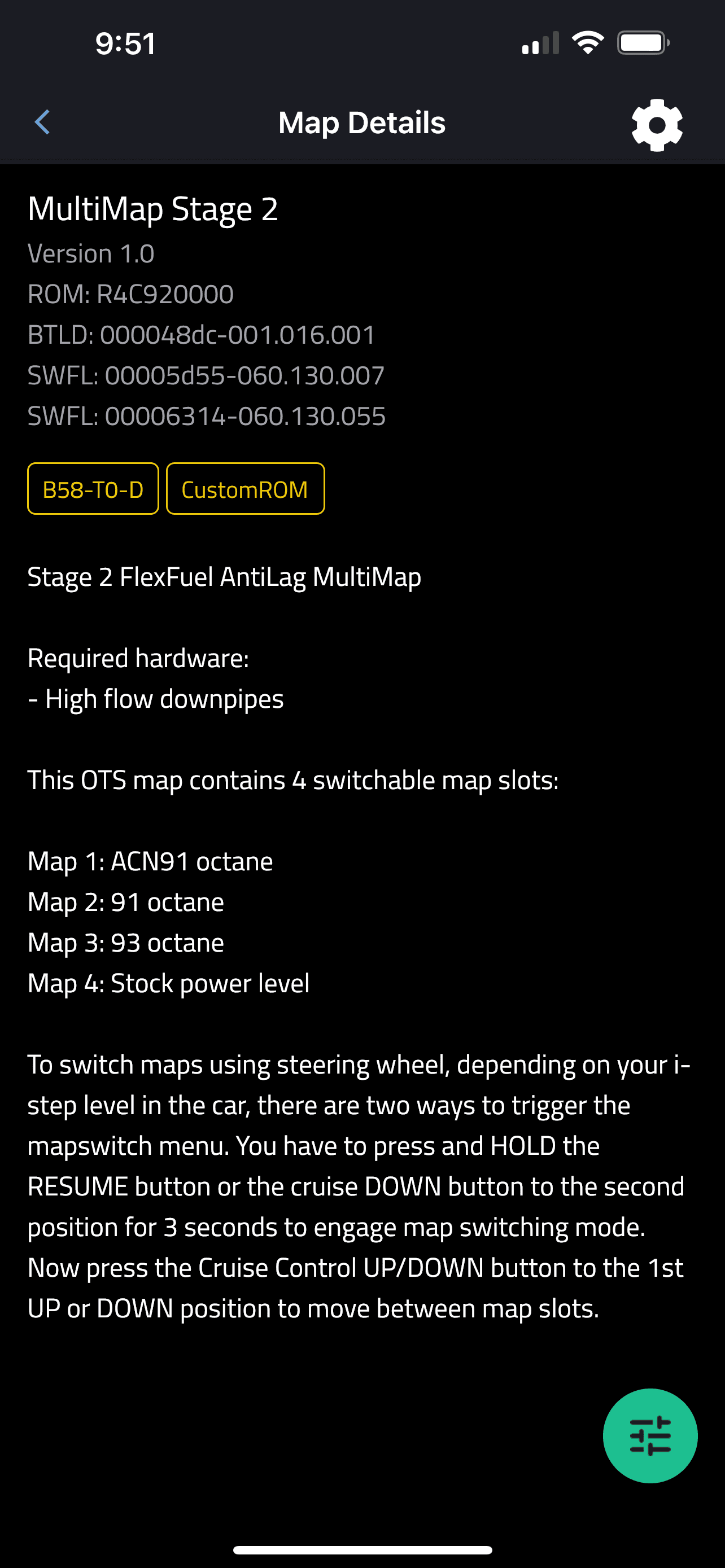

Am I seeing something g wrong? On the stage 2 multi map I’m only seeing 91-93.
Evilpenguinking
Jack
Apr 30, 2023
150
Indiana
2021 Toyota Supra
All 4 slots has flex fuel enabled. Just fill up your tank with ethanol, and it will automatically enable the flex fuel map.

My understanding is you should choose the correct 91 / 93 map that corresponds with the type of fuel you are putting in and blending with your e85.
For instance I blend 93 octane with E85 to get E50 ... So I choose Map slot 3 - "93 octane"
