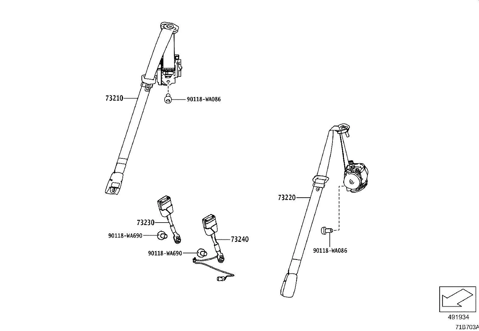

Hey, try and see if holding the bottom part of seatbelt resolves it. There is a sleeve down there and probably needs to be longer, thicker, more padding. My noise comes from there. Try it before you rip things apart. Hope you see this
Hey thanks for the note.
I put my ears to the seatbelt pivot/column and it’s definitely coming from there.
I know what you’re talking about and it does make a noise when I slap it or lightly touch it. I’ll check tomorrow for sure on the drive over to Home Depot.
What material did you use to insulate it?

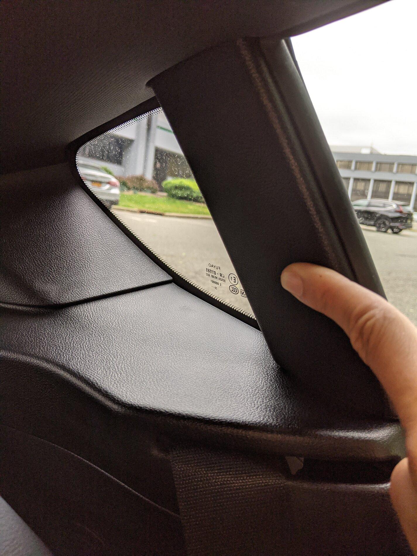

Hey there were you able to successfully troubleshoot and fix this? Where was that noise coming from and how did you fix it?
I don't know 100%, but it sure does feel like it's this plastic panel right here for me...
