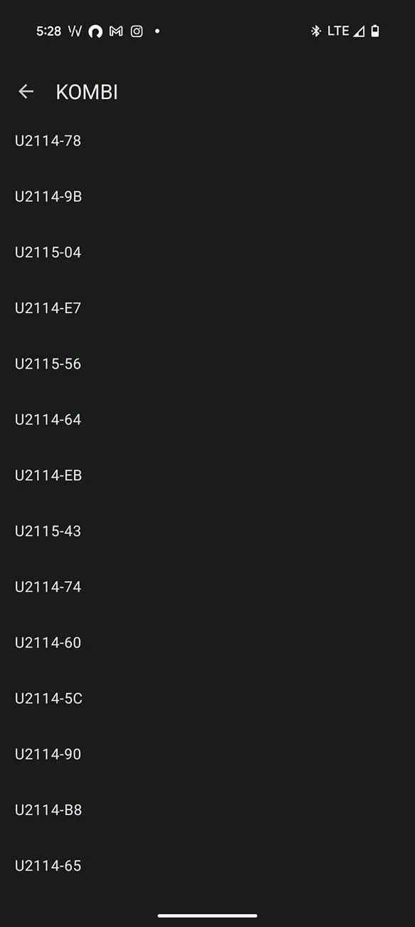

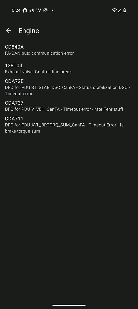

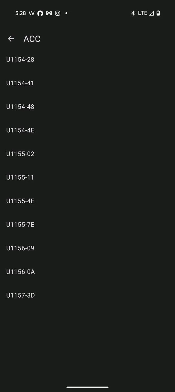

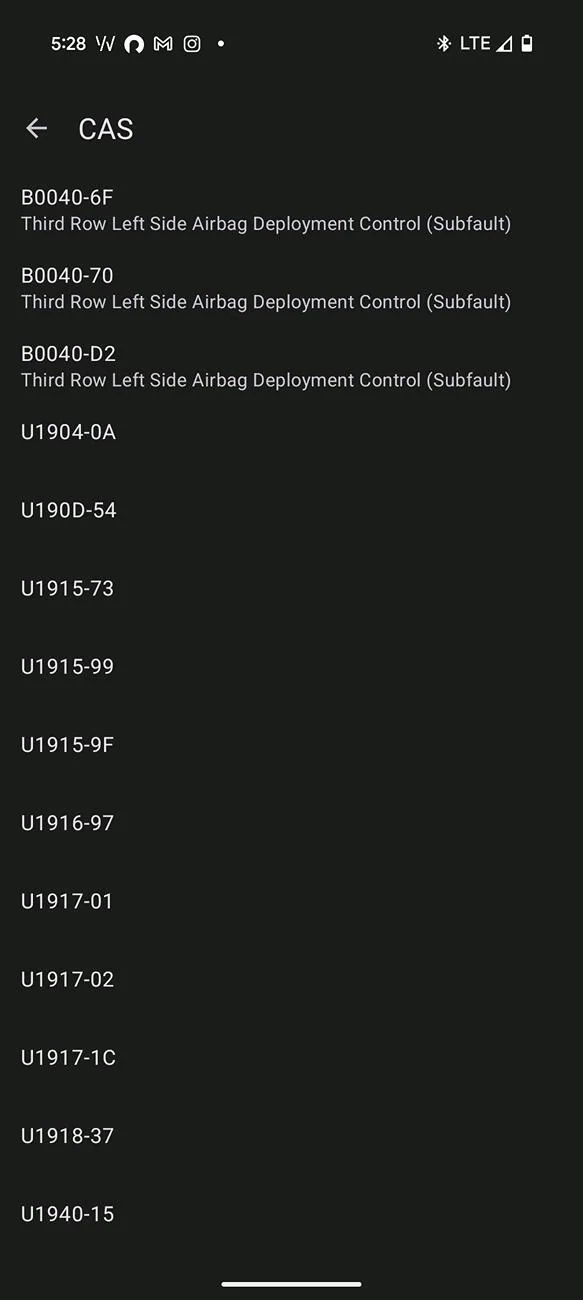

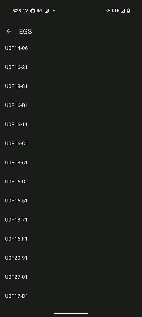

Hello, Just had a flex fuel kit installed on my car by a local reputable shop.
The car is running fine but threw a whole bunch of codes.
I wanted to see if anyone had run into these same codes/ if they are something that will be tuned out when I get a new map for flex fuel.
Not looking for any diagnosis or anything like that all I am trying to achieve by posting is to check if this is normal or if the Zeitronix ECA-2 Canbus was wired wrong.
Car is a 2020 with a Twisted Tuning Downpipe with a 93 Ecutek tune by Twisted Tuning. Installed recently was a SP1-R and flex fuel kit I put together with the Zietronix ECA-2/ethanol content gauge, Precision Raceworks 360 Fittings, and Continental Flex Fuel Sensor. Also attached are the codes. Thank you!
