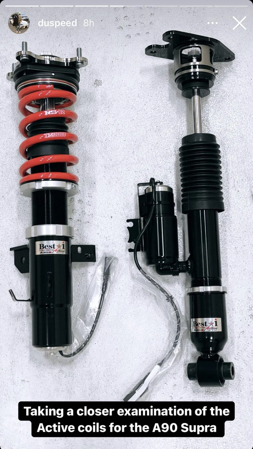

Has anyone tried their Best-I coils, just gathering opinions to decide if I should get them.

Their best-i coilovers retain the active suspension already. We have them in stock.

Preset Approximate Height From RS-R:
Front
-30mm to -35mm (-1.2in to -1.4in)
Rear -40mm to -45mm (-1.6in to -1.8in)
Maximum Adjustment Ranges
Front
-5mm to -80mm (-0.2in to -3.2in)
Rear -15mm to -70mm (-0.6in to -2.8in)
Recommended Adjustments for Optimal Ride-ability
Front
-10mm to -55mm (-0.4in to -2.2in)
Spring Rates:
Front
8.00kg/mm
Rear 14.0kg/mm
-Josh
