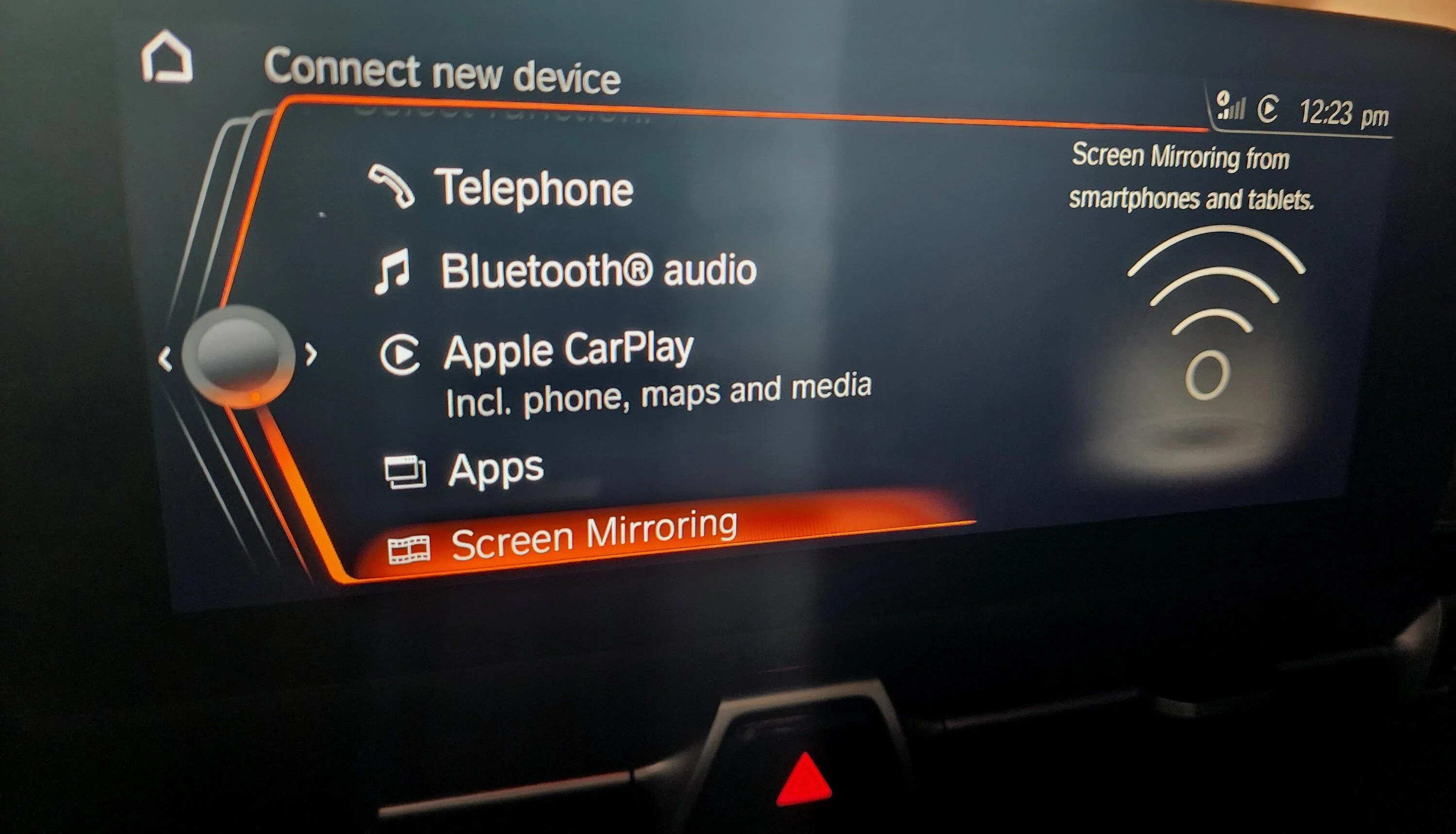

It works on my 2021 but only for Android devices.
I did code the video in motion/video via USB from the Bimmercode manual (#8) posted here.
I had to add it as a device specifically for screen mirroring, so in iDrive I have the same phone twice: once for Bluetooth and once for screen mirroring.
The touchscreen doesn't work when screen mirroring and anything with protected content (Netflix, Disney+, Sportsnet/TSN, etc.) won't display. It's good with YouTube though.
I hope this helps!
I hope this helps!
Where did you find the screen mirroring option? What steps?

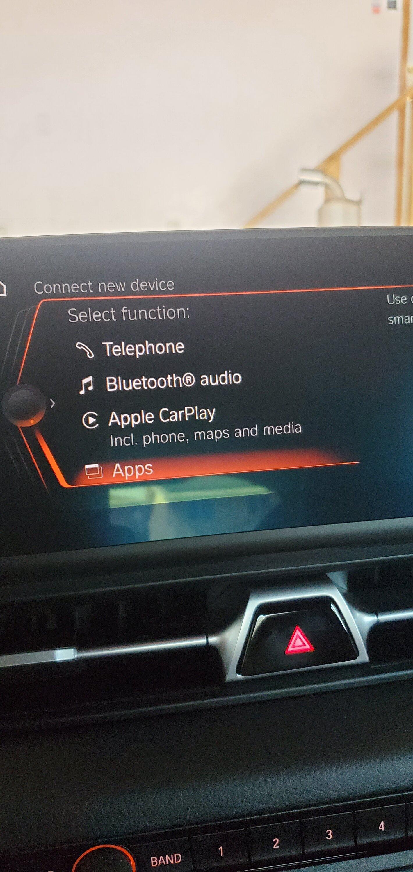

I only see these options.

Have you added screen mirroring via Bimmercode? I think that's how the option gets added:
Oh its has to be added first? Then video in motion?
Wonder why it's in the manual and not already installed.
Yeah I'm pretty sure it needs to be added. I think it's because of laws in different countries about video on screens in the front seats. Hopefully you can get it working. Good luck!
