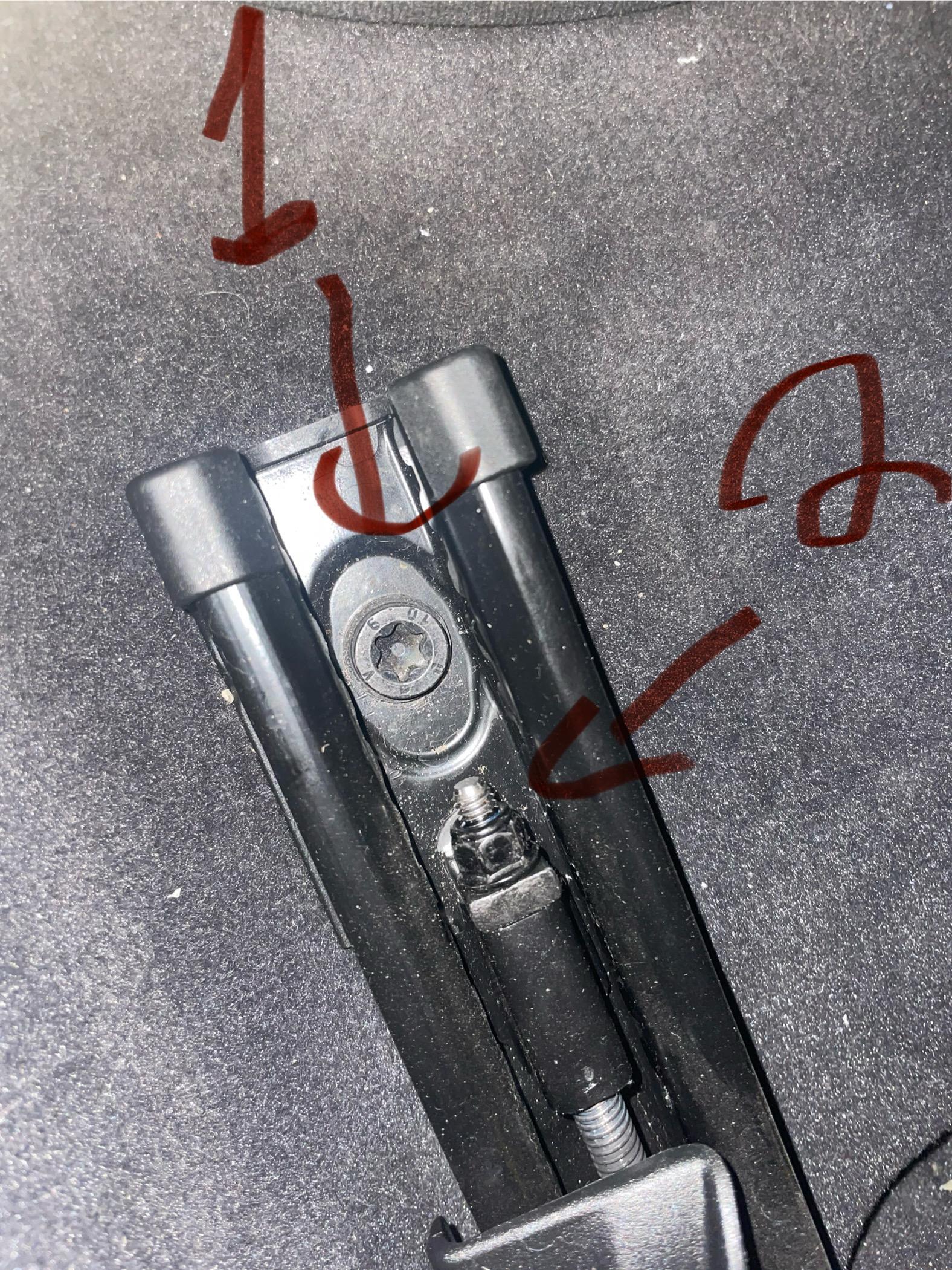

i have the same problem also
i try to tighten the bolts(number 1 in photo) they are close very strong
but number 2 bolt is loose a little bit, i have no idea what this bolt do and i dont want to do any damage
i checked on the passenger side, number 2 bolts also loose a little bit
this problem is super annoying
