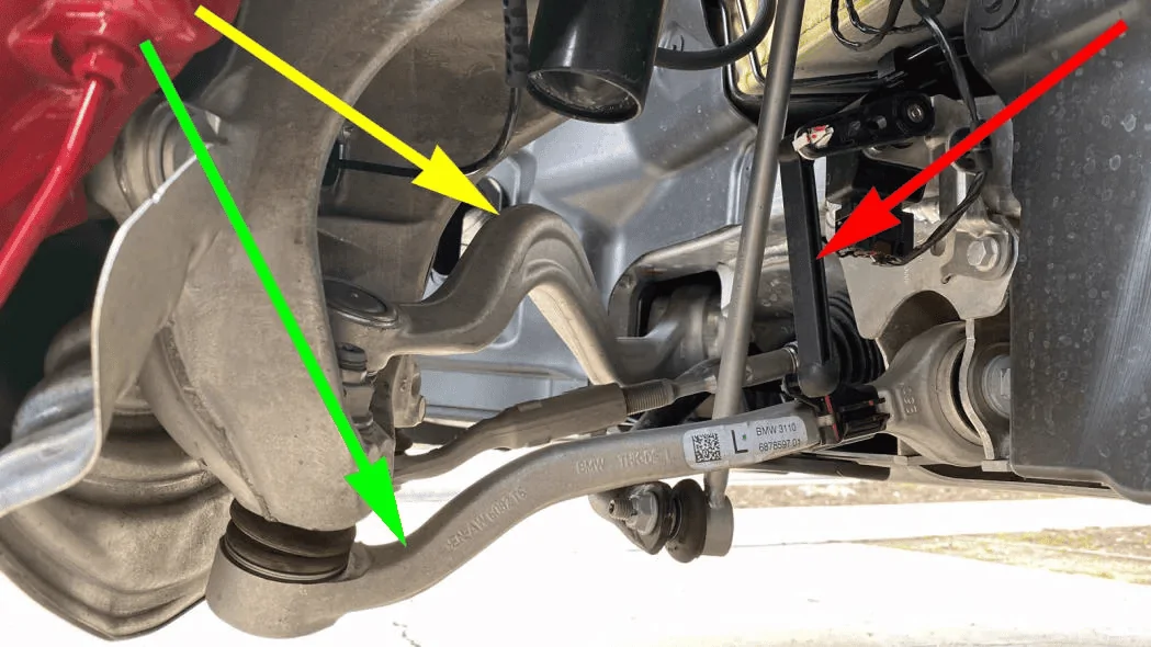

I bet you one or more of the chassis height sensor brackets are broken. There's one front left and back right. I'm pretty astonished they let you take the car back with this error on the display. The front left height sensor is pointed in red, and the one on the rear looks similar. It's just a cheapo plastic piece that snaps onto the suspension arm (green). This will limit the car's behavior for safety, because it isn't sure if the suspension is messed up.
Are you the first owner of the vehicle? The possibility of a broken height sensor and a warped wheel hub makes me think this car was in some sort of impact, perhaps wheel on a curb or a nasty pot hole.
Neither are broke and both intact, and no wrecks,curbs or pot holes hit. Is there any way to reset it without having a dealer do it?
