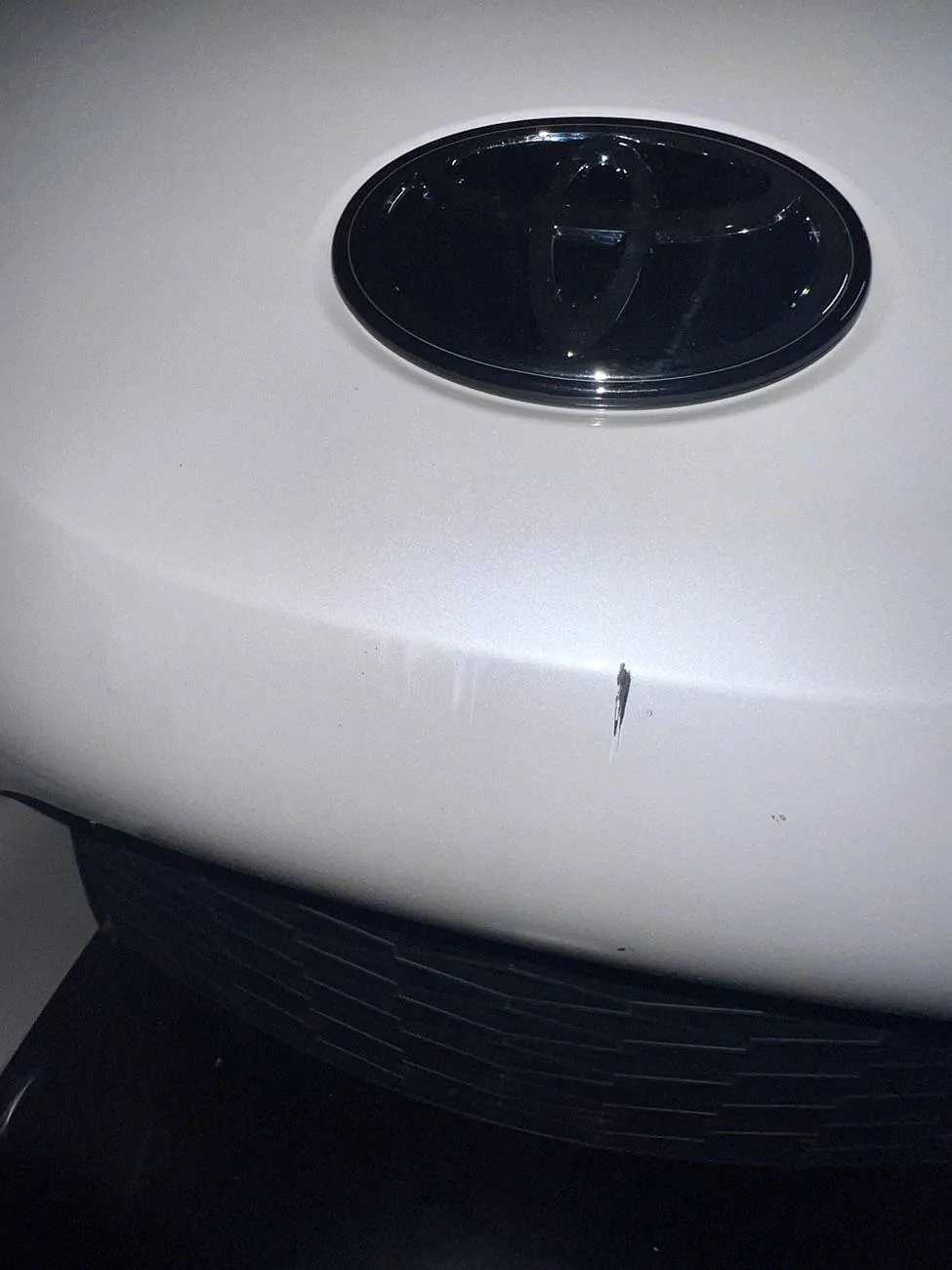

Should I try DIY or respray the bumper?
Eternal
Jun 6, 2025
Toronto
2024 3.0 Premium / 2021 Wrangler Rubicon JLU
Garage door dinged the bumper.. I’m hearing about people getting a respray but my concern is the paint match with absolute zero. One shop quoted 1300, another said 650. Should I just try to deal with this myself with a little touch up? I definitely want it back to looking new with a proper paint match.
driftguy
Feb 9, 2017
108
Austin, TX
2021 Nocturnal 3.0 Premium, 2023 BMW Z4
That's a respray.
Anything you DIY will not look good enough. Too big and deep of a scratch.
The bits on the left may mostly buff out though.
itzTang
May 17, 2023
849
842
Socal
2024 Supra 3.0
+1 to respray
too deep for touchup. surprise the garage door didn't sense the front end of that car. you can raise it up so it wont happen again
Lonestar_Nomad
Robert
Jan 29, 2023
150
289
Austin, TX
‘23 GR Supra Premium MT
Touch up will look like butt, especially since it’s a 3 stage pearl. Fortunately that is in a good spot. Paint tech will have plenty of room to blend the paint. Usually I hesitate to recommend cheap, but 1300 seems high. I’ve been out of the body shop for a while tho so maybe things have changed. I’d recommend grabbing another estimate or two and specifically ask if they’re going to do a full R/I (remove and install) and full clear, or try to burn it in. Pay the extra for a full R/I and clear.
_JuCa90
JC
Nov 26, 2023
49
Renton,WA
2020 Supra 3.0 Premium
This guy knows.
But ya 1300 actually doesnt seem TOO far off depending on the shop and their rate. Im just gonna guess but probably 13hr for labor/material, ive seen rates vary from $80-$120/hr.
Touch up will def stick out cuz of the pearl. Like mentioned luckily is right in the middle so painter should be able to easily blend that out without having to worry about panel matching.
Eternal
Eternal
Jun 6, 2025
Toronto
Thanks everyone, I actually found a rock chip a little lower as well so I’m going to respray. Shop for 650 has good reviews and a pretty long track record so I’ll try them first.
