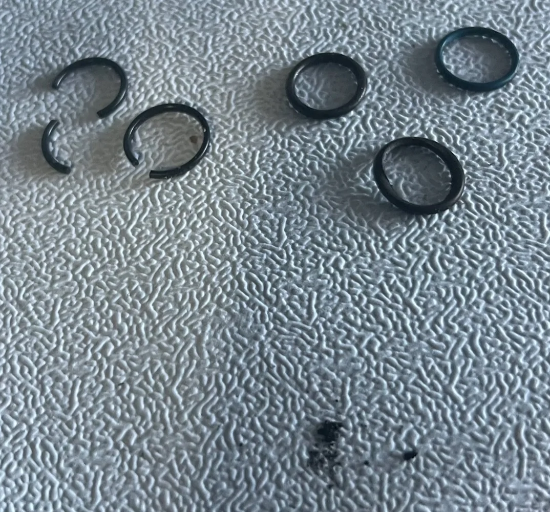

Did you ever figure this one out? Having the same issue currently when I’m at a stop.
I had the same issue as OP and thought it might've been overfilled oil, but it turns out my o-rings for my turbo lines were on their way out. It started as a very tiny leak from the turbo v-band clamp then gradually got worse to the point it was leaking on the ground. Some of the o-rings broke apart from just touching it.
