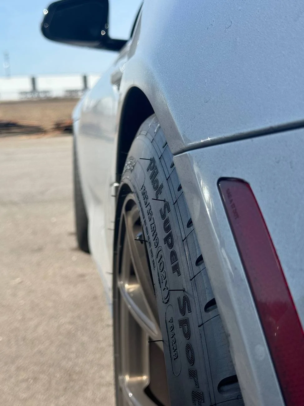

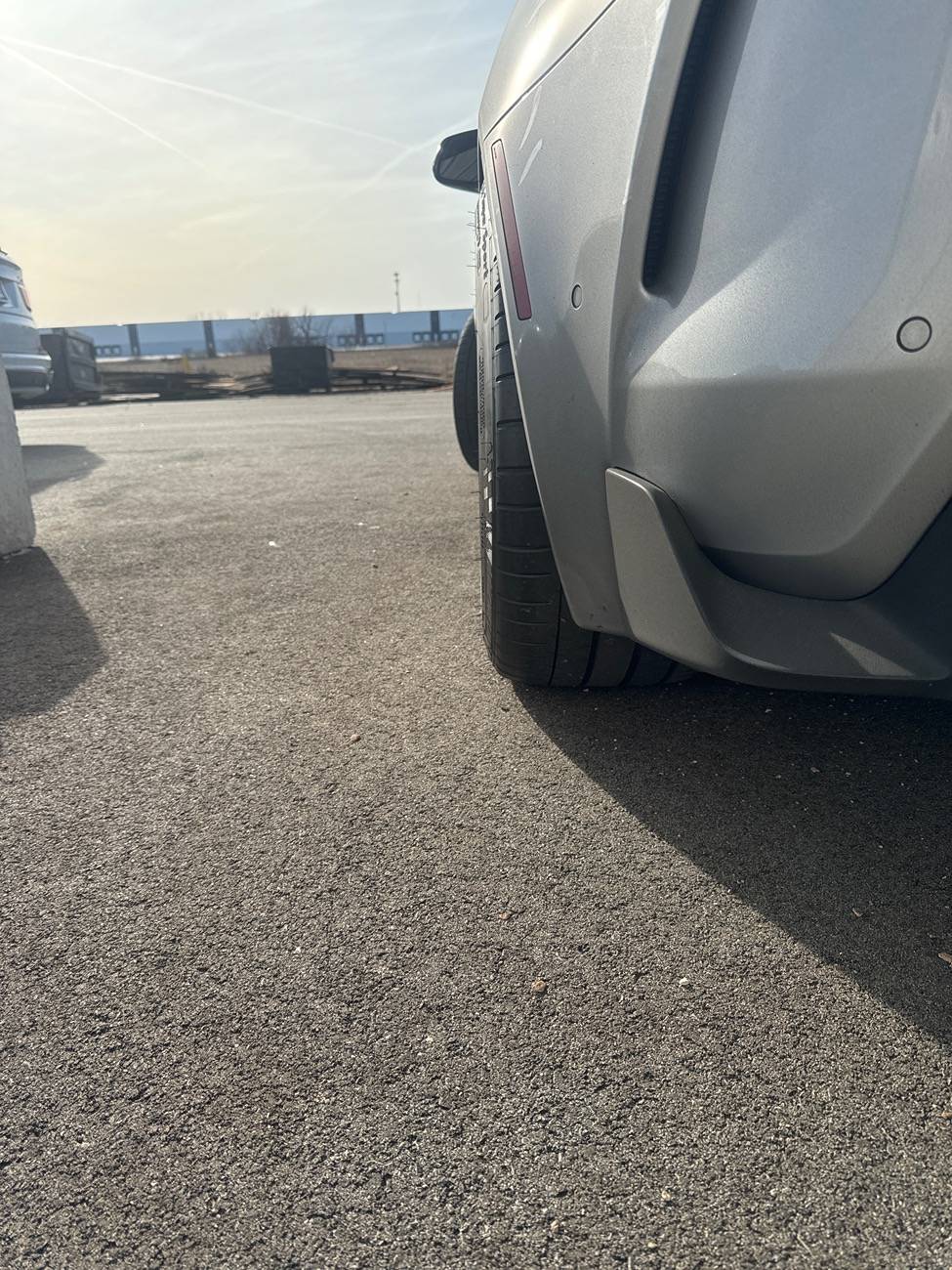

Hi Everyone, so I’ve got 19x11.5 in the rear wrapped in 305/35/19s MPS2, Looking to get a clean flush tire to fender look. What size spacer do you guys recommend to go for?
Thank you

uhhh i think you need lowering springs. wheel looks poking out without spacers already

From that perspective seems that the tire is already a few mm out.
find the specs of your wheels (need the offset) and I can tell you exactly what you need - if any - to get a flush look.
(I got a flush look measured with a laser level ?)

Wheels are a +35 offset in the rear and already lowered on swift springs

They are already past flush to poke. Are you wanting the top of the tire to be flush? Get wider tires so they aren't stretched.

I’m on 305/35 , how much higher in tire could I go? I just want the top of the tire to be flush with the fender. Or maybe a more meatier tire like a nitto nt555r2 or r888r?

A 315 or yes, a beefier tire. Michelins are known to run a bit narrow.
