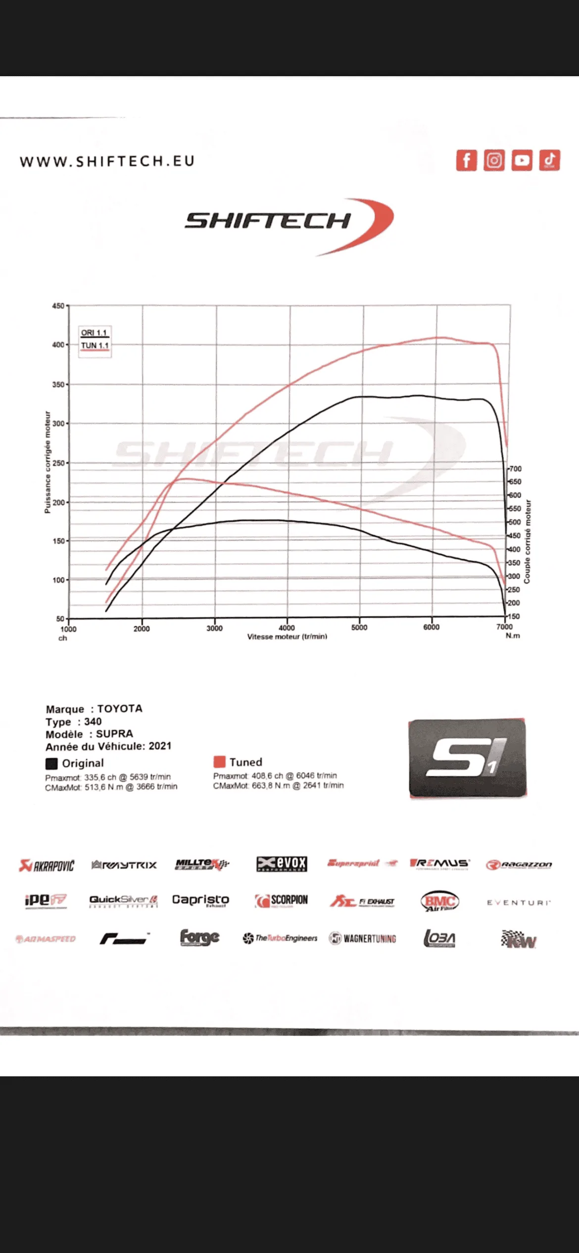

Hello my supra is now in stage 1 (after femto) with a catback Fi exhaust.
My question what do you think about my dyno curve? It’s good ? Dangerous for my transmission ?
Tell me everything i m newbee in tune ^^
And sorry for my english i’m french ?

What does stage 1 mean? If I'm converting my frenchie units to freedom units properly, it looks like about 400whp, 490wtq which seems pretty solid for just a tune (if that's what stage 1 means). That torque is a bit high though, maybe this also includes a downpipe? The curves look smooth though, and you don't really need to worry about the trans until 600+ wtq (800 Nm).

Hello in France stage 1 is just new map (i don’t have catless but i remove my GPF) stage 2 map + catless and stage 3 limit is the sky ^^
I don’t know how to calculate ch to whp.
Ok cool for the transmission :) and it’s little high for the torque ok, thank you for your opinion :)

Stage 1 just means he’s still catted but tuned. Fbo doesn’t really effect anything else tbh

On stock turbo and 98-100ron you won’t have any transmission issues.
Even upgraded turbo on pump gas I haven’t heard of the transmission slipping. It’s ethanol that kills the transmission with the torque but I don’t think you have that in France.

Thank you for the information, and we have ethanol in France :) but i drive with sp98 in France we have sp95 sp98 and E85

You should get a flex fuel tune in that case! So much left on the table with pump gas
