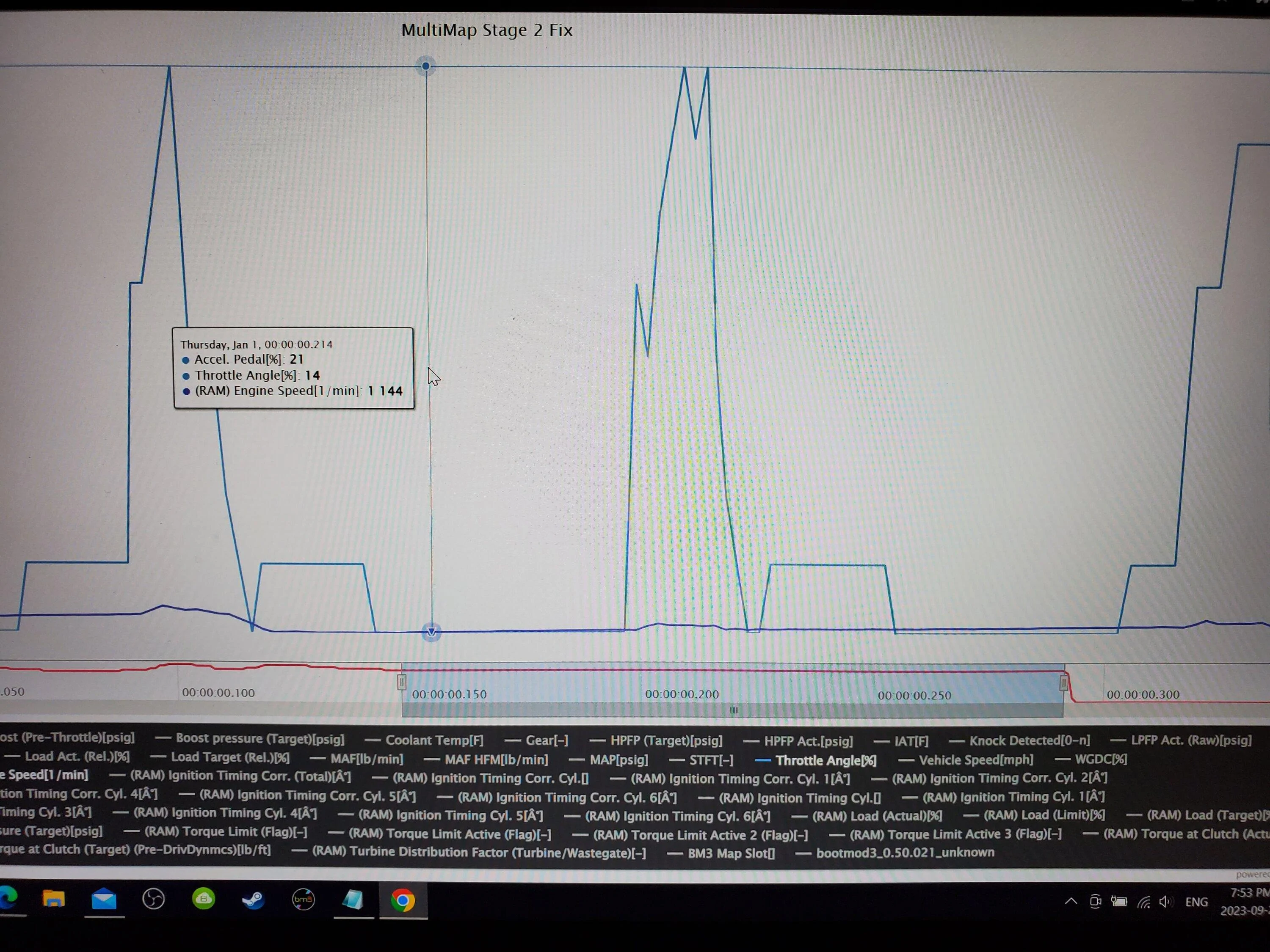

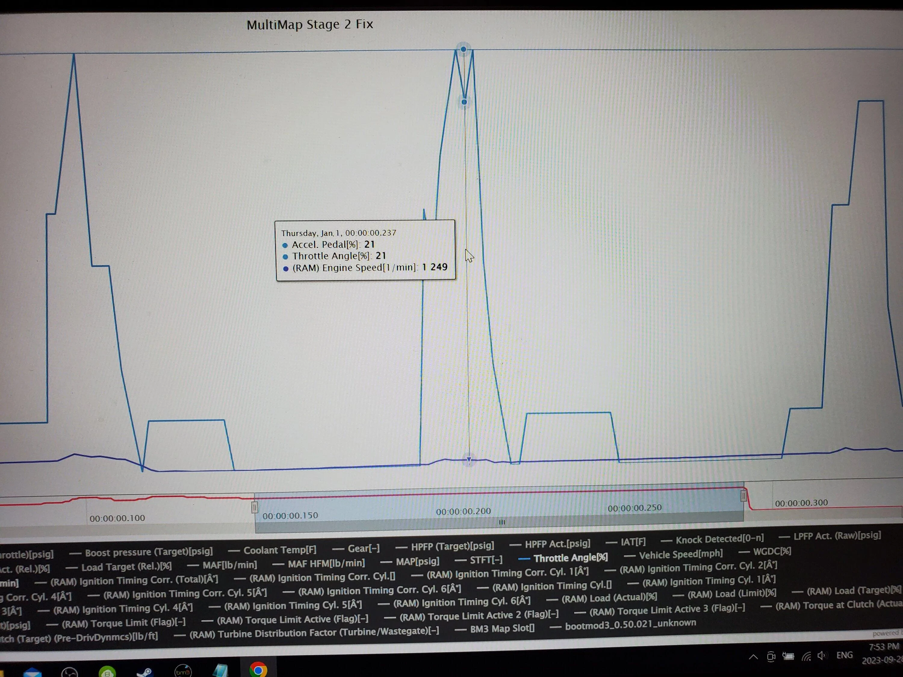

I've logged this and sent it to PTF. I have the same issue. Have you guys driven enough after flashing? Maybe it's an adaptation thing.
From these values you can only see the symptom but not the cause. I'll give my opinion and then we'll wait for the pros.
The job of the throttle valve is to regulate the boost pressure.
In this case there are 3 pressures: preTrottle-Boost, Boost Target and Manifold Pressure (MAP).
The goal would be to keep all 3 the same, which is not really possible.
The so-called boost deviation ( Target - MAP) is important: when this reaches zero or is negative, the throttle valve intervenes (closes) to avoid overboost.
In this case, in my opinion, the following happens - but be prepared, everything works as designedā€¦
( you can check my theory if you select the following values in your log: Boost (Pre-Throttle), Boost Pressure (target), MAP, Throttle, WGDC%,Accel.Pedal )
Pre-Throttle will be significantly higher than Target and MAP, which is why the throttle should stay in the 15-20% range.
MAP Will be quite a bit below target, which is normal. And WGDC should be relatively high so that you can react quickly when you accelerate.
For some unknown reason (and that's the bug / the cause), the TargetBoost will be periodically slightly increased. The MAP tries to follow and very quickly reaches the new target value because of the high WGDC.
And at this point (deviation zero or minus) the throttle intervenes.
And I think the wastegate also intervenes at that very high peaks, so WDGC should fall back sharply and then rise again.
The question is, what is the target boost at that time?
