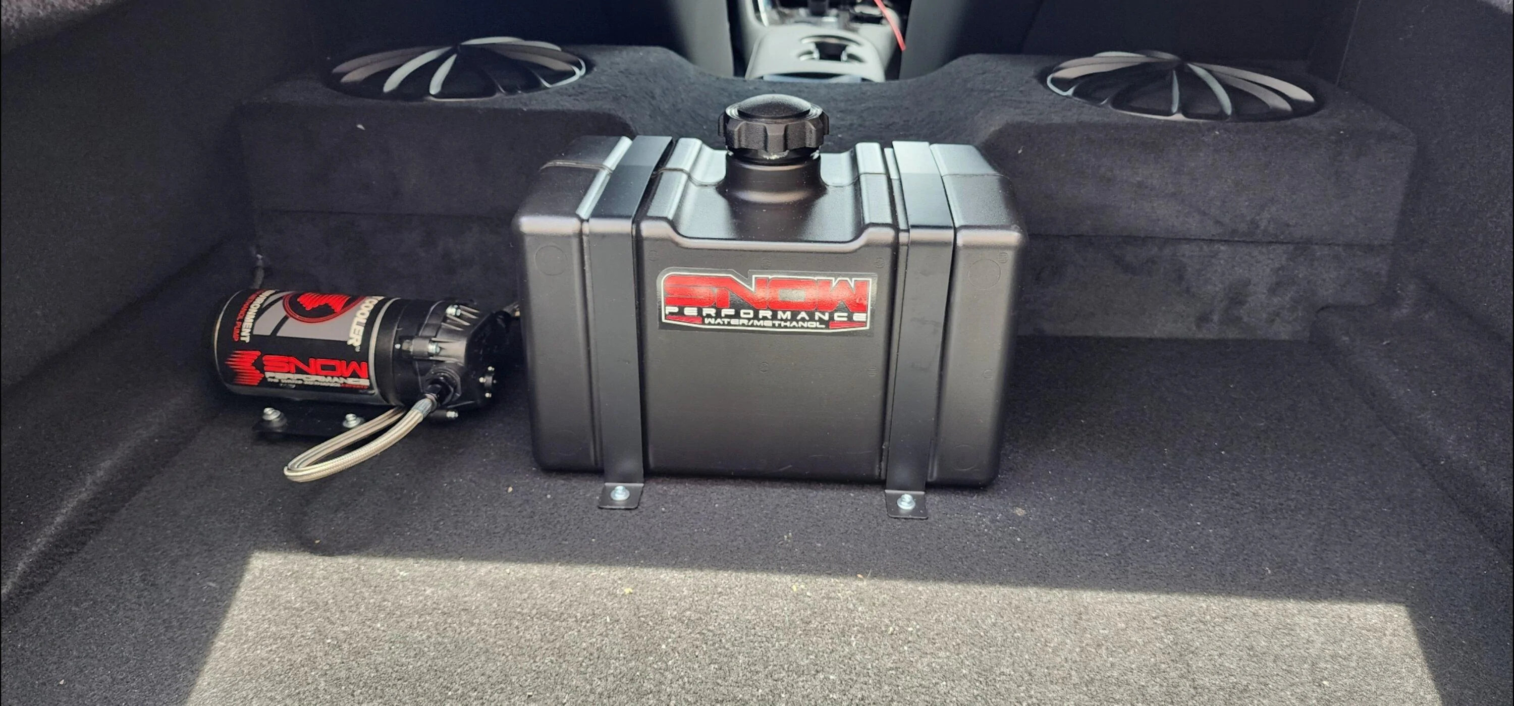

I currently run the same kit you're asking about. I ordered it from Throtl Performance for about 815 bucks. Including taxes + shipping, the total price came out to 910 dollars. It also came with a 2 gallon tank.... or atleast I think it's 2 gallons.... it holds a lot of meth :)

So a few things, if your kit comes with the big boy tank, it's going to have to go in the trunk as opposed to the traditional engine bay compartment spot for the smaller tanks many have used. If you're going to be running M1, I say it's better to have it in the trunk as opposed to the engine bay anyway in case of any fires, God forbid. In regards to the brackets, you're going to need them to hold the tank down in place. I'll link a picture of what mine looks like down below. In regards to installation, I didn't do it, my installer did, and he said it was relatively straight forward. But he's also worked with snow performance kits many times before.
