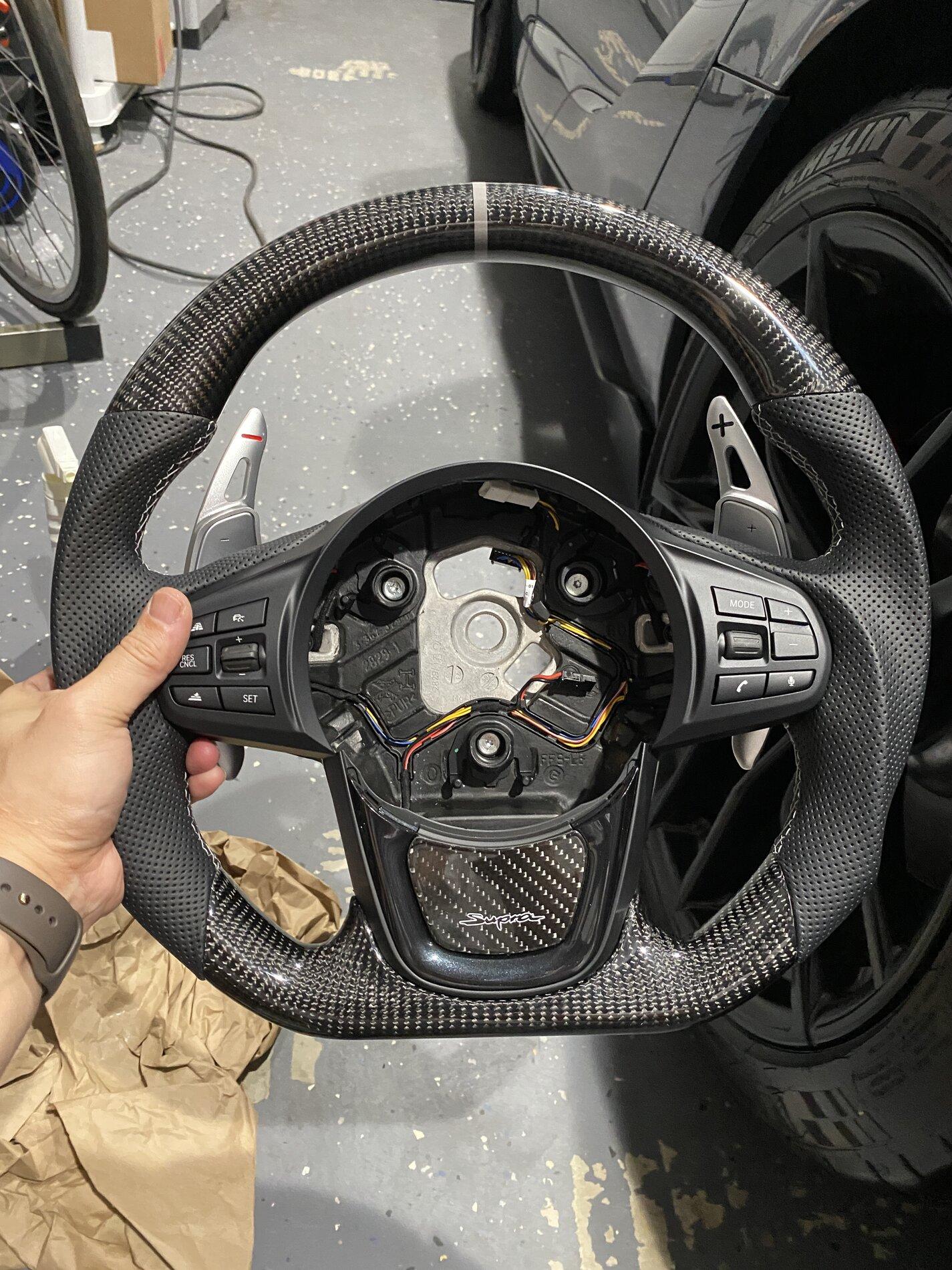

The splines matched up well but definitely hard to torque it down.
anyone only able to get the new steering wheel about 1/4" onto the Spline? Did you just use the screw and press the wheel on (assuming the splines matched up)
Got everything transferred over...just need to get the wheel back on the car.
Any tips?

Just put the bolt in and wind it in or use an impact driver .. had to use the impact to remove the bolt!

got it.....wish me luck. I'm only cautious since my stock wheel fairly easy to move off and on once the screw was broken loose with an impact driver. The new wheel just seems tight and I didn't want to force it.

Mine was the same...... I put some blue loctite on the bolt and wound her in!

I was worried about nothing. It went in easily when tightening down the bolt. Thanks
Mine was bought for $850 with no core exchange, but I really do think everyone does source from China
all the electronics and mounts carried over from the stock steering wheel with no issue.
