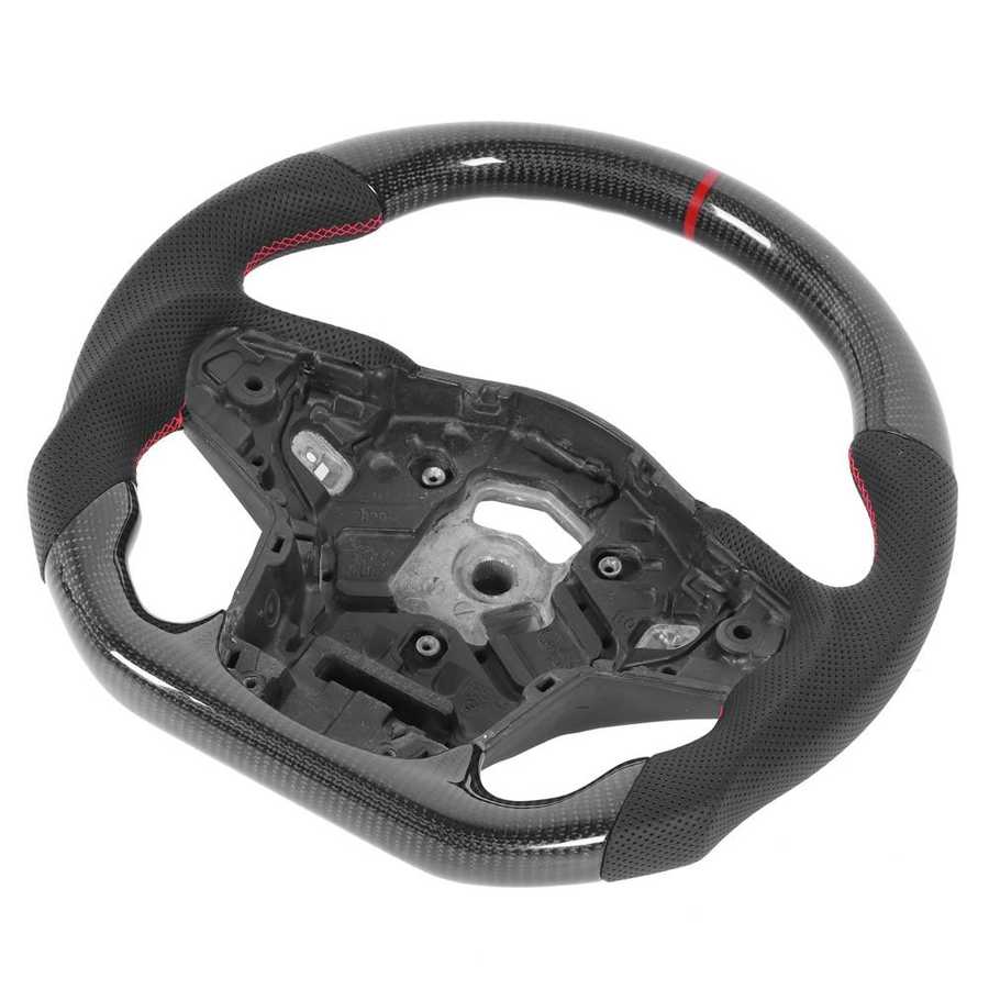

Aliexpress sells a supra model too....search for gr supra and they come up...you use all your hardware including your stock airbag...I ordered one yesterday! No core charge either! Also only mid $500 usd!

Aliexpress steering wheel...price today is 579 usd

Aliexpress steering wheel...price today is 579 usdice varies with currency fluctuations...is 579 usd today!
I checked it out - its very similar to the one I've seen on ebay which is significantly more. It would not be my first choice (stitching color and perforated leather) but the price is really hard to pass it up. Would nice if someone who's bought one can chime in. Quality is always a concern with Alliexpress.
I may get impatient and just order it. Do you think the diameter of this wheel is smaller?
Grip is thicker?

I just ordered it. What the hell. Its so much cheaper than anything out there. It arrives on 16 January should take me a week to have it on. I will send photos and report back

I'm fairly certain the Ali Express vendors will accommodate special orders, at least to change colors of stitching, center stripe, etc. as well as leather choice (Smooth, Perforated, Alcantara).
The dirty secret is most of the wheels sold by the established vendors are all sourced from China, and I would bet many of them are the exact same as the versions offered on Ali.
It would be worth writing the vendors to see if they can get you what you want.
I've got one of these similar wheels, and I love it. Totally changed the character of the car. Feels fantastic. I can't stop looking at it everytime I get in the car. Highly recommended upgrade.

I got my wheel today from AliExpress.....was perfect and looks exactly like the illustration.... hardest part is inserting the 3 black plastic inserts ....I lubed them first with dish soap and very carefully pressed them in with the colared screw (Very snug fit.....can't stress this enough!) . Great buy for sure....I'll pass on a corvette tip and link later to fabric pen the stitching on the dash and seats to red too!

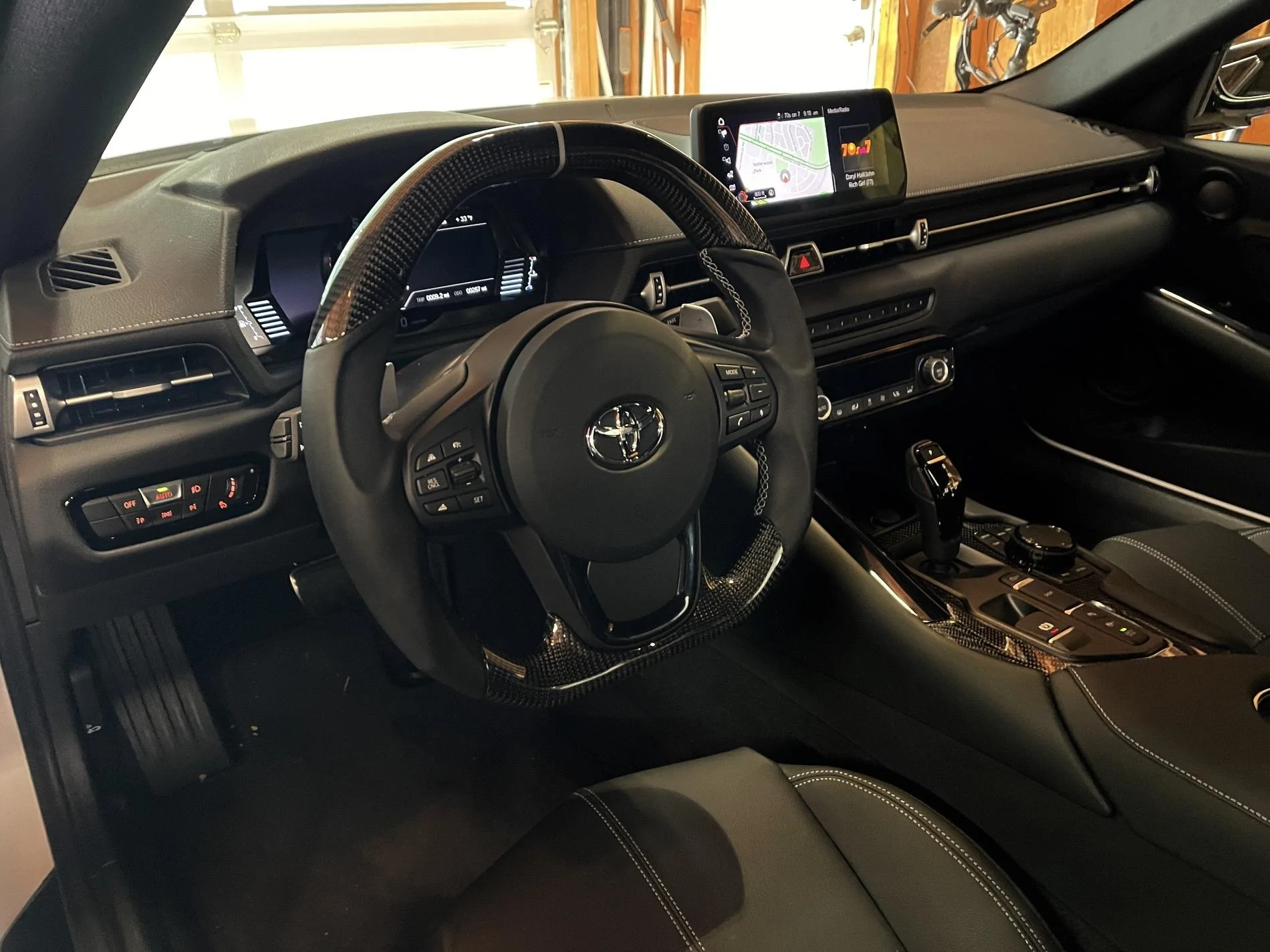

Man I wish I found this thread and these ALiExpress steering wheels before I installed my wheel! I went with a local vendor and spent about $800 and have had it for a few months.
I definitely agree this is one of the best interior mods on the car. Great job for you guys that found them so cheap! The install was definitely a PITA...We had a hard time removing the airbag and completely f**ked up the airbag removal bungs on the stock wheel. The splines matched up well but definitely hard to torque it down.
Next owner will have a nice wheel :rolleyes:
