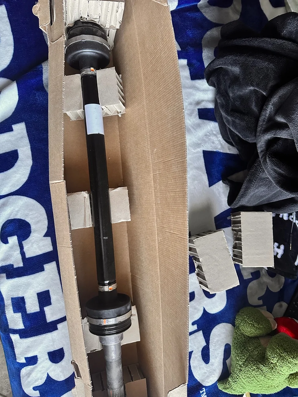

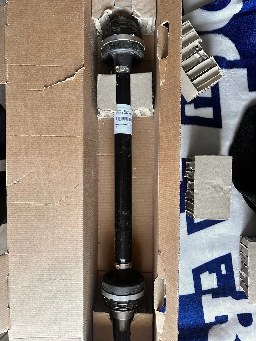

Just want to confirm if anyone has bought parts #42340-WAA06 and #42330-WAA07 rear axles. Here are some photos below for reference I want to make sure I didn’t get 2.0 ones or something.. dealership sucked at helping me confirm part numbers when I placed it.

I’m confused because these boots look different and I’m unsure if they changed the way the boots are now on newer axles…

check the 33 20 5 A74 ACX part number. that is the BMW part number.
it should correspond to Z4 40i or equivalent. I am 95% certain the axles are interchangeable for b48 and b58
* as per chatGDP
The part numbers 42340-WAA06 and 33205A74AC7 refer to the exact same part used in specific Toyota GR Supra, BMW 330, 430, and Z4 models.
I'm pretty sure I remember running across a thread at some point where it was confirmed the new axles have updated boots.
