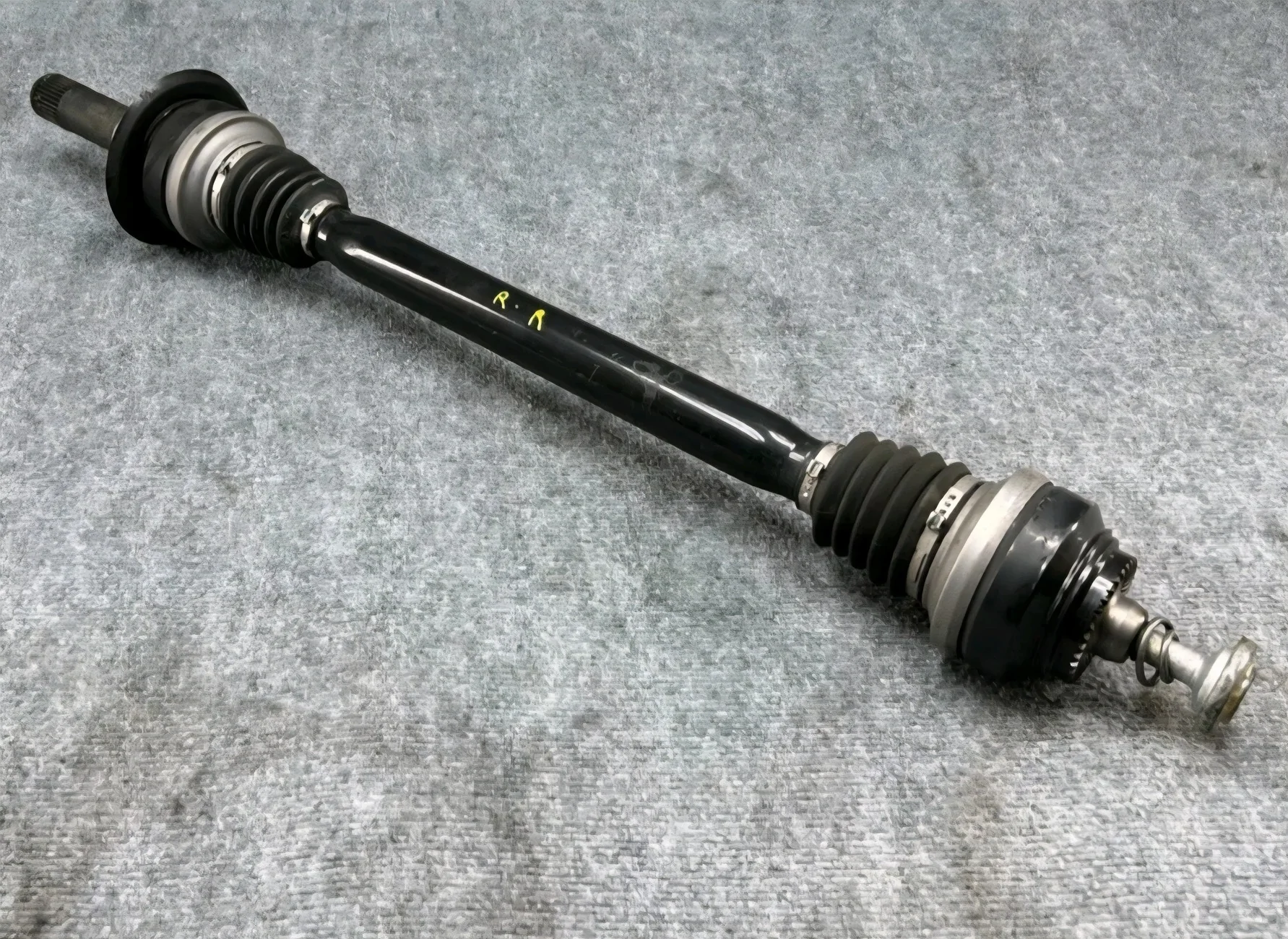

I don't know definitively how much better 2026 supra Axles are but I bought a set for cheap and they look improved.
MisterSkiz
Apr 29, 2021
1,121
1,720
Chicagoland
You would have to pull them apart and look at the cage that houses the bearings, usually that is what grenades - not the actual metal axle or splines.
Loco38SUP
Feb 17, 2021
55
2,372
3,435

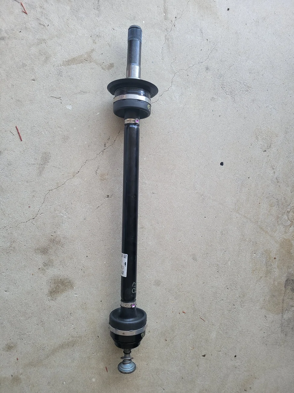

Someone else recently posted a side by side since they thought they ordered the wrong part. Here's one.
The shorter boot and distance from the shaft taper to the start of the metal housing certainly suggests they’re mechanically different.
If someone could open up both to compare we would know for sure.
