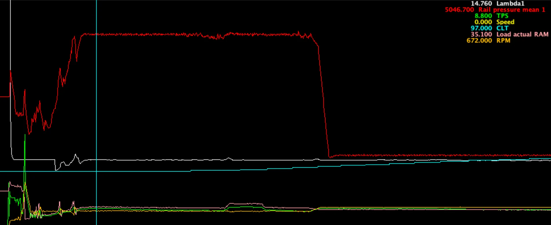

Supra B58 Need Help below:
8,816
17,303
https://datazap.me/u/ndtheact/2?log=0&data=4-25
Don’t mind the spike I pressed the gas to bring the idle back down to its range as it sometimes kicks up a bit in the middle of 0 and 1 on tach
Railpressure looks fine. Saved you $100. ;)
Your long term fuel trim (LTFT) is at +5 though. Scalar/airflow tables could use some TLC.
Can you log VANOS Ex and In requested (vanos ex req. / vanos in req.) in your next log? You already have actual, keep those logging as well.

2020 Supra 3.0 Premium
How can I fix the LTFT? I will log once I am off the clock later this afternoon here in Cali and will reply with link. Thank you so much!

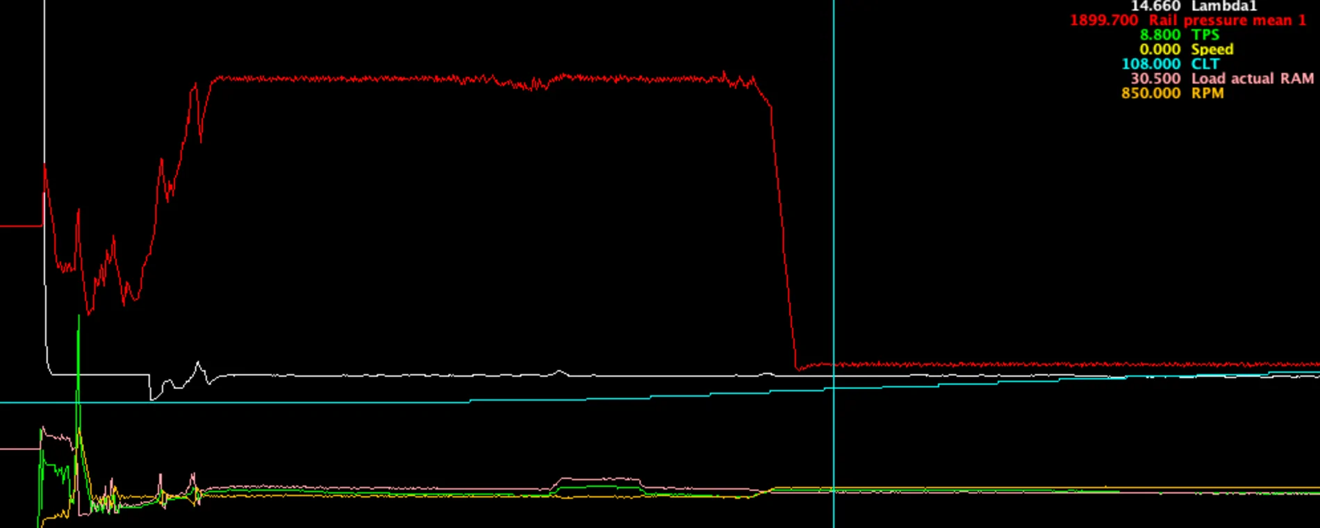

https://datazap.me/u/ndtheact/vanos...-8-9-11-12-14-15-17-19-21-23-24-25&zoom=0-501
Here is a log idle after cold start as I just sat in the car it was acting up a little bit but it’s more so at cold starts like I said:(. If you want I can log in the morning again for that if you don’t see anything concerning. I’ll send the cold start idle in a moment. Thanks!

Everything looks normal to me. Did it do the stumble during this log?
Not really let me log again tomorrow morning on a cold start I’ll reply then! Thanks!
Here is a link when the car idle stumbled:
https://datazap.me/u/ndtheact/idle-stumble?log=0&data=25
Here is a link when I felt the idle was unhappy like it was about to stumble:
https://datazap.me/u/ndtheact/light-stumble-unhappy?log=0&data=4-25
Here is the cold start as you requested:
https://datazap.me/u/ndtheact/cold-start?log=0&data=4-25
I provided 3 logs, today I did in them in the morning. First link I did catch the idle stumble pretty drastically. Let me know if you see anything RazorLab:). Again thank you very much for helping me!
