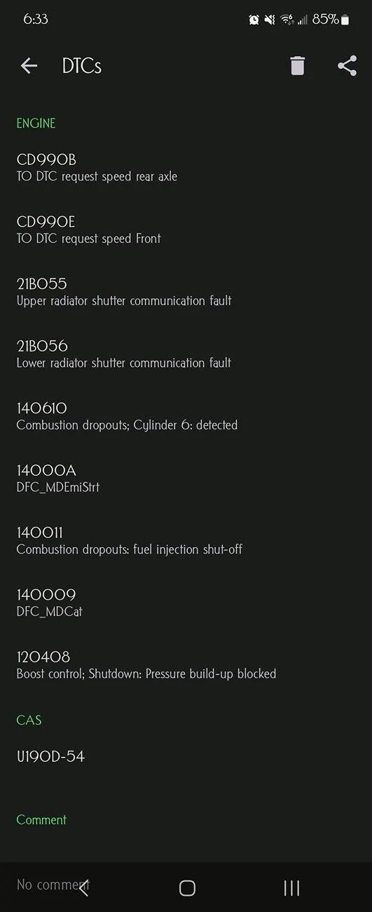

Driving down the freeway today. All of a sudden I hit the throttle car starting feeling like it was sputtering, kinda shaky everytime I hit the gas. Check engine light comes on and I get a drive train warning. At idle car shakes and it's giving me these codes. First time in 2 years it's done this. Any idea?

Yea got off the freeway, let it sit for 10 min, checked to see if I could see anything loose or not connected. But same thing. Starts up and its slightly shaking, still in limp mode. Same codes

I pretty much always keep it right under E50. currently at 44. but i've gone over a few times. so maybe the injector is done. I'm just going to try replacing the injector. I did put some 91 in this morning and drove to work but the problem is still there.

I'm thinking maybe its the injector and why it feels like i'm getting a misfire in cylinder 6. So going to start by replacing the injector and seals
