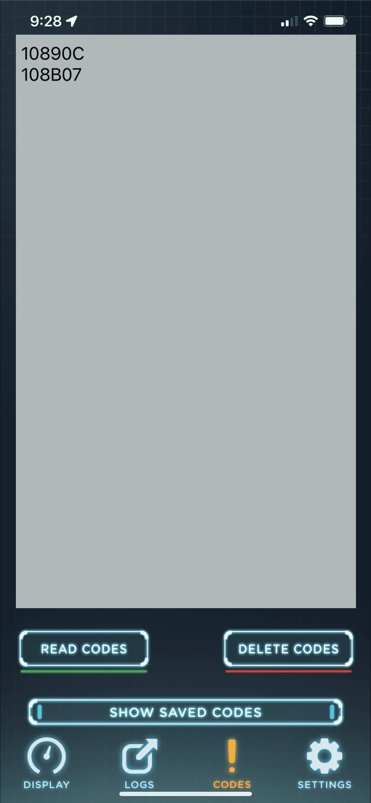

I know the bottom code is a map temp sensor, I have a new one on the way, can someone tell me what the top one is? I googled it and came up with nothing…

CEL, I actually found it on bmwfault.codes. If the new sensor doesn’t fix it I guess I’ll have to look into wiring?

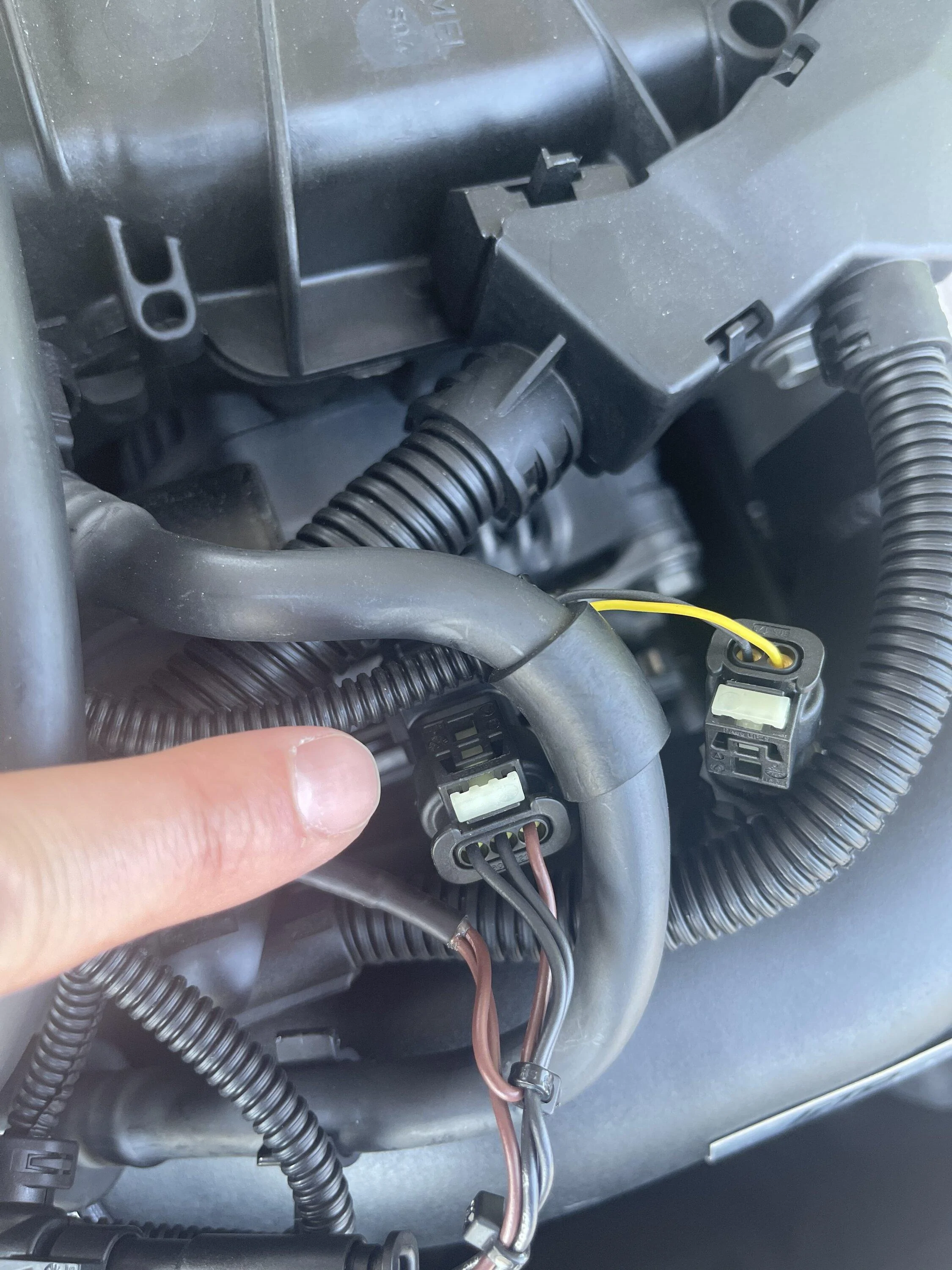

@zrk yes they do, I’m hoping it’s a bad sensor…I did have the connection on the charge pipe, so I guess I couldn’t over heated it and fried the wires?

Have you tried to unplug the sensor and see if the code changes?

@MYA90SUPRA you mean unplug it and then start the car? I didn’t, I can tho if you think it’ll mess anything up?

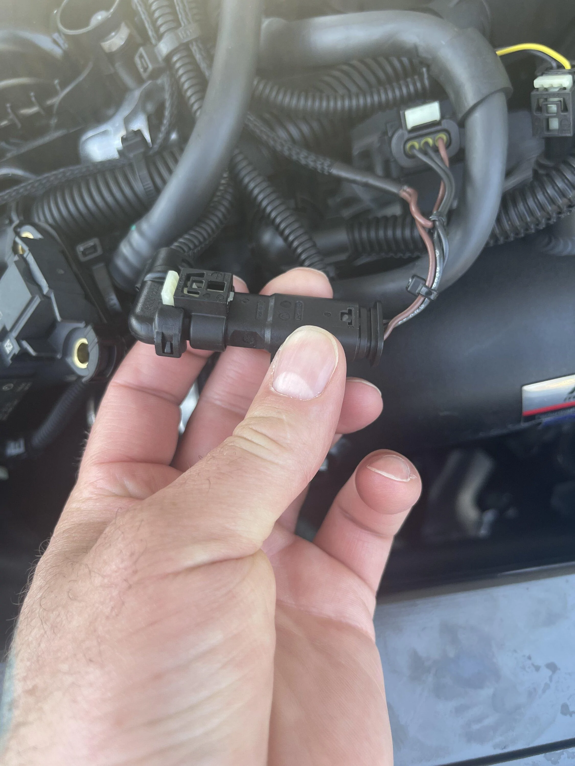

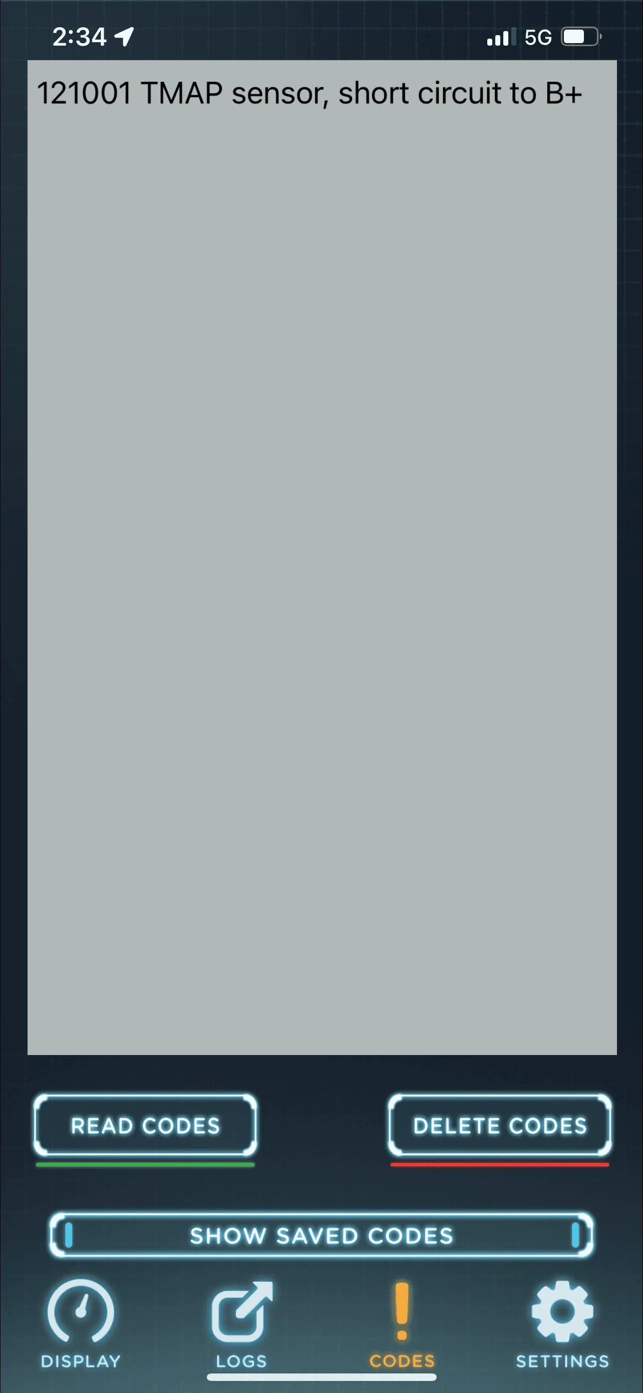

I unplugged the below pic connector and started it. I didn’t get a code.

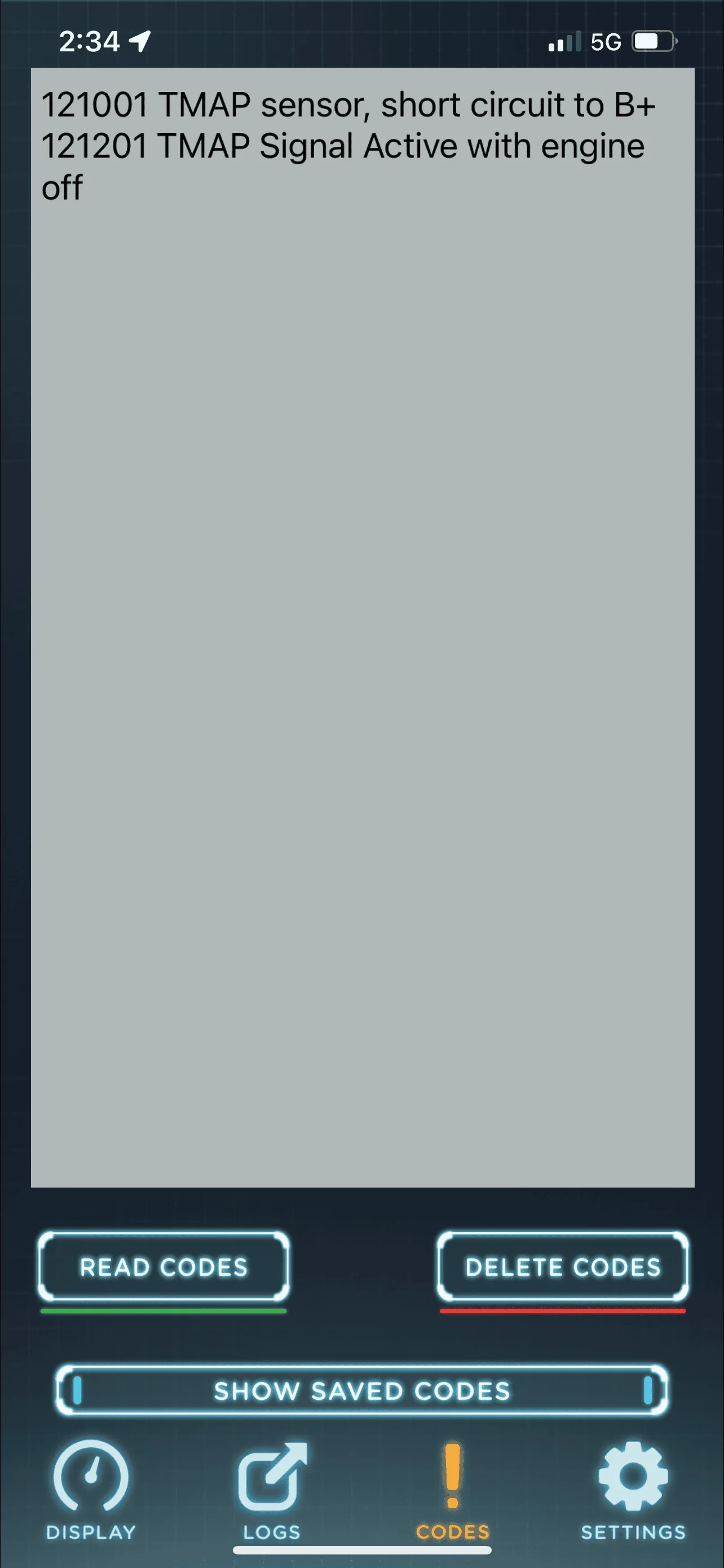

then I additionally unplugged one below and got the following codes
Yeah unplug it and see if the code changes. It's a troubleshooting technique. If your code changes from shorted to voltage above normal most likely a bad sensor. Well cat troubleshooting technique, but I would think bmw and other car manufacturers would be close.

What about “TMAP signal active with engine off”? Any idea what that means?
