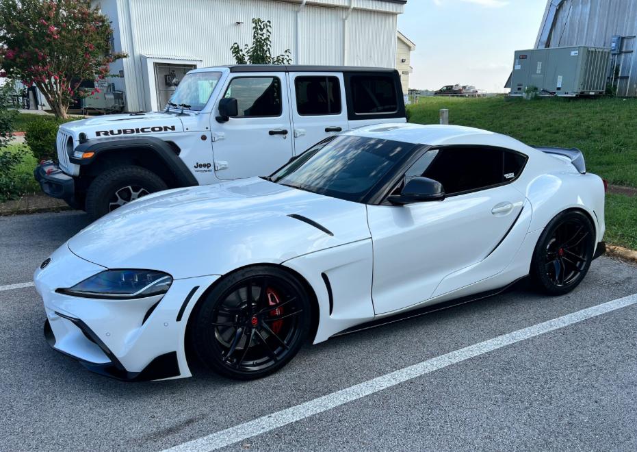

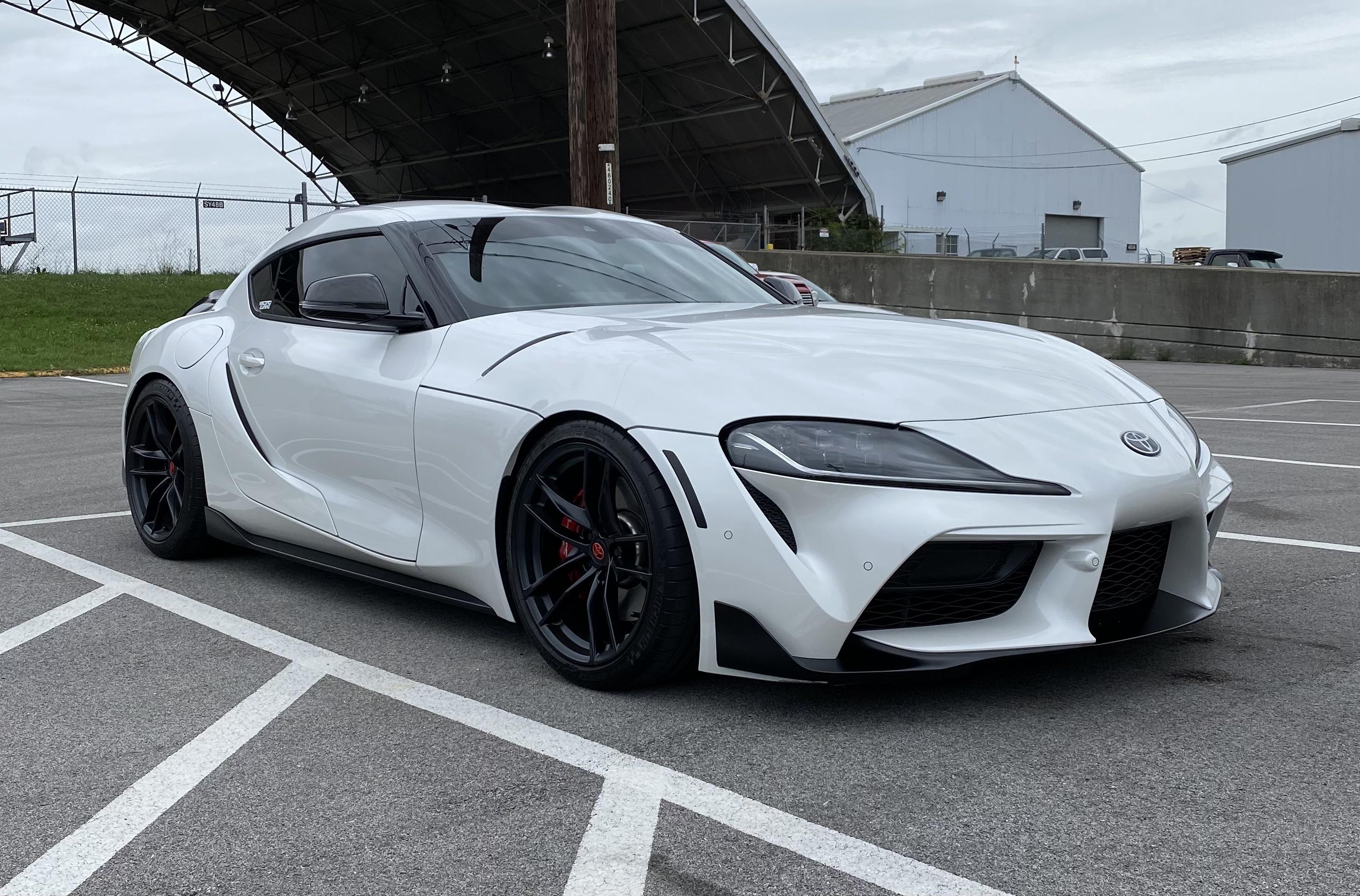

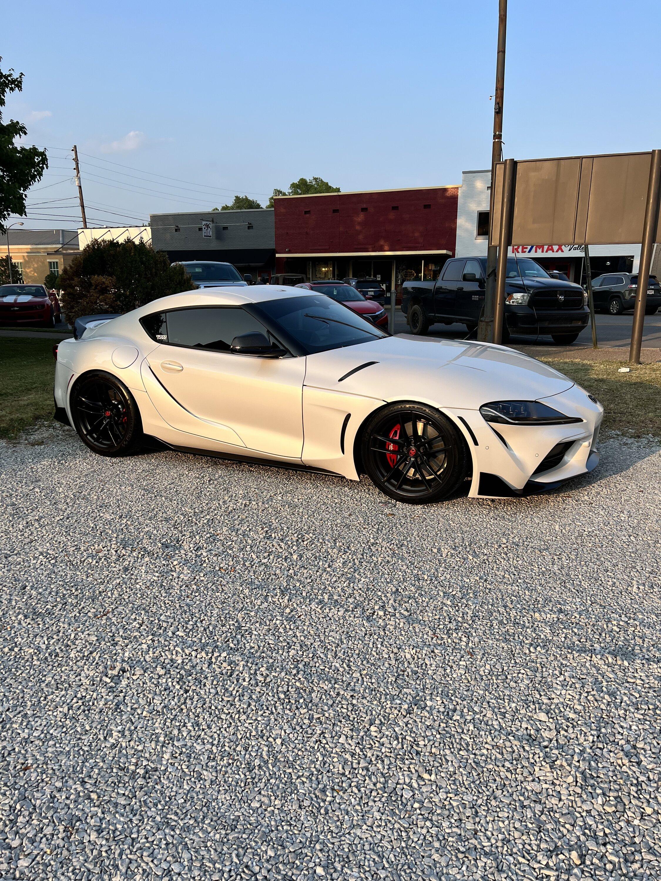

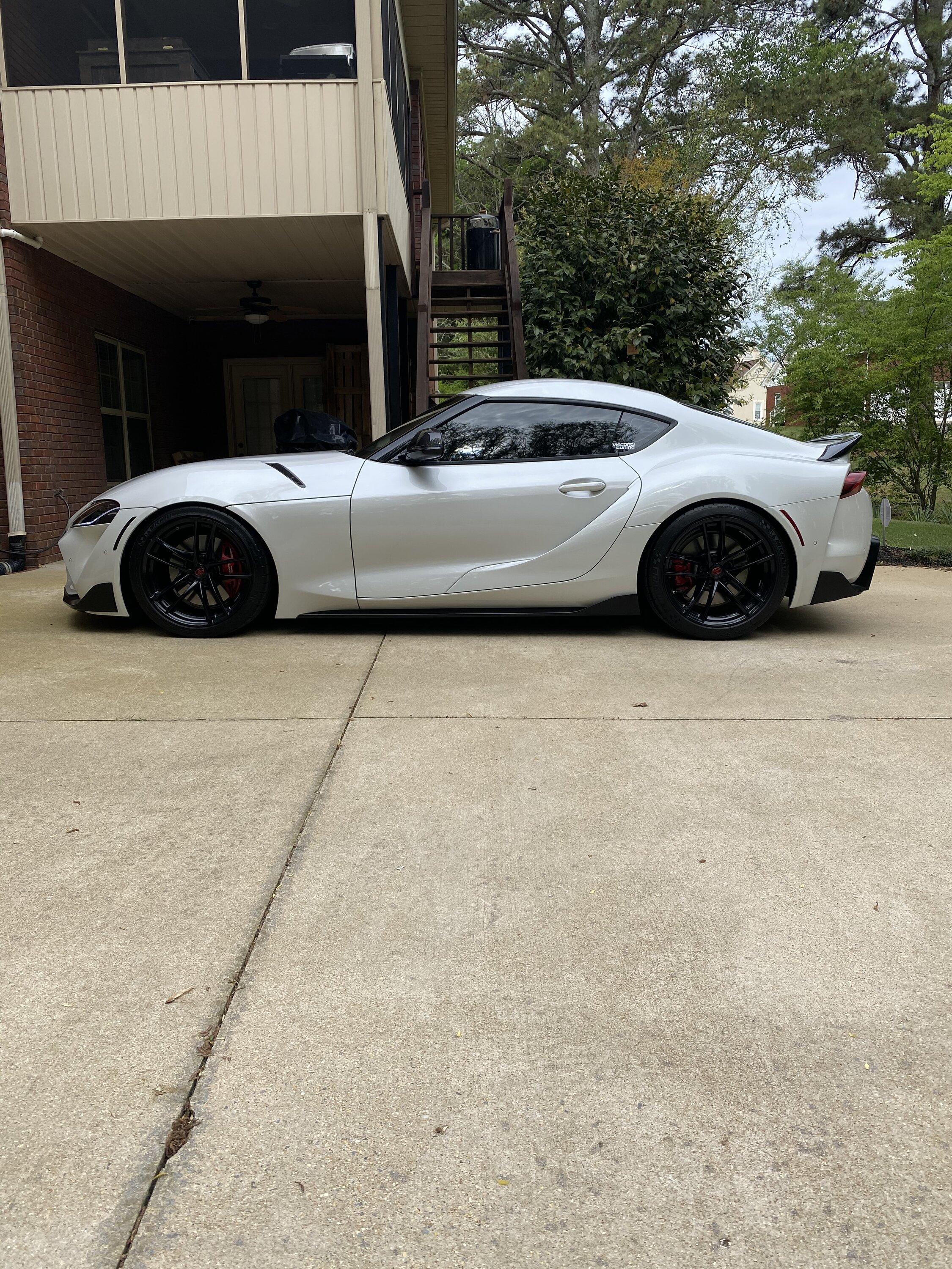

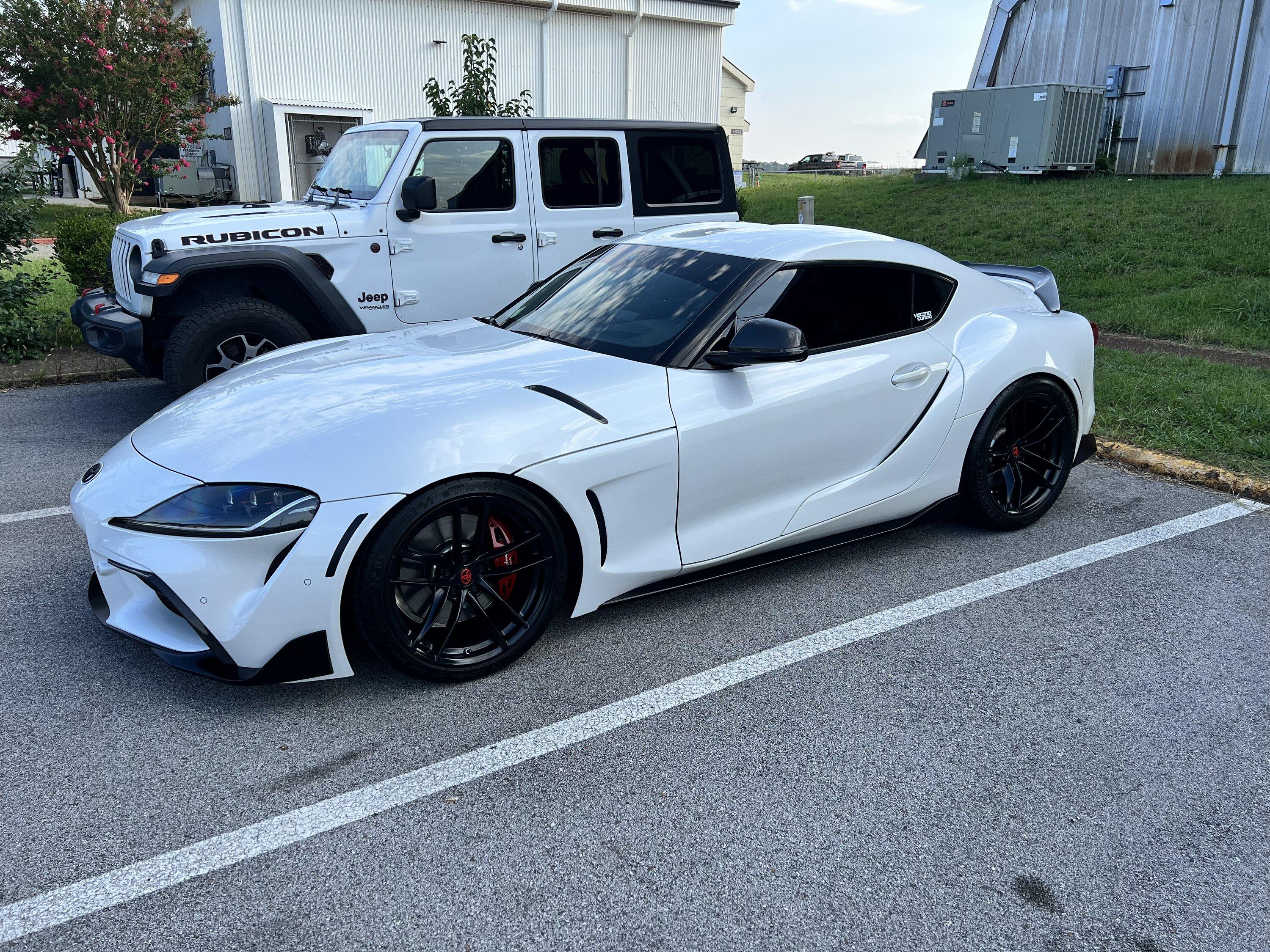

Awesome! Seems like a common pain point for some. How is the car driving? Still feel and sound ok? Happy with the springs? Are they the Swift R springs? Any pictures?

I have maybe 150 miles or so since I reassembled everything. No noise. No pops no grinds. Silent. ?
Very happy with springs. They are Swift R. Everyone was getting Eibach at the time, but I wanted a little bit more of a drop, just from springs, which Swift offered.

Good looking car swift is definitely the way to go! Have you experienced any rubbing at all?

Thank you, sir. No rubbing. On spacers front and rear, 13and 15mm BM. Front is 255/35/19, Rear is 295/35/19’s.

Thank you, sir. They did turn out well.
