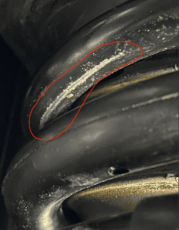

Long story short. I purchased Swift Springs which come with one silencer for the fronts. Had them installed by a mechanic who has a ton of experience with M, RS and 911’s. Ride quality is still is OEM but sportier and less body roll - what you would expect from aftermarket springs. However, driving home I heard metallic sounding clicking/clunking sounds when going over bumps. Brought the car back to my mechanic and he found the top coils on the front were missing paint from binding. We adjusted the silencers upwards to fix the issue but there was still binding. Reached out to Swift , diagnosed the issue and they sent me an additional silencer for the fronts to fully wrap the top coils. Now, everything is all good. No noise at all. Kudos to Meraki and Swift from good customer service.

I had the exact same issue! The front would clunk and click it was super annoying. My mechanic wrapped the top half in silencer and it's much better...You can still hear it here and there but it's way less now.
Honestly I am thinking of just switching to coilovers. The sound is not very confidence inspiring.
