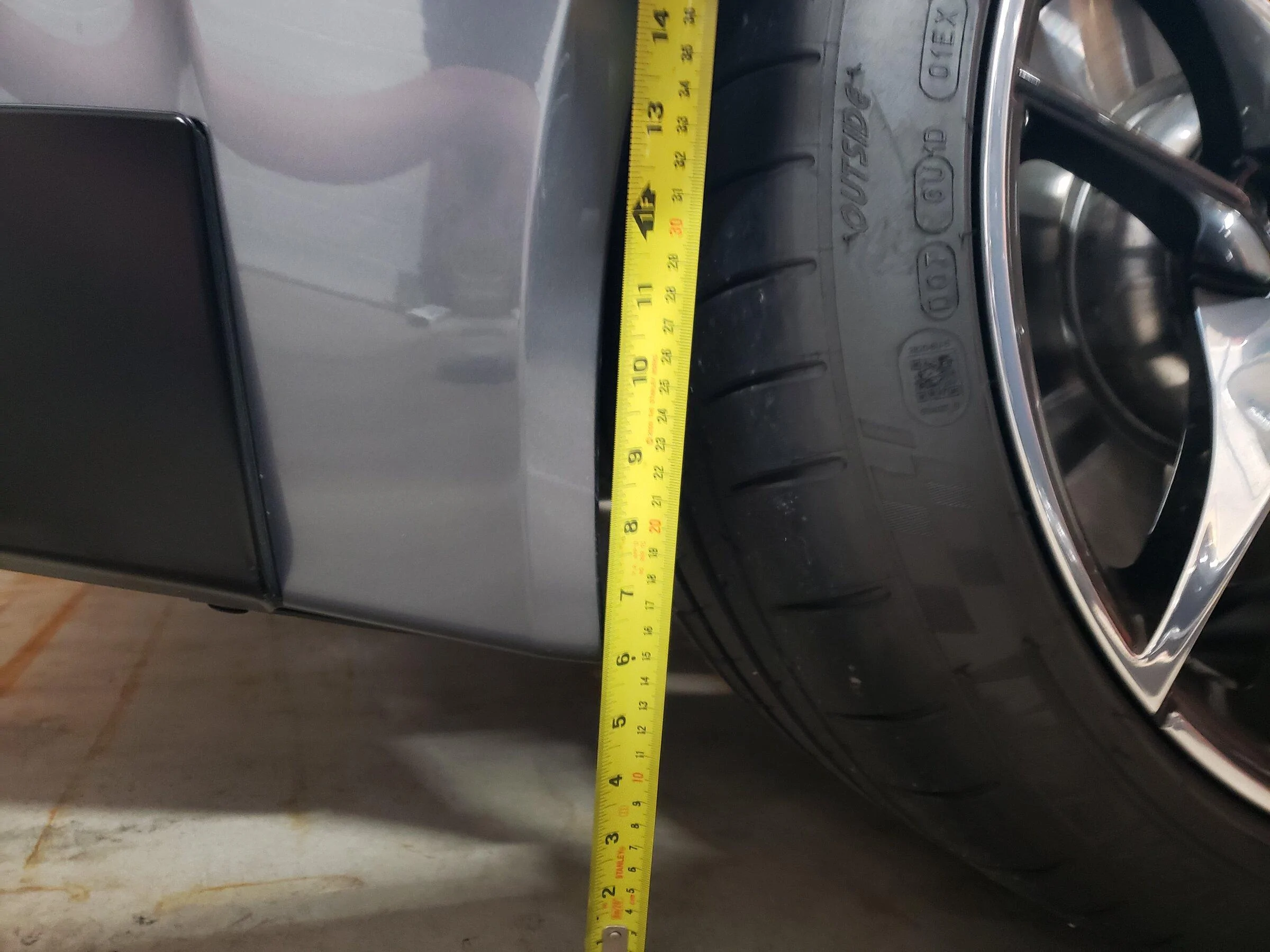

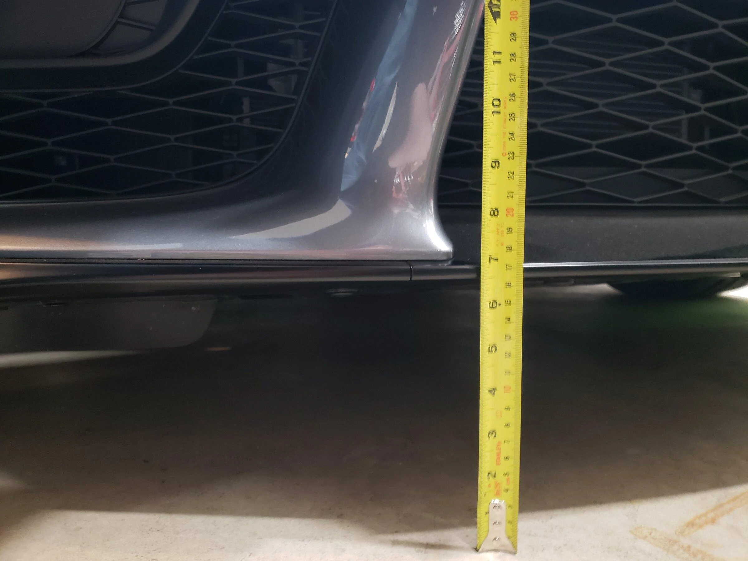

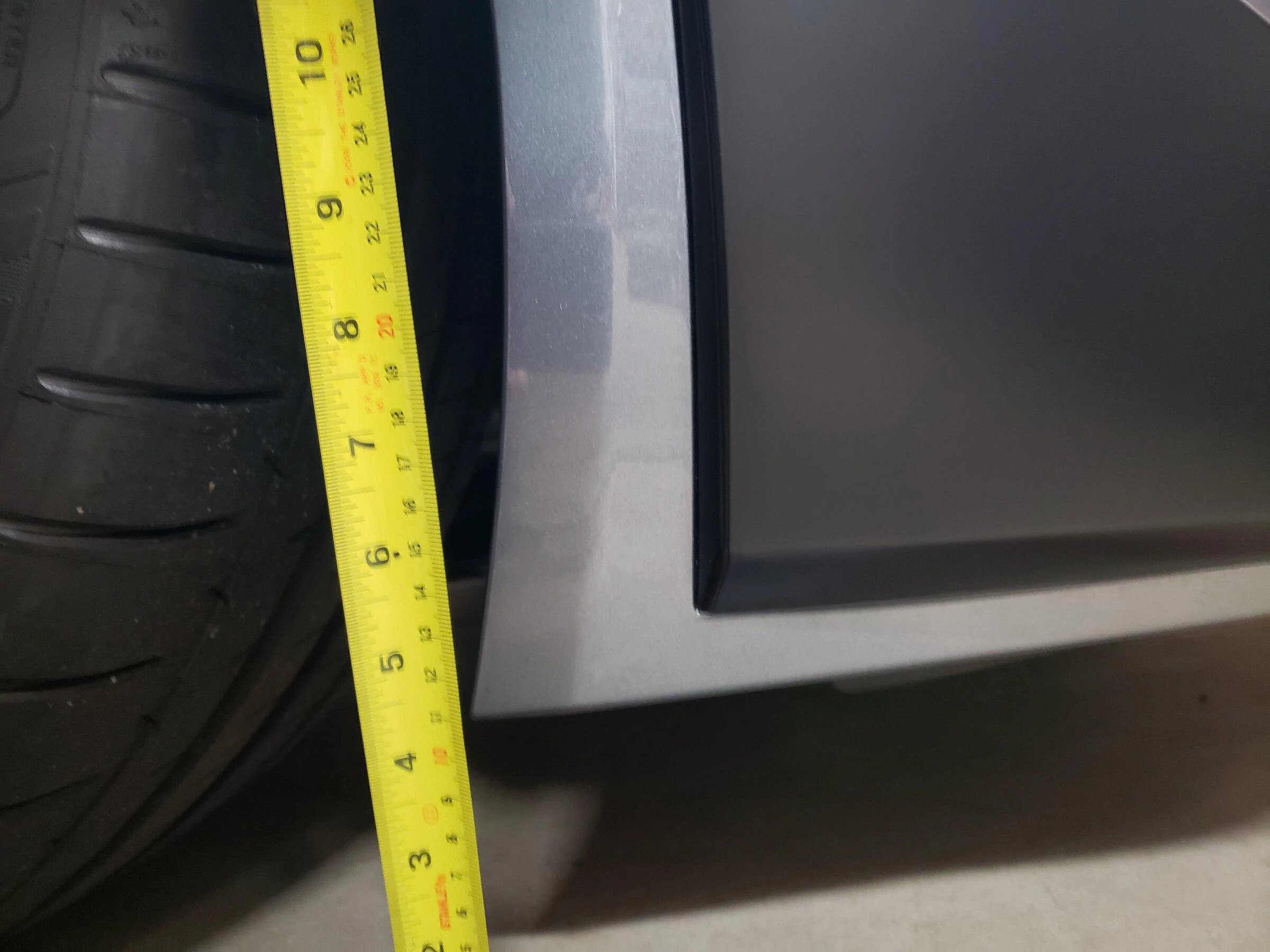

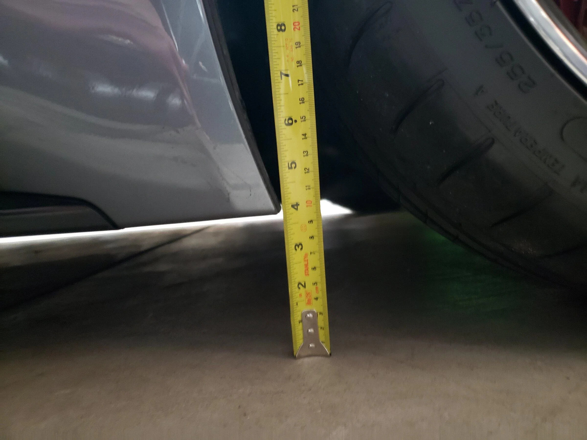

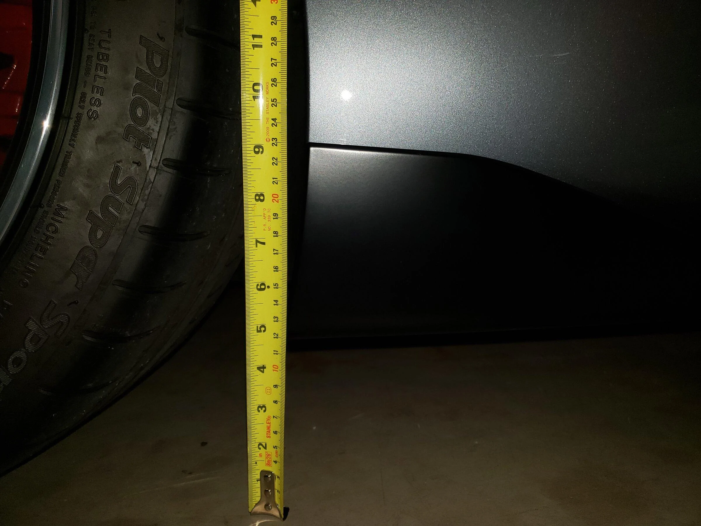

How much ground clearance do you have with swift springs?
MisterSkiz
Apr 29, 2021
1,110
1,701
Chicagoland
I have swift springs, just ran out to garage with a tape measure for you. XOXOXO
MisterSkiz
Apr 29, 2021
1,110
1,701
Chicagoland
Lowest part is the front fender where it curves in towards ground.

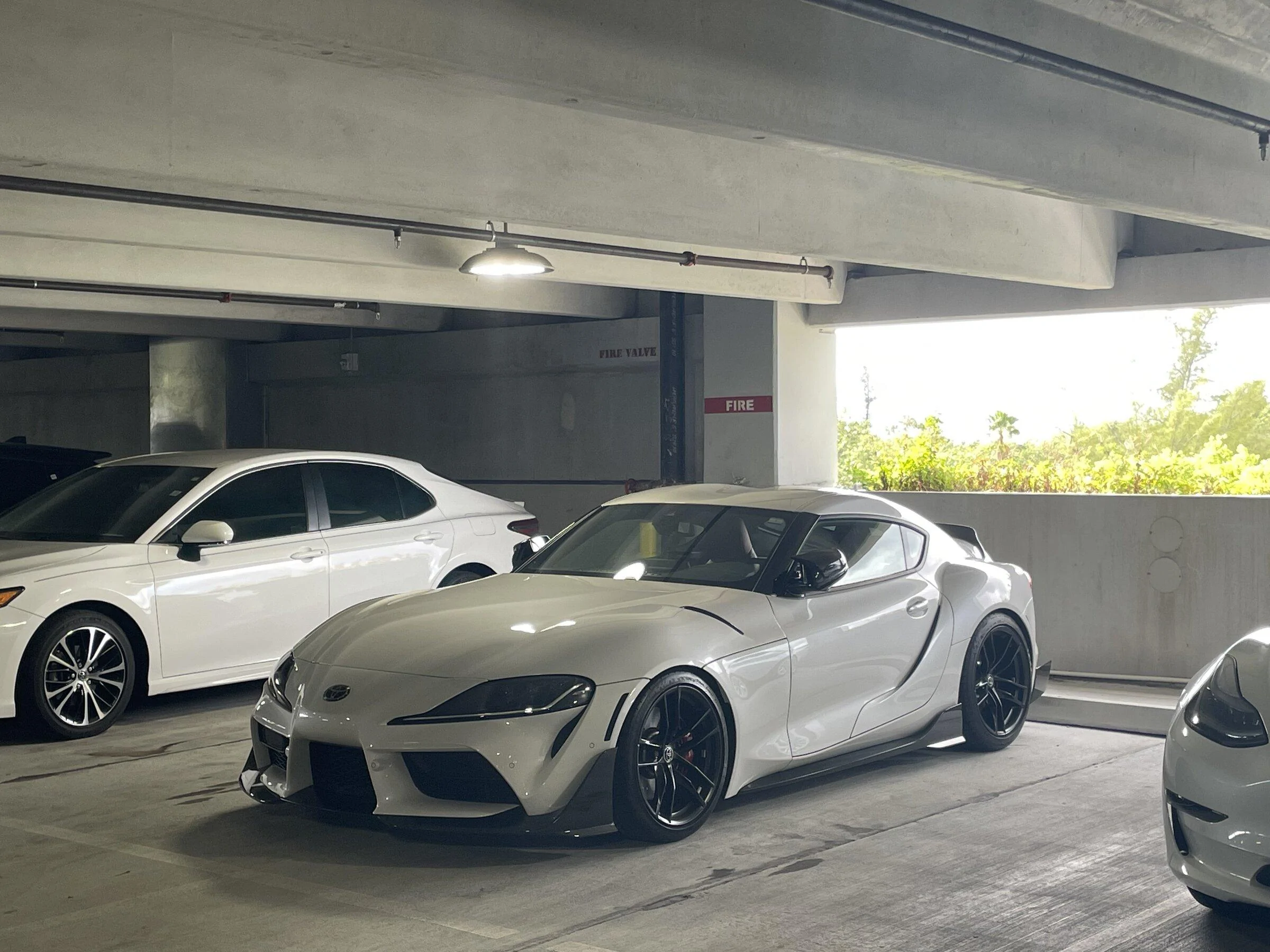

Vuuduu
Apr 14, 2022
79
67
DFW, TX
2022 Supra 3.0 Premium

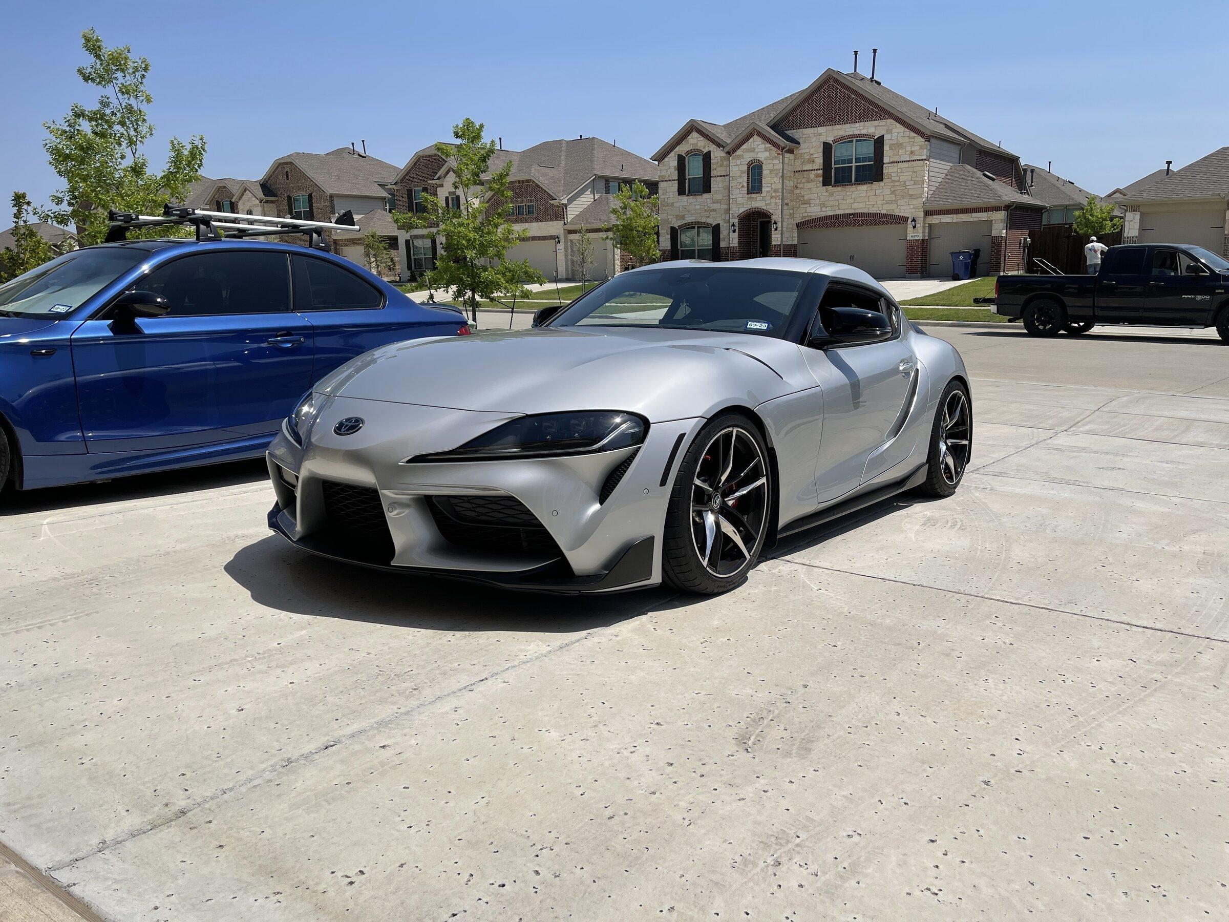

Installed with a friend at his house. Stock wheels with 13/15MM spacers. Pic was taken right after install (no settling time), Also on an incline.
Put over 100 miles so far. Rides well. Steering feels better.
