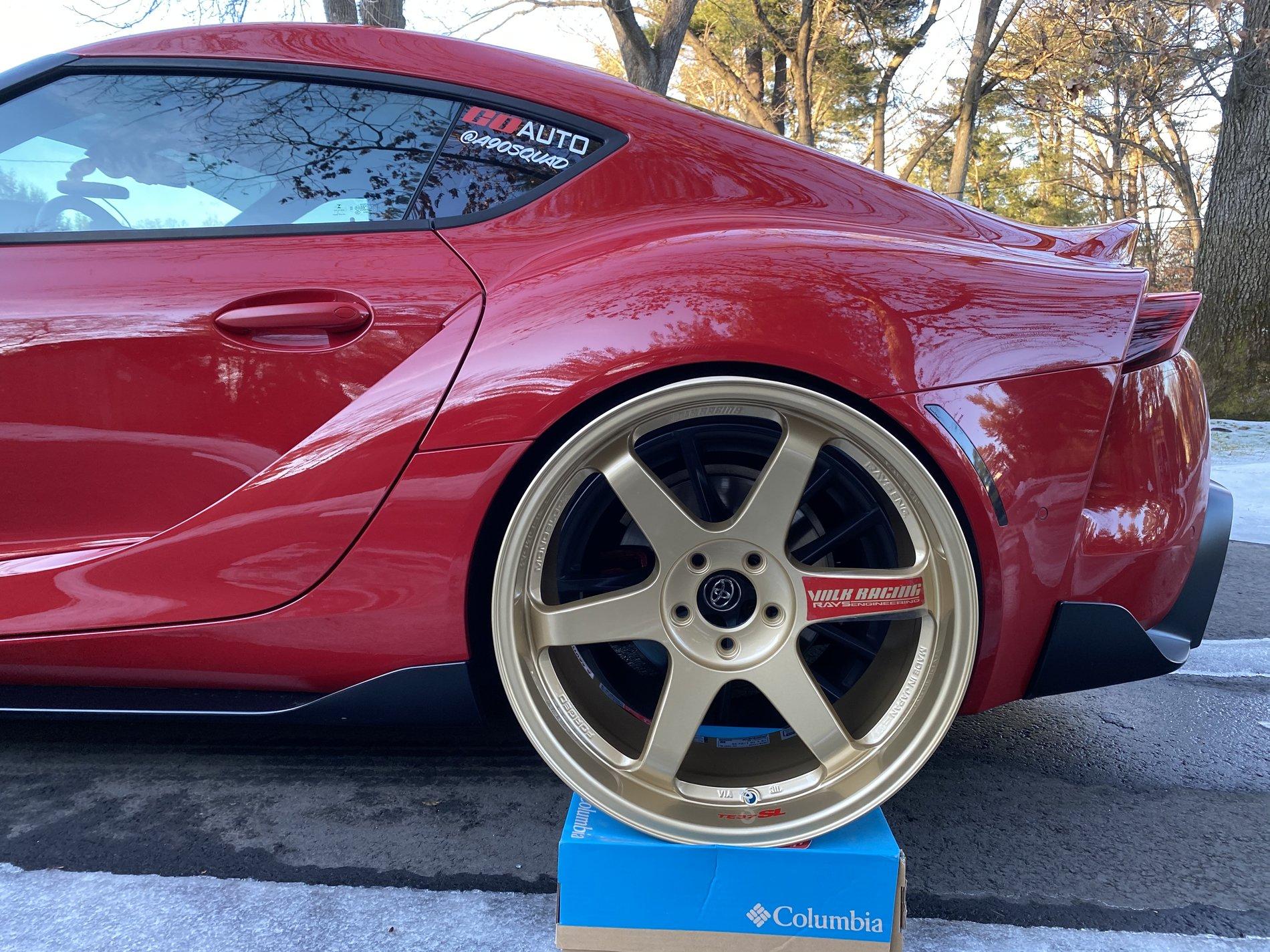

Very excited to get some rubber mounted on these!

Either cup 2 or r888r for tires
305 (test fit) rear
For sure 295
Front 285/275
Excuse my impatience, when do they arrive & get mounted (tires)? lol damn they’re gunna look good
I can pick up the 275/285 any time I’m just waiting to hear back and see if I can get a pair of 305s to test fit on the rear.
That’s my main goal for tomorrow.

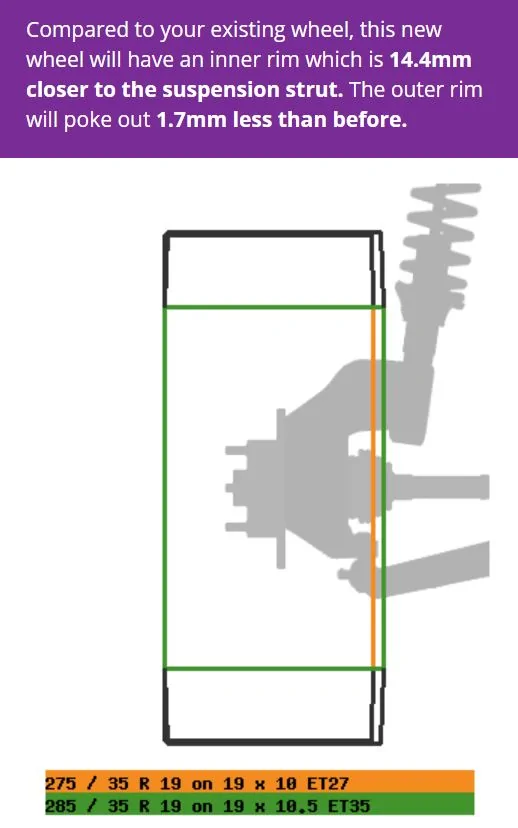

Has anybody thought about running these in 19x10.5 all the way around? I like how the 10.5 wheel look than the 9.5.
Exactly! I thought I am the only one who didn't like the 9.5 fronts.
I am currently running H&R springs with a square setup (10" all around) with 13mm spacer fronts (to clear the stock suspension) and 18mm rears.
Comparing this setup to a 19x10.5 +35 TE37 square setup it looks like they will be not fit cars with stock suspension. Maybe aftermarket suspensions will have more room?

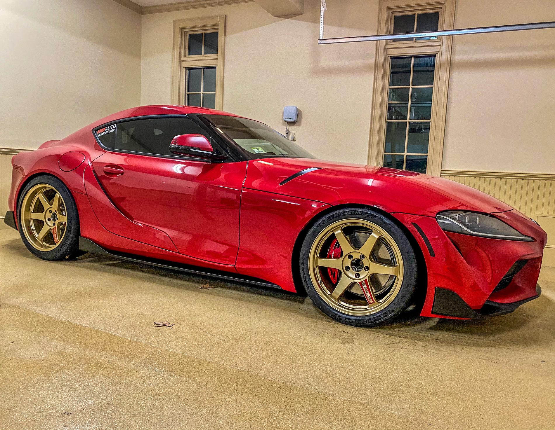

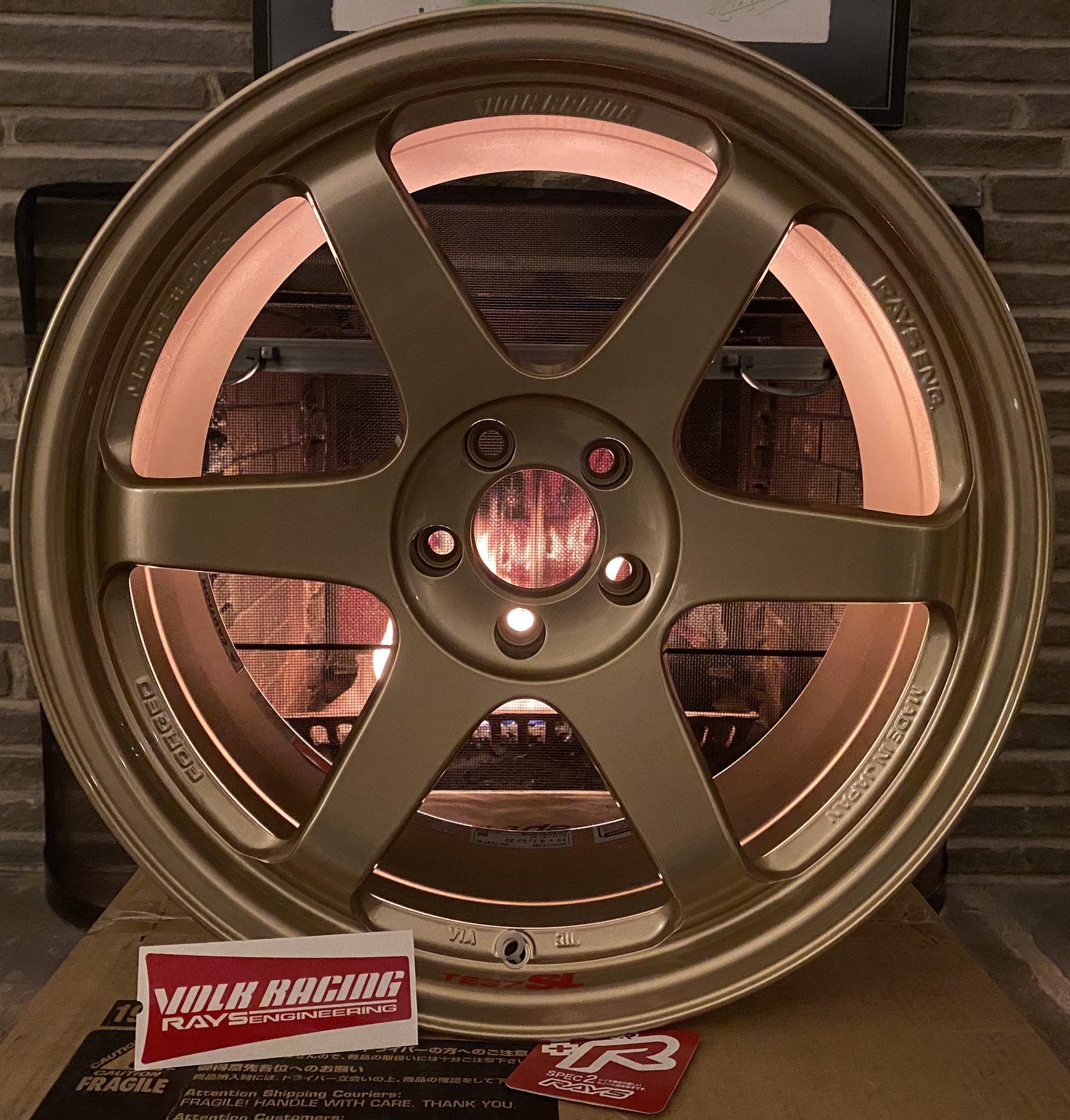

You guys get the first look.
Volk Racing TE37SL In Gold
Michelin Sport Cup 2
Front: 265X35x19
Rear: 295X35x19
Your stock 19x10" wheels are +40 offset right? Thats really high.
So we would need a lower offset to push the wheel in the front away from the strut area? +35 may work. I am thinking a +30 to +27 would be good. I don't want to have to run -4 camber like on my Hondas to fit wider wheels. hahaha
I don't like how the 9.5 doesn't look concave and smaller lip.
