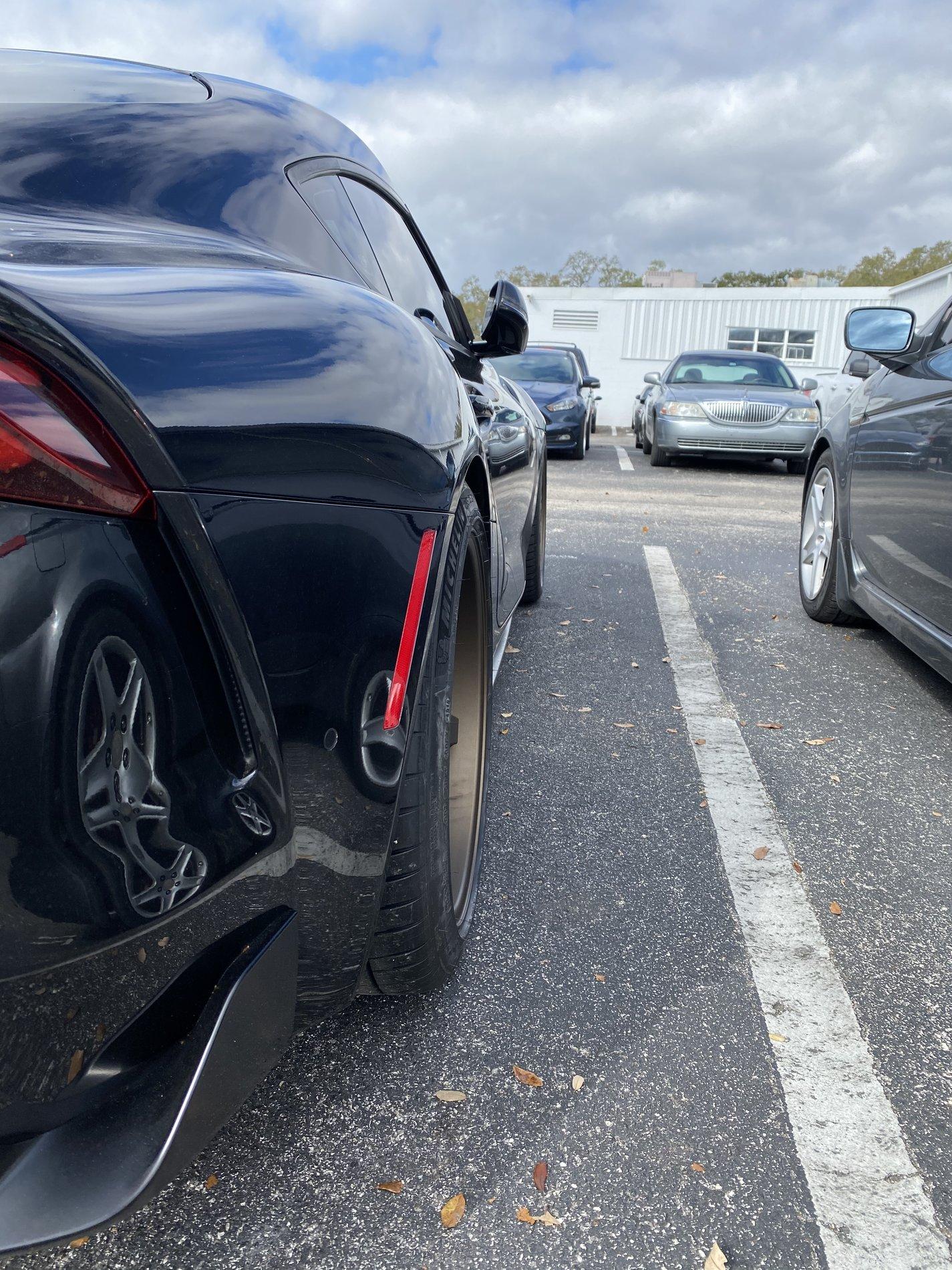

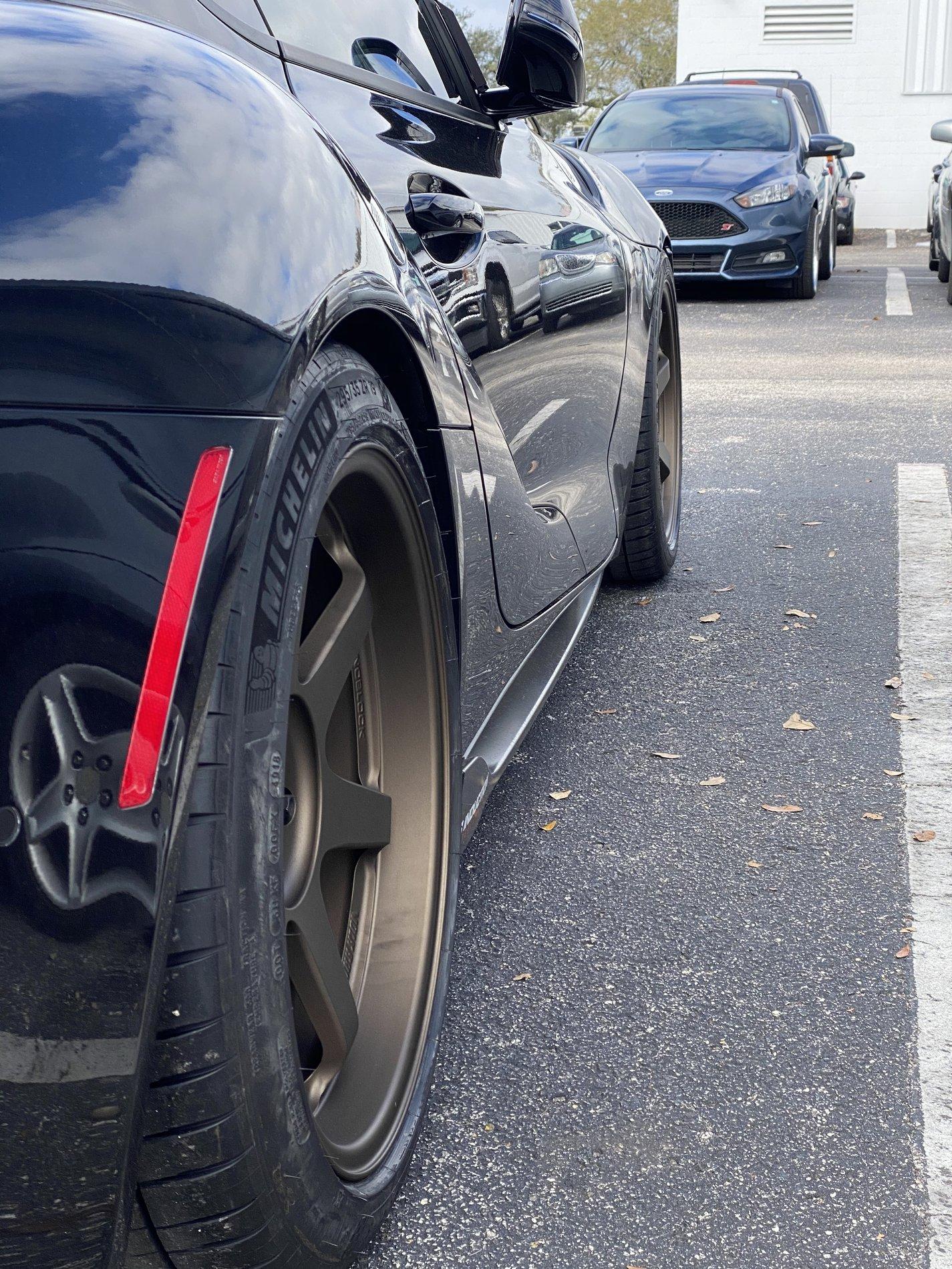

Volk Racing TE37SL In Gold
Michelin Sport Cup 2
Front: 265X35x19
Rear: 295X35x19

Your stock 19x10" wheels are +40 offset right? Thats really high.
So we would need a lower offset to push the wheel in the front away from the strut area? +35 may work. I am thinking a +30 to +27 would be good. I don't want to have to run -4 camber like on my Hondas to fit wider wheels. hahaha
I don't like how the 9.5 doesn't look concave and smaller lip.
Yes they are +40. I am running a 13 mm spacer so thats +27 in the front to clear the strut, and I have - 3 front camber to to clear the fenders.

TreyE

Rays recommends a 285 rear. So if you want to go by recommendation I would stick with that. The OEM tires will fit as well for those that don't want to buy new tires right off the bat.

Am I misunderstanding or are you saying that the supra specific spec requires a spacer to not hit the strut? I’m gonna be bummed if I just ordered wheels that require a spacer lol.
I’m running 295/35 on my rear and 265/35 on fronts. No running no spacers. Fitment is perfect

looks great! Same colors as mine, have any more photos around the forum? Hard to find this combo! Also looks like we could easily fit a 305 in the rear!
Are you on coils or springs?
H&R springs.
