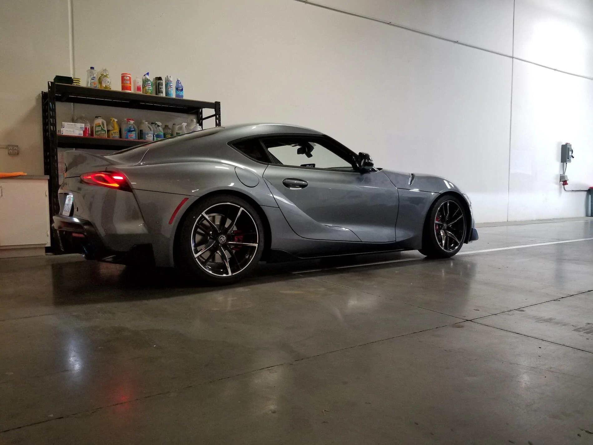

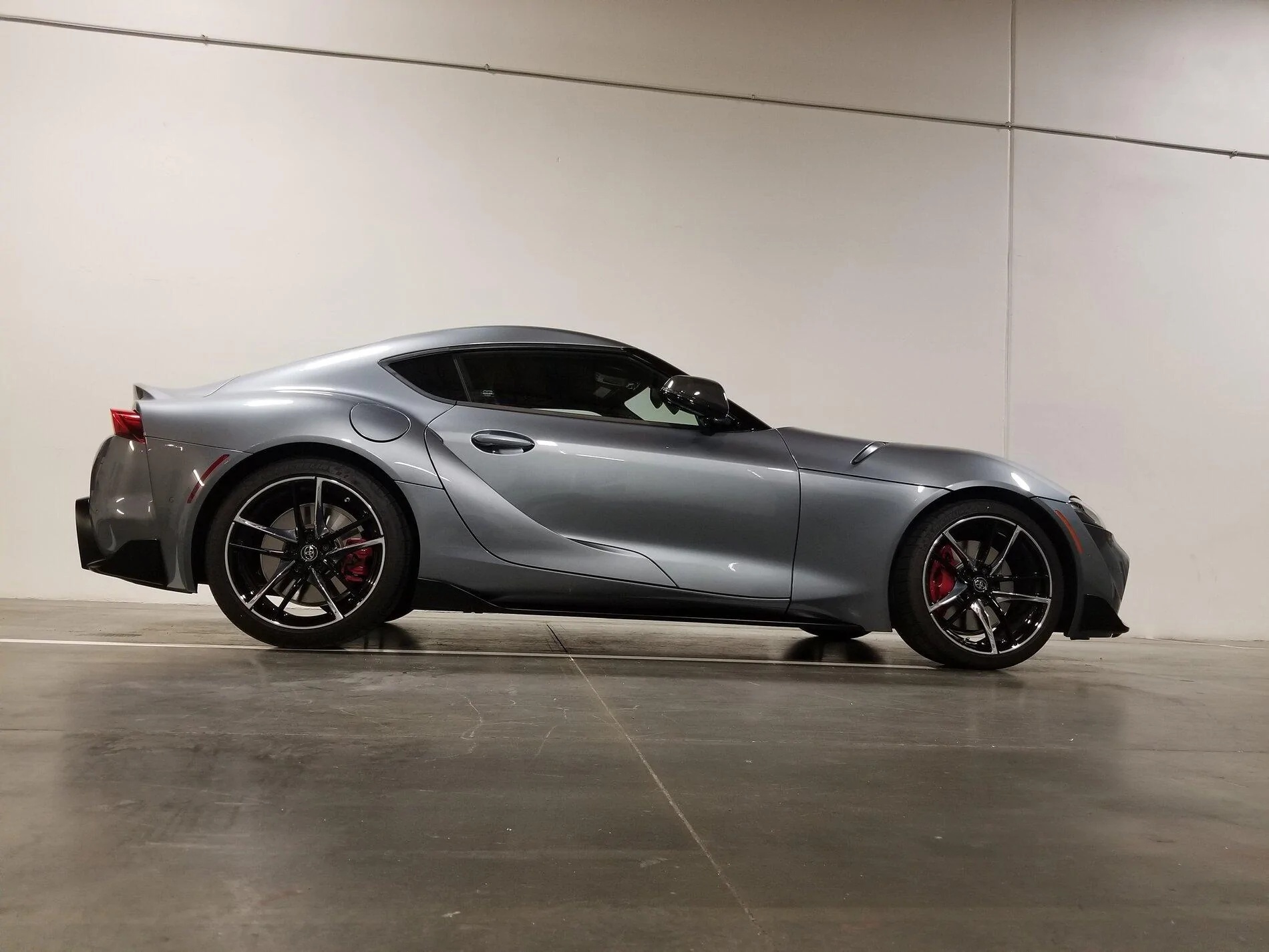

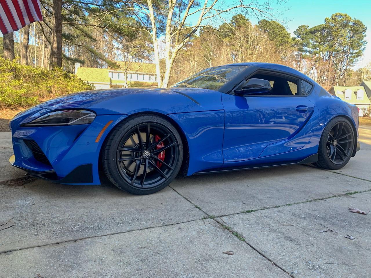

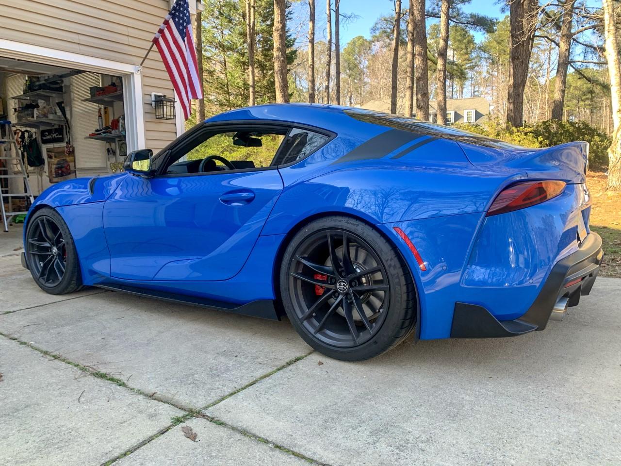

I have seen a lot of people doing the Eibach, H&R, and HKS springs but I have always been a fan of Tein's products. I have had their springs/coilovers on my 97 Supra, Evo 8 and 9, my wife's WRX, and various other cars so I decided I wanted to give the S Techs a shot. I watched this video to give me any tips and tricks before the install and, if you are familiar with doing suspension work, it was pretty straight forward.
The pics are after it settling over about 2 weeks and 150 miles worth of driving. The car feels good. No excessive bouncing. No noises since they do come with the spring silencers installed on the springs. They lowered the car pretty close to what they advertised, 1.2" in the front and 1" in the rear. The car also has BMS 13mm front and 15mm rear spacers on it. I have had two times over harsh bumps where one of the rear tires has touched a little. It was only with a passenger in the vehicle and I can't tell where it is rubbing since there are no marks, etc. so I am not very concerned with it. I just figured I would share some info and pics since not a lot of people are talking about this option. In a few weeks I will have the alignment done and share that info with you all as well.

Being mostly a street driven car, my settings will be pretty basic. Toe as close to zero as possible. Camber as close to -1.5 as possible. The front doesn't have much in regards to camber adjustment so we will see what it ends up at. I am hoping to get some front camber plates to adjust front camber. I saw Verus made some but it looks like they only add the ability to add more negative camber not add in positive.

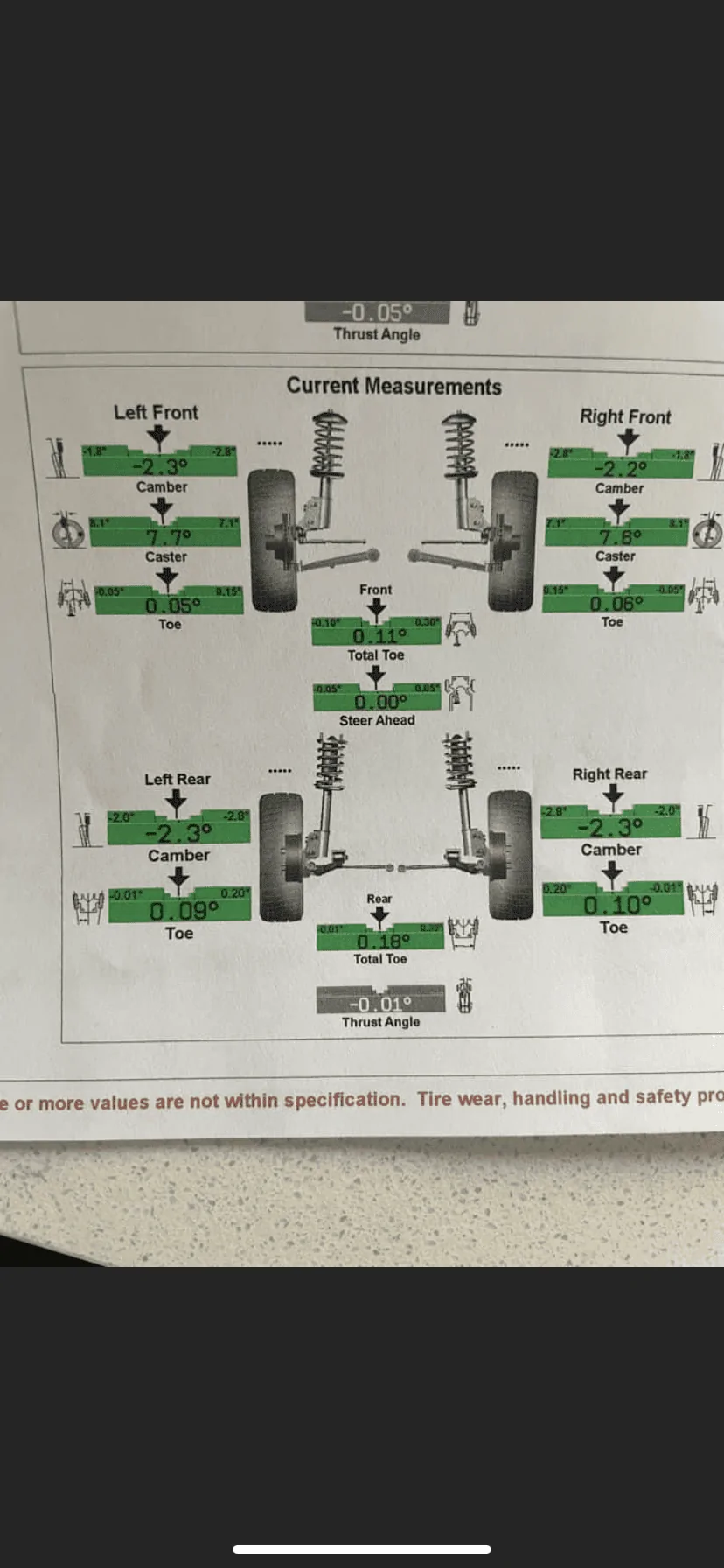

Thank you I have just purchased the springs and will throw on some spacers whilst I'm at it. In terms of alignment will I load normal supra factory alignment settings ?

I am going to shoot for something like this. Camber isn’t adjustable in the front so not much you can do there with the factory equipment.

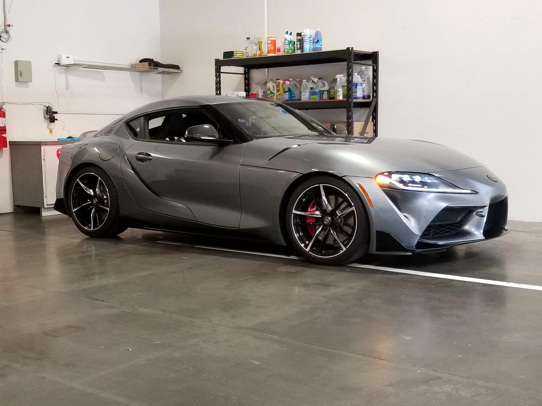

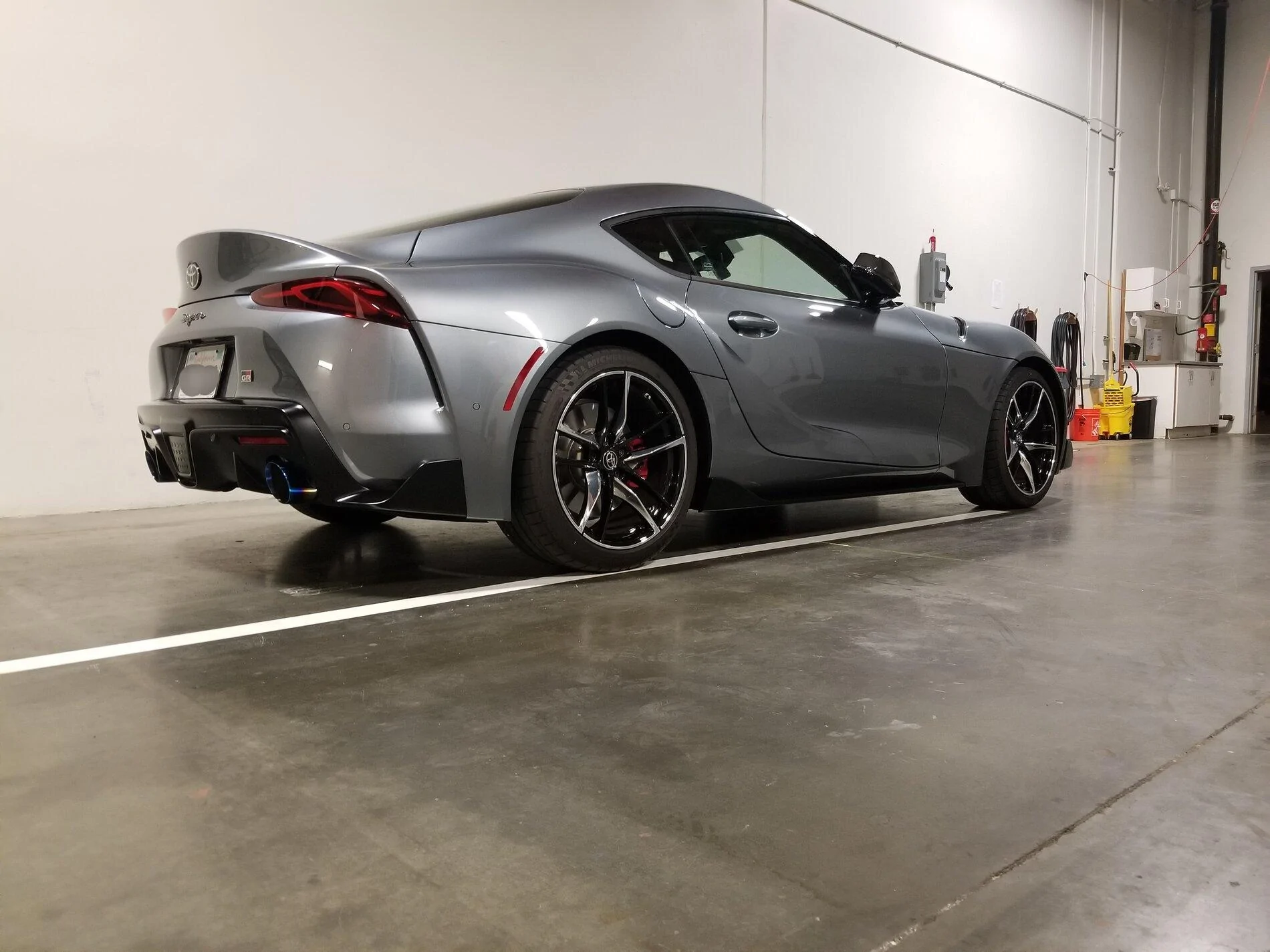

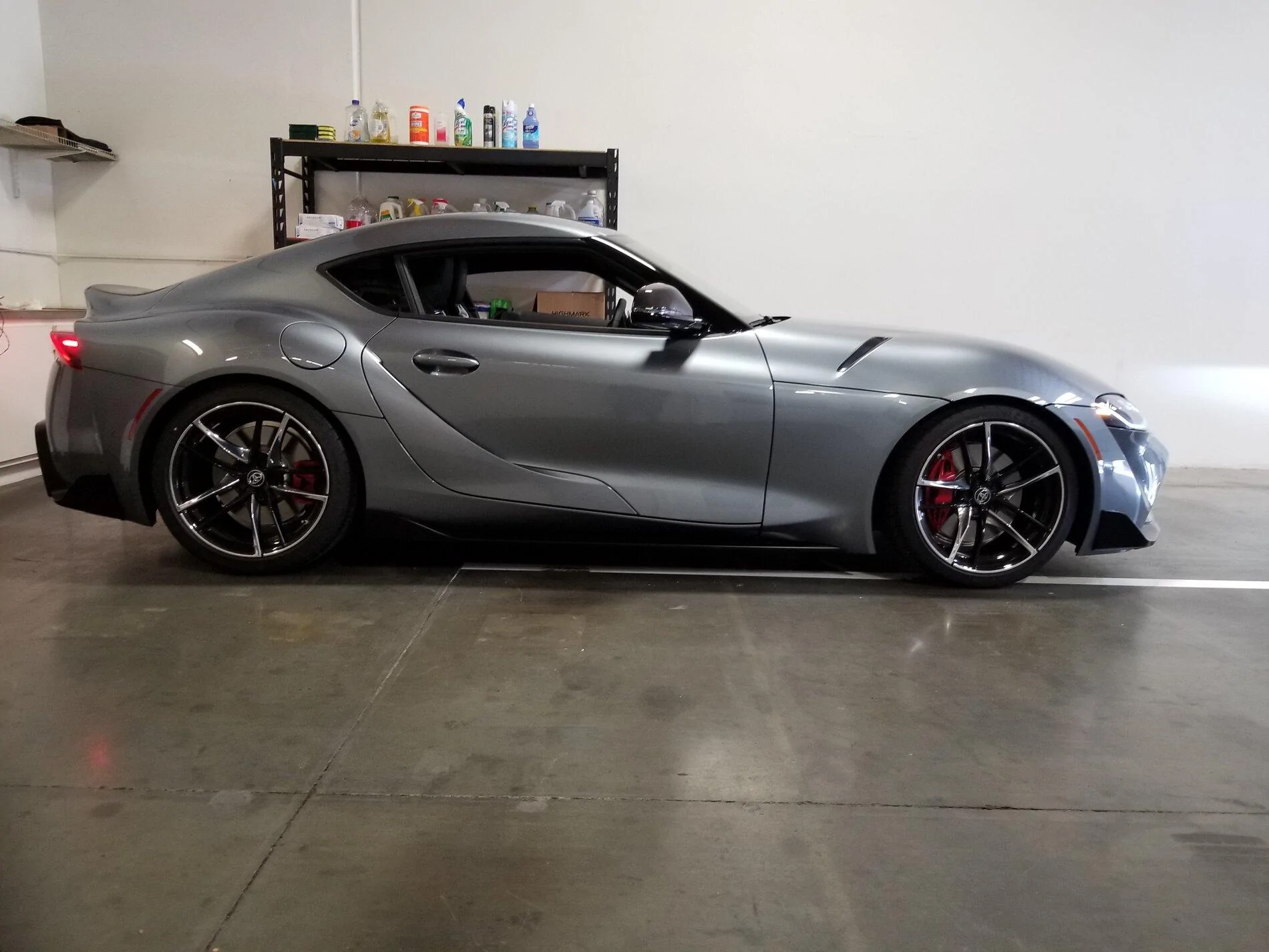

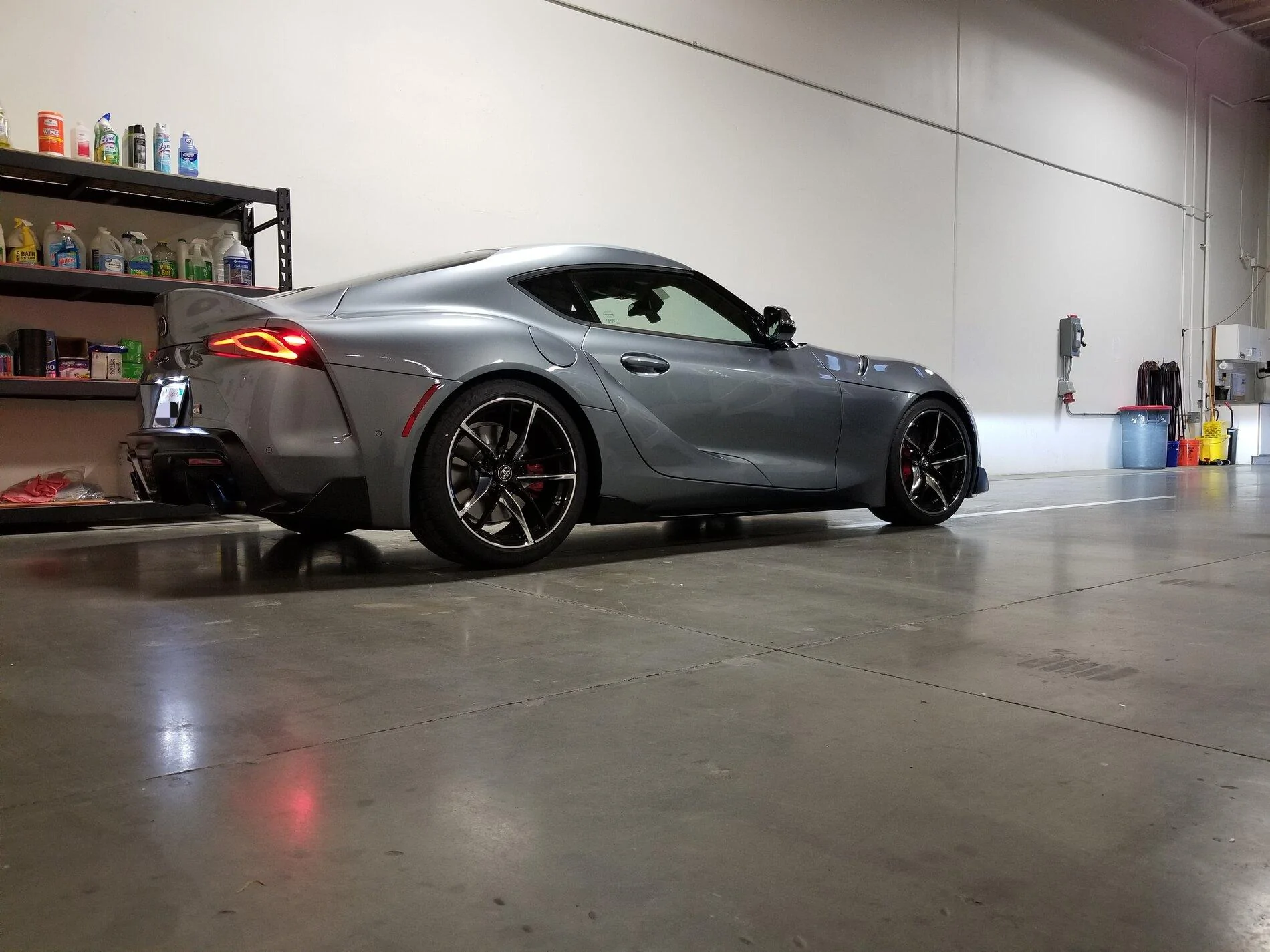

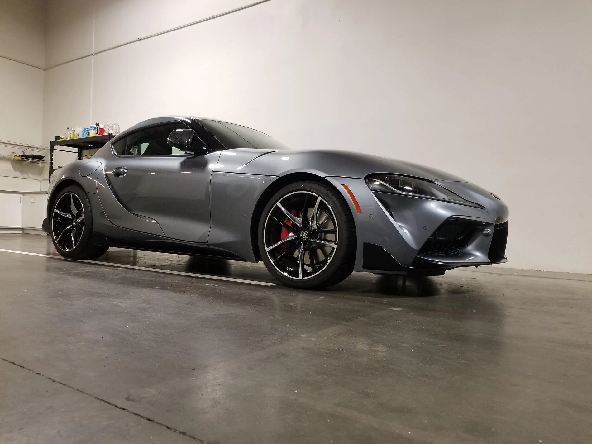

I had my S Tech Springs put in last week.
Car does ride great. You can tell the difference between Sport and comfort mode.
The the car is manageable, planted in sport mode which is default for me when I drive.
And smooth and controlled in Comfort mode. Looks like Tein did an excellent job developing the Springs with the factory shocks.
In my opinion, the drop is probably where it should have been from the factory.
AFTER>
BEFORE >
