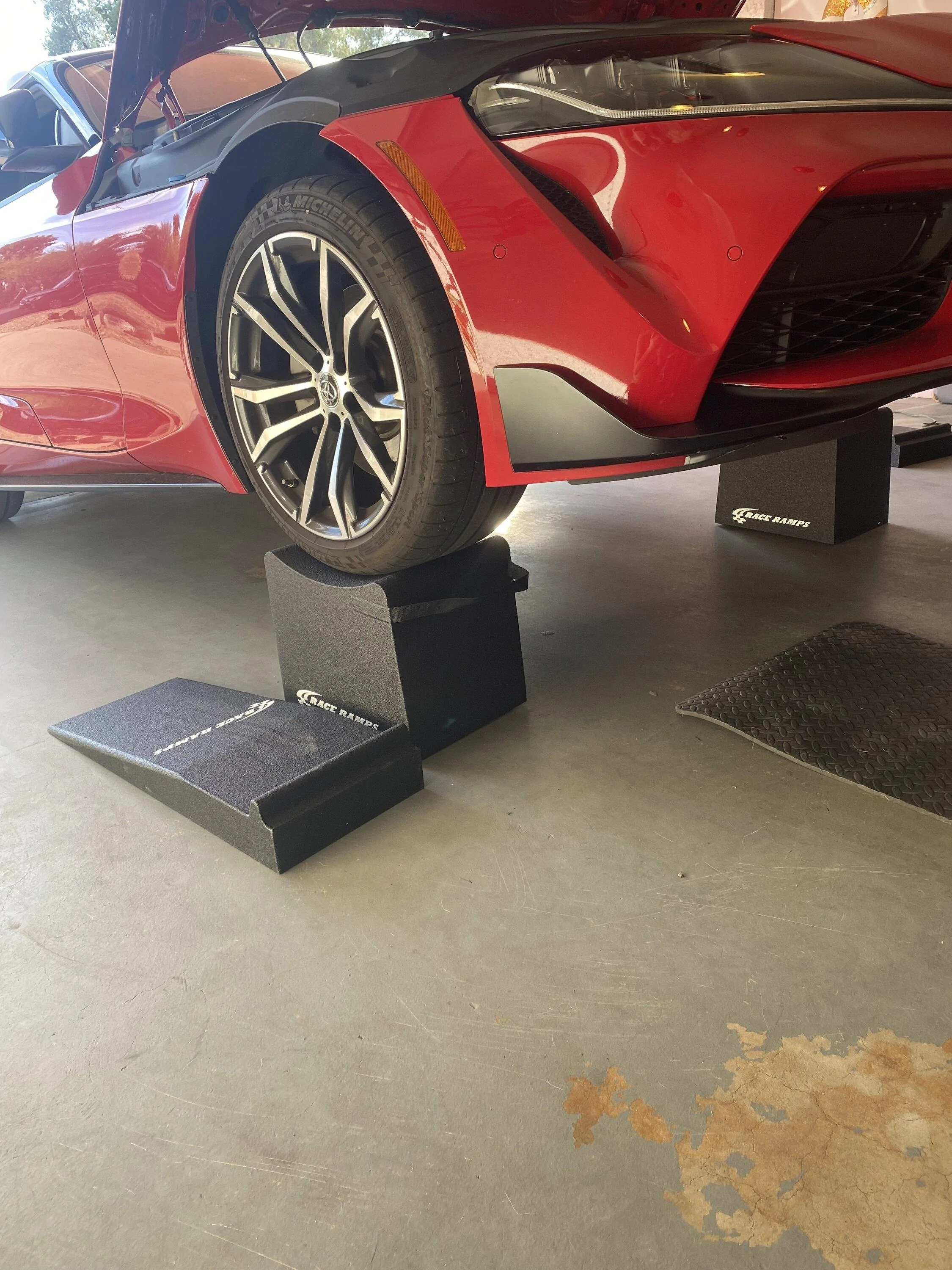

Hi Everyone. I did my first oil change on the 2.0 today (dealer did several previously). Here are a few tips/things I learned:
1. The oil filter housing takes a 27mm socket, NOT the the 32mm for the 3.0.
2. To find the front center jacking point more easily, I used 3" high Race Ramps to see better under the car (see pic)
3. After jacking the car up w/ a 3 ton Harbor Freight Daytona low profile/extended reach floor jack, I used 12" Wheel Cribs by Race Ramps (see pic). They lifted the car very high off the ground.
4. I could not the get the drain plug off with a normal sized ratchet with the 17mm socket. I had to buy a breaker ratchet and this made it very easy.

Be very careful and do not over tighten the drain plug. Also, it may not be a huge deal but you aren’t getting all the old oil out if the car is that significantly nose up. Not sure how much it amounts to be some old oil will pool behind the drain plug at such a significant angle. It may not enough to be a big deal but something to think about.

May be a tip, may not be. I truly do not know how the oil pan and drain plug location are on the 4 cyl, but raising the car level is better in terms of drainage for the 6 cyl instead of only the front.
Apologies if this comment is truly pointless.

For the 2.0 get the fcp euro kit for the BMW Z4 2.0 sDrive30i. Everything you need is in that kit.
It comes with 6 liters, but you only need to use 5. My first oil change, I measured how much came out. And it was about the same as the 5 liter jug.
Torque specs for the filter cap and drain plug is 18 ft-lbs.
Having the nose up that high, oil will pool up towards the back of the oil pan.
https://www.fcpeuro.com/products/bmw-oil-change-kit-5w-30-liqui-moly-11428575211-lm
Hope this helps.
