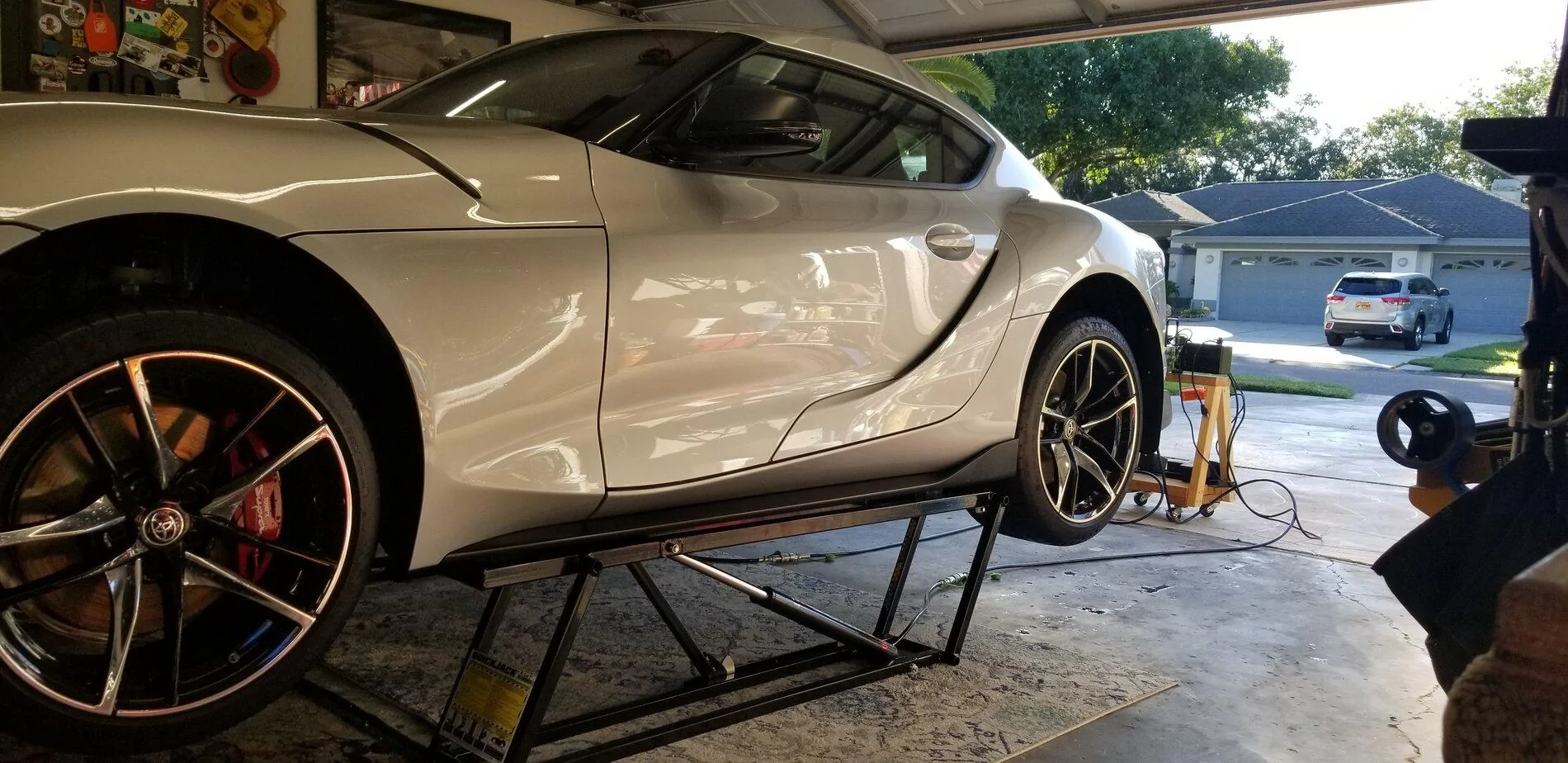

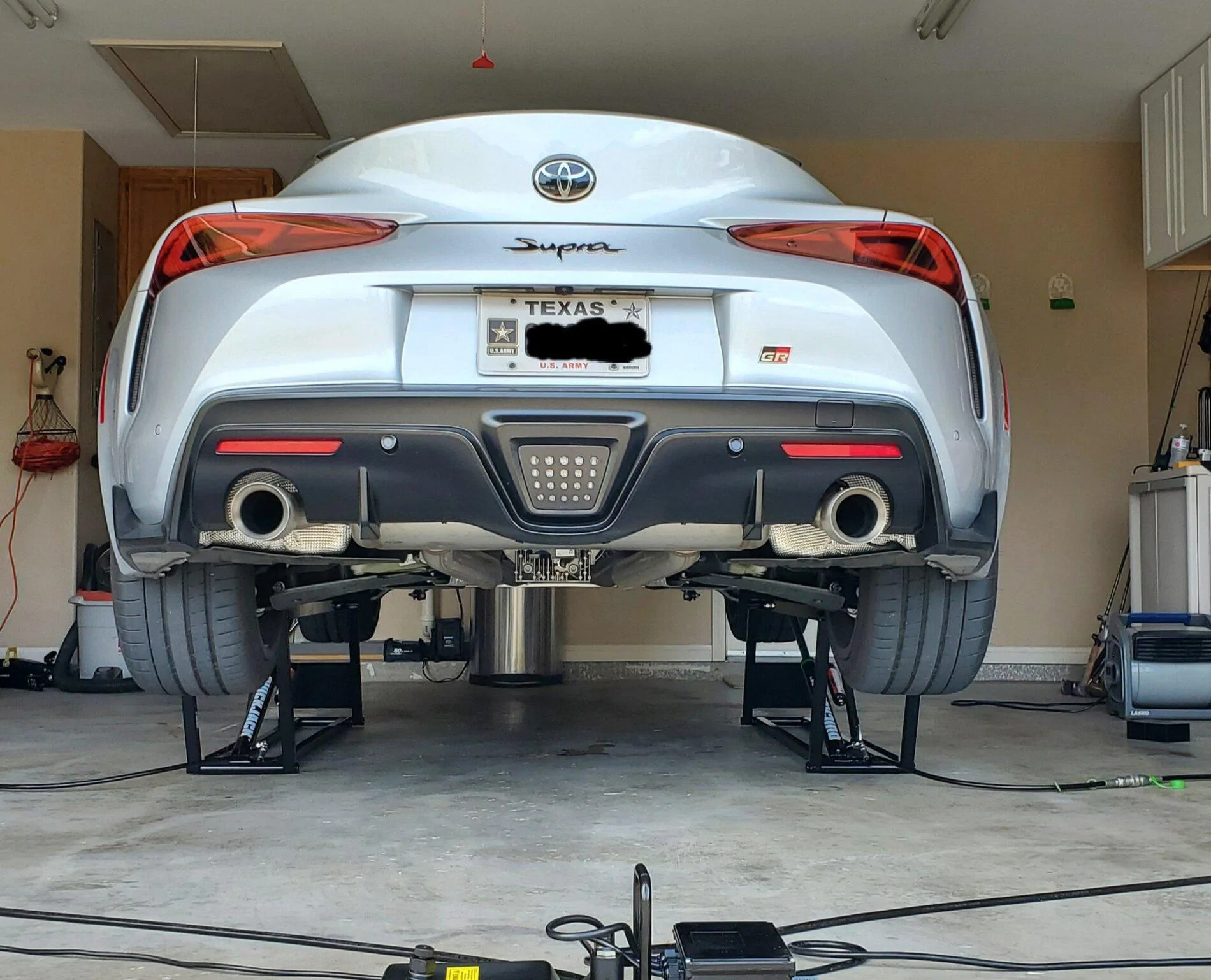

5000 lb model.... Love this jack! Lifts my Highlander as well....
I would strongly encourage everyone to pony up just a little more cash and get the 7000 lb package. It includes wall hangers and a truck extension kit. Even if you don't currently have a vehicle exceeding 5000 lbs you might at some point. The 7000 unit works just fine on the Supra and my dd Malibu too. My wife and daughter both have F150s. The 7000 model will lift all of our vehicles. You can often find good package deals at home depot and Costco.
