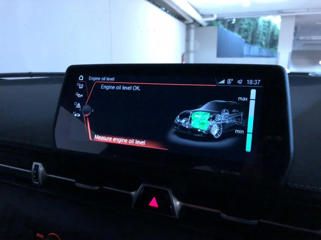

The temperature is often 98F where i live, and Toyota still recommends the 0W-20 oil for our Supras. I have noticed some oil consumption post the first 1000km oil svc. According to the onboard oil measurement - half a liter after 1700mi. But I can’t know for sure how much oil they put in on that svc versus factory fill.
Are you still on factory fill? Would be interesting to hear if you have noticed oil consumption for the OEM spec oil. Perhaps you can give the BMW TPT 5W-30 LL-04 a shot, if you’d like to try something heavier. The B58 should be OK on that - slightly heavier but still low SAPS.

i had a free oil change with the dealer at 1000km, and they filled up with the OEM 0W-20 oil. After 2600km, I’m half a liter down according to the onboard measurement. Not too worried, cos it’s a BMW engine and a thin oil. But I’ll be monitoring it after the next svc. Will consider the LL-04 route when I’m done with the free svc package.
I’ve had no low oil warnings as yet.
