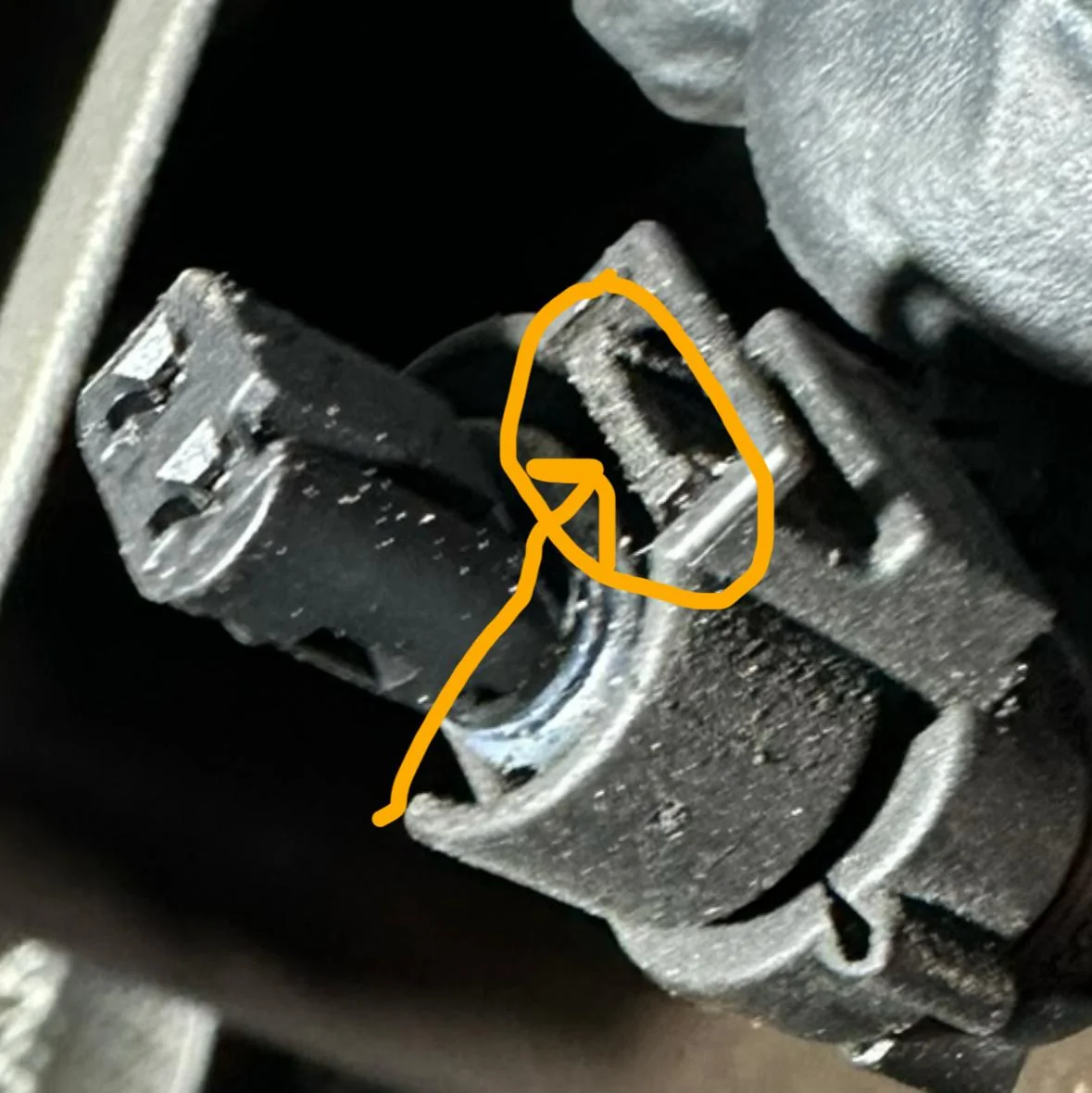

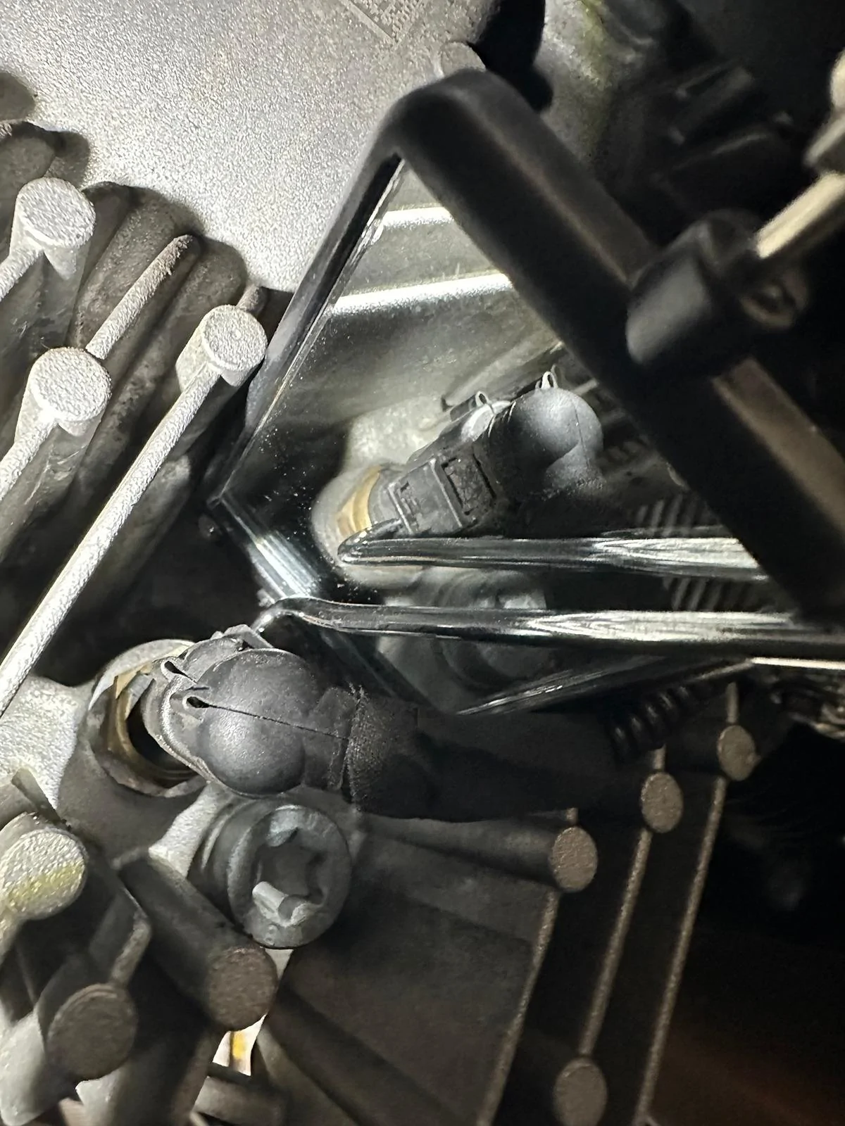

That’s all you need to know. It’s super simple. Unplugging the sensor and filling up the diff is the only difficult part about this.
And taking off the weight so you can get to the fill plug.
For the sensor clip, use a pick and pop this tab up. It's a bit tricky since it's facing the diff.

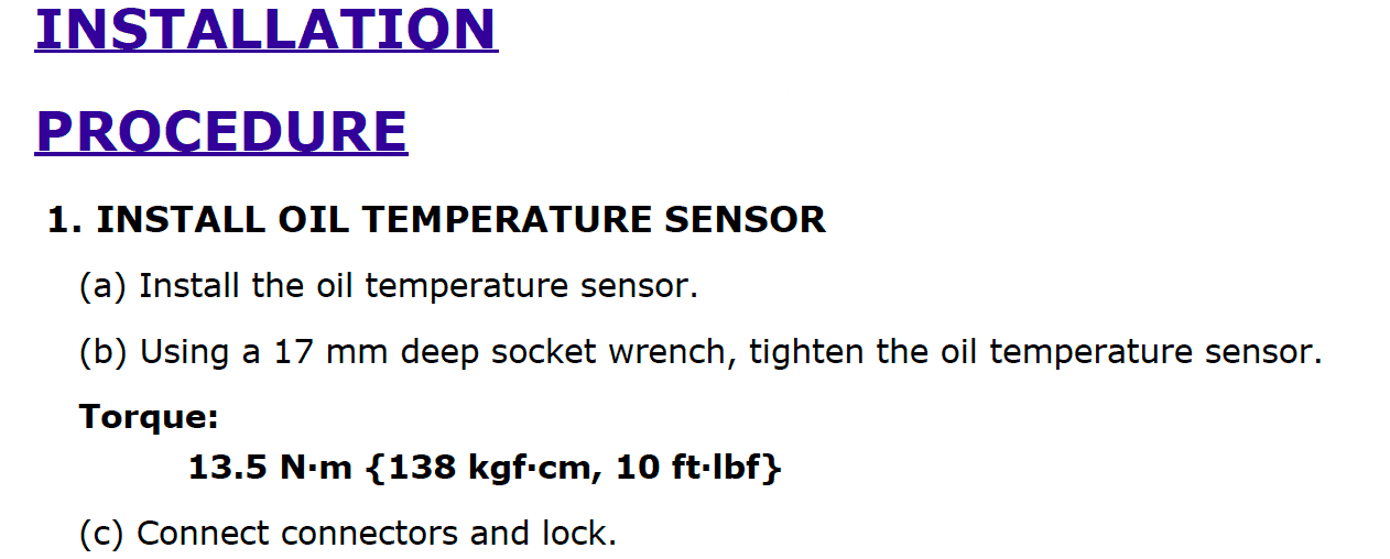

Yup. 10 ft/lb. Basically a little more than hand tight.
The replacement O-Ring is only for the fill plug correct, the temp sensor is reinstalled without a new o-ring?
P/N for the new drain plug with O-Ring I believe is: 90118-WA263
8,806
17,275
Yea the temp sensor has a captive washer and I believe is only 10ft/lb tight
Rear diff plug
Toyota: 90118-WA263
BMW: 33117525064
