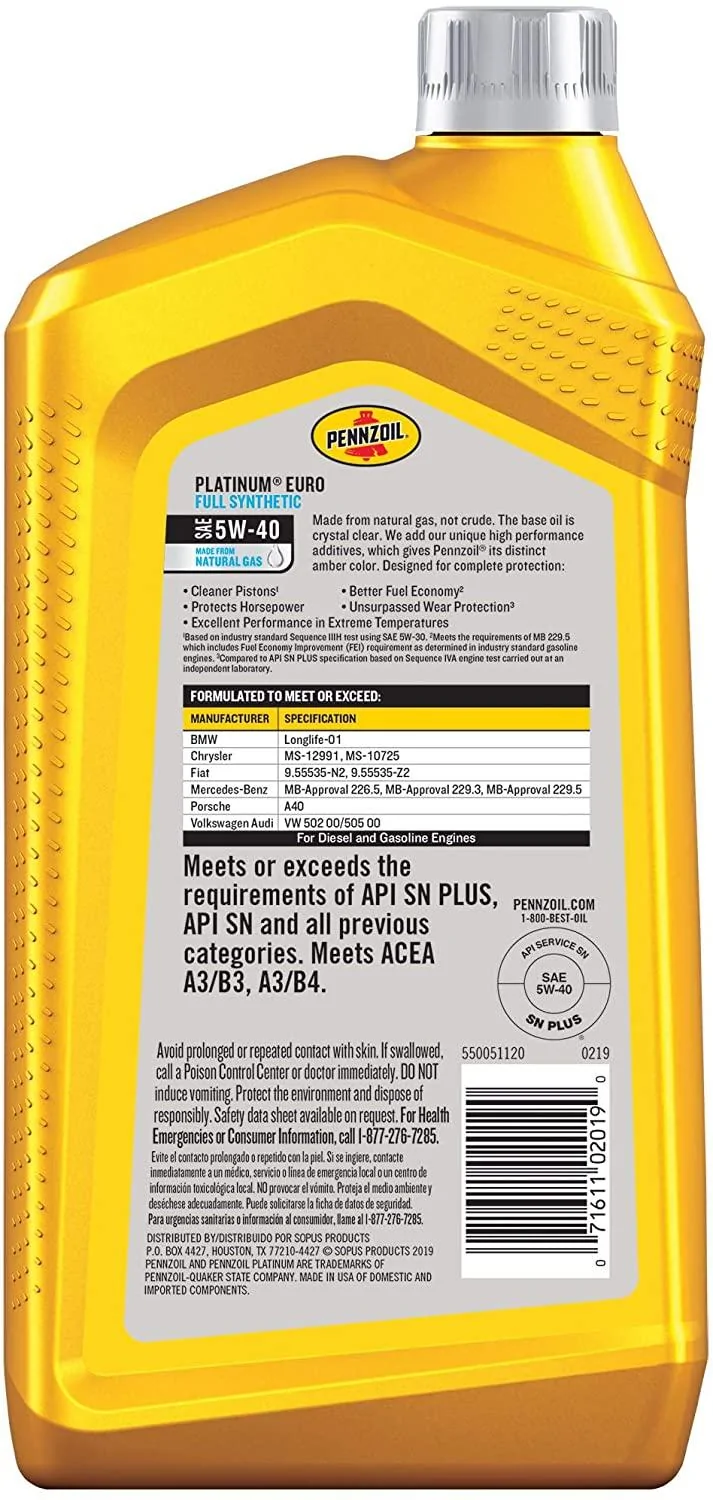

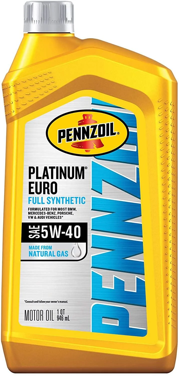

Ordered A91 edition Supra
Cool. I see a Platinum Euro, but no Ultra Platinum Euro? Are you using the Platinum Euro?
Yup. That's it. I don't think they make an ultra version. Or maybe they ran out of room on the label lol.
wfujay
Oct 26, 2020
138
90
NC
2020 Supra Launch Edition #1455
Did some more digging and found out it's just rebadged Shell Helix Ultra oil, which is a very good GTL based oil. Yep, pulling the trigger for sure now. Where do you buy yours from?

Ignore latest post. We should be using the LL01 approved oil in our engines and not LL04. Apparently LL04 is suitable for diesel and gasoline BMW engines in Europe, but here in the US the sulphur content in our gas is higher and the non L branded Euro spec or LL01 is recommended and not LL04.

Since I know relatively jack about oil requirements and specs, how important is the ACEA spec of A3 vs our C5?
wfujay
Oct 26, 2020
138
90
NC
Thank you for this.
Good question, but from what I can gather here, it's just fuel economy standards for low viscosity oils, which really shouldn't be used in our cars if you care about actual engine protection.
https://www.oilspecifications.org/articles/acea-good-bye-a1-b1-welcome-c5.php
ACEA C5 introduced
With engine and motor oil development during recent years there was a need for an aftertreatment compatible specification that covers the new 0W20 and 5W20 oils. These oils typically have HTHS viscosites below 2.9 mPa*s so the C1 - C4 categories were unsuitable. C5 requires a mid-SAPS oil - since it has the same SAPS limits as C2 and C3 - but a HTHS viscosity between 2.6 and 2.9 mPa*s. Fuel economy-wise C5 demands 2% better fuel economy than C3.

Ah, ok. That makes sense. Thank you.
I did a bit of digging and looked into epa reports. It states : "The program sets new vehicle emissions standards and lowers the sulfur content of gasoline to a maximum of 10ppm beginning in 2017". That should be on par with Europe. I'm not entirely sure but it looks like we could use LL-04 now, unless there are other factors. I wasted way too much time on this tbh.
This is another thread discussing the matter : https://bobistheoilguy.com/forums/threads/bmw-b58-engine-oil-recommendation.337089/page-3
wfujay
Oct 26, 2020
138
90
NC
Cool. Either oil type is fine I'm sure. I'll stick with LL-01 as peace of mind since I can't physically measure sulfur content myself.
I feel you. I ended up getting Castrol EDGE Euro 0W-30 A3/B4. It was LL01 approved until 2018 when BMW removed 0w oils LL01 certifications. Their 5w-30 euro is still LL01 approved.
